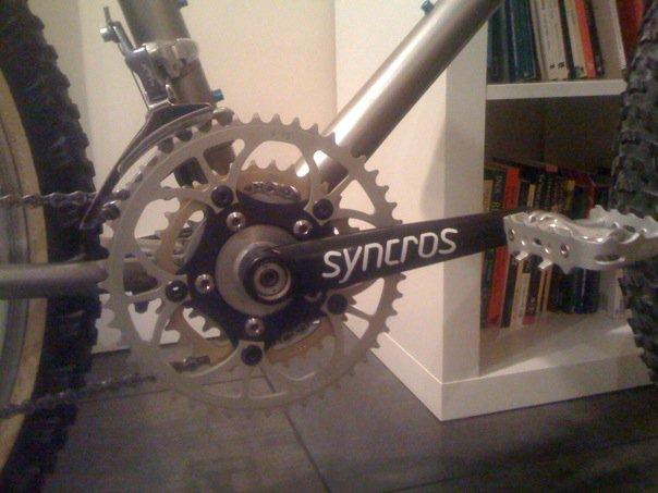

Today I got the cranks through and gave them a good clean up and fitted new decals- turned out quite nice!. Sorry for the rubbish pic but its dark out and i only have my phone camera.
Just the canti studs to fit to the fork. Turns out they were 5/16UNC- 18TPI. Got a pair on the way from Germany now.
Big thanks to Jezza for the cranks :wink: :wink:
