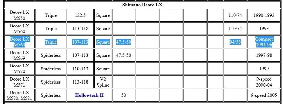

73x110 BB with 48/38/28 hits the chain stay, 28 is bent in when put on crankset.
I know they are 42/32/22, but is my BB the correct length, could someone measure it, no specs anywhere show what the BB length should be, maybe its 118.
Sheldon Brown website is where I got the length from, I will double check. Yeah. Guess I am buying 42/32/22, good news is its only $5 for used gears, I will just buy a whole crankset 42/32/22 for $5.

I'm in the process of building up a '93 stumpy and have the same cranks and am putting a 73 x 110 BB on as the spec from sheldon browns website says 107 to 113 spindle length so thought i'd try the middle first :)

The proper BB for this bike is most likely 73 x 113, then the FD would most likely work properly.
