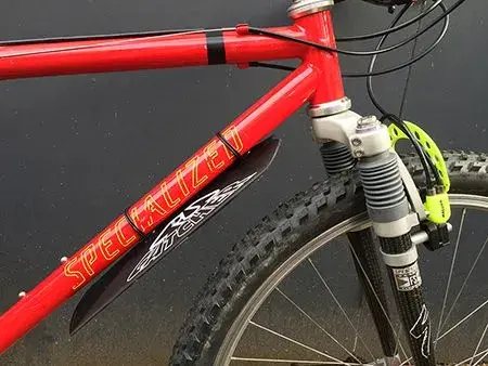

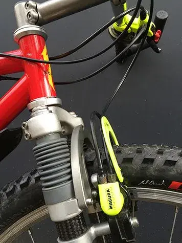

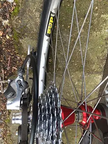

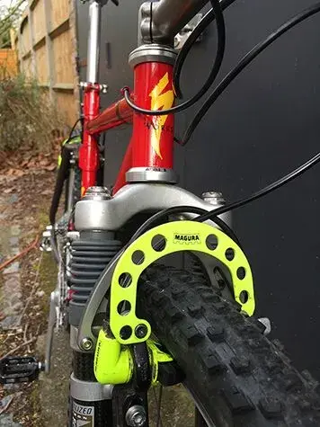

S-WORKS
More Pics
some more...

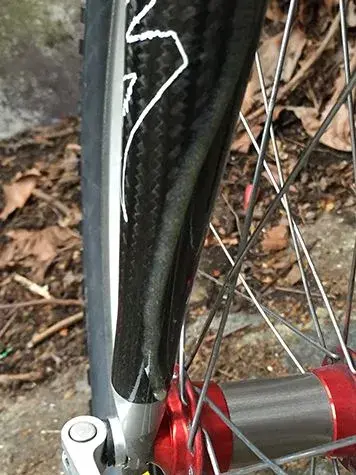

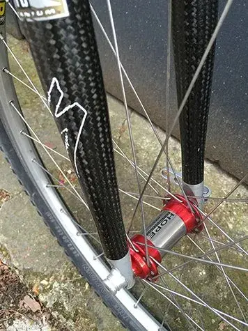

Last night I tested the forks by putting all my weight o them. I think I blew the seal. I gad them fixed recently but I think they are dead now. have not ridden them. see last pics

Re: Forks seal burst
Looks pretty bad
Jep, that seal is blown. Someone forgot to put in the securing snap ring in and the seal slid out?
This is the pic of my "overhaul". Its that big snap ring to the right:
Slide the rubber upwards and have a look between the stanchion and the slider tubes and check, whether its there. Maybe it was not put in correctly?
Should look like this, if put in correctly:
Don't worry too much. It will be repairable. And its not too complicated either.

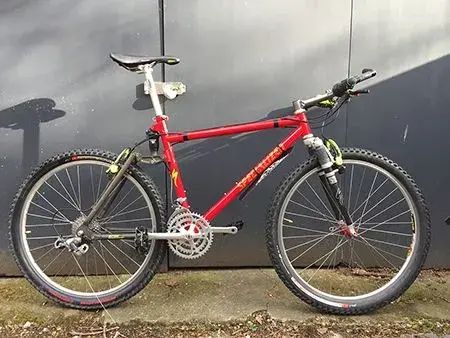

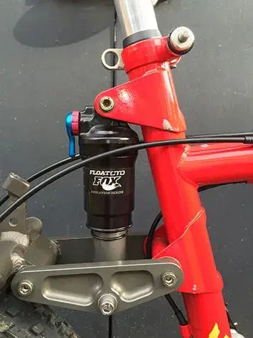

Your FSR is fantastic! I like it very much. How long it that Fox shock? People alway tell me, mine might be a tad too long. And it looks to be as long as yours.
