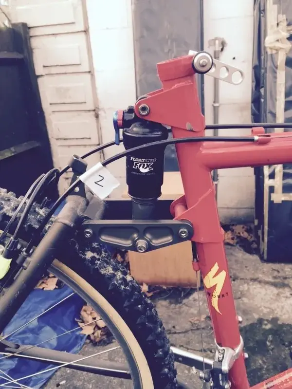

Still curiuos about the rear shock, did they shorten a modern shock to fit the frame?
Jamis Diablo":1tn7t8en said:
Very very nice bike! I'd love to have one some day.
Hi
Thanks yes she's gonna look great when I have finished..
I believe this is a normal shock that they make. I sent in the old one and they made sure it was suitable when compared and sent me this one

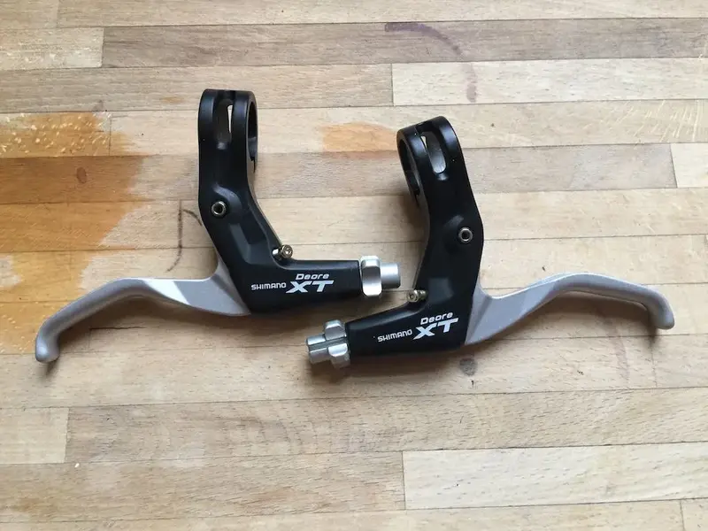

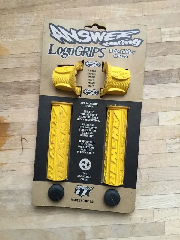

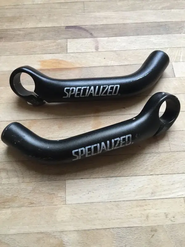

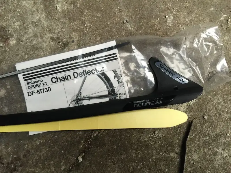

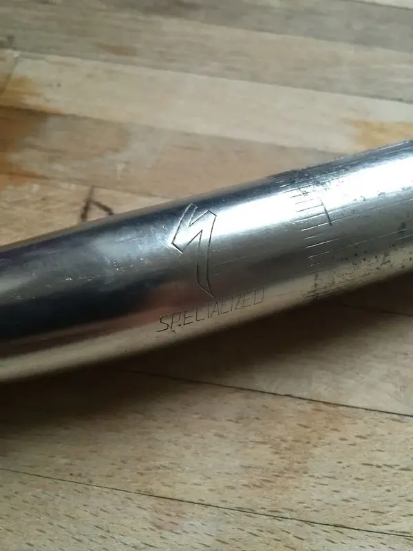

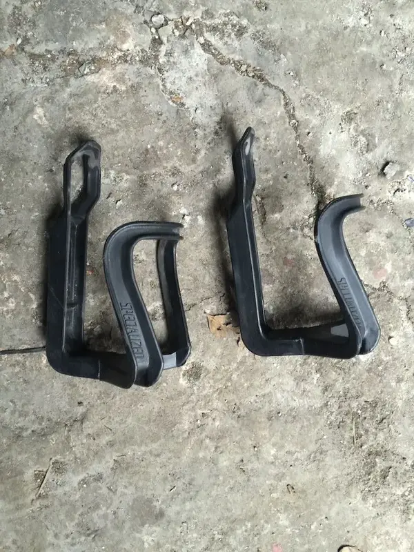

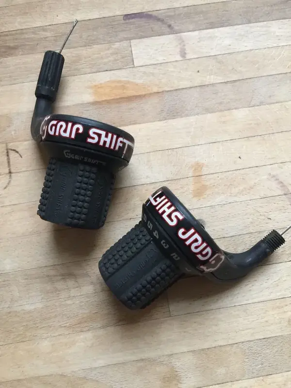

Things are coming together and arriving in the post...
Looking for a NOS XT 8 Speed cassette if anyone has one..
markpattenden":2yhlqumk said:
Seneb":2yhlqumk said:
Where did you find the Fox Float with the right length? My Alps when mounted measures 133mm eye-to-eye.
I had the rear shock changed to a Fox float by http://www.mojo.co.uk/
Looks like a 140mm shock is being used here. I have 4x 94/95 FSR frames. My '94 is my only 'small' and it has a 133mm Risse shock which was specced by its original owner. The other two I have with shocks still have the original Fox Alps 4Rs, and are medium or large '95 S-Works models. Both those shocks are 140mm.
Maybe the shock was shorter on the small size and/or for '94? I wasn't aware of this being the case, as I thought the rear end was the same for all sizes from small to large, with XL having a taller back end. I thought my Risse shock had been specced too short, but reading this perhaps not.
Anyone else - especially those with original shocks - shed any light?
