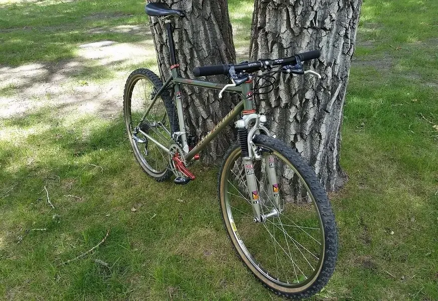

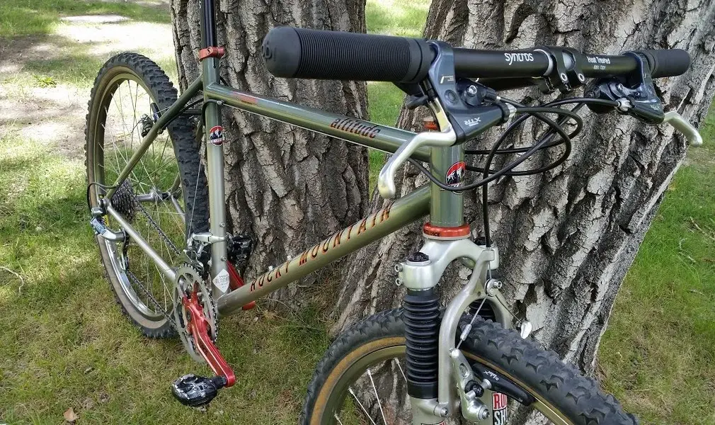

Well, this one took longer than I planned, but I finally finished it and got it out for it's 1st ride. So far, I'm really happy how it turned out! :D
I ended up going with some Mavic 230 TiB rims since I found them to match better than the silver 231 rims. But I still kept with the XTR m900 theme and all the RF and Syncros parts to keep it close to original spec.
