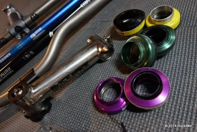

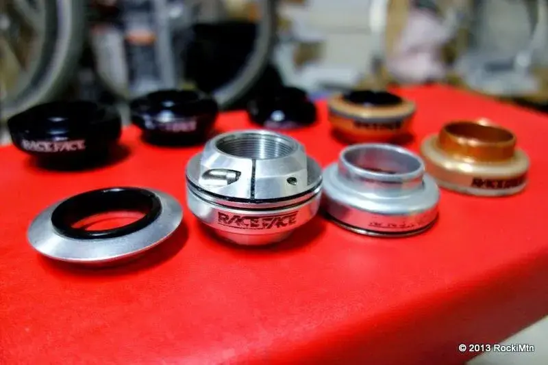

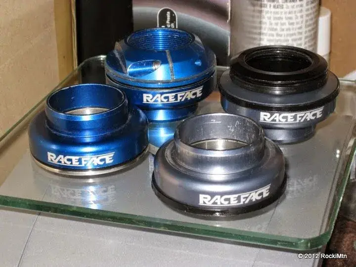

The Real Seal headsets I've pictured below with interchangeable threadless or threaded top race is the one and only headset that was branded as a Real Seal (according to the catalogues i've seen/scanned), there was no II model. And yes, I believe I've owned about all possible colours out there at one point or another (red not pictured but on a bike). ;)

They're technically the Real Seal II.
Read the 1994 catalogue, that's when they altered and released that design. I know later they dropped the II as no point in it.
My not 1993 one is as per the thread less, all black with black plastic T-rings. Like the silver/pewter/Ti one in the 1st picture, just noticed mine has the rubber ring like yours under the compression cap, so must be at least 1995 then.
But the thread part is a thin ~1cm thick with tapered and knurles edges and just screws down above the top of the theadless part. Then clamps with an Allen key.
Of course that ring could be off the Ti raceface stem, but it came as part of the headset and has the correct lips and hollows and thread. I've not seen the raceface stems with them to compare other than in some pictures.
