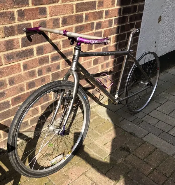

1994 Marin Pine Mountain Retro Resto Build Thread
Tricky1977

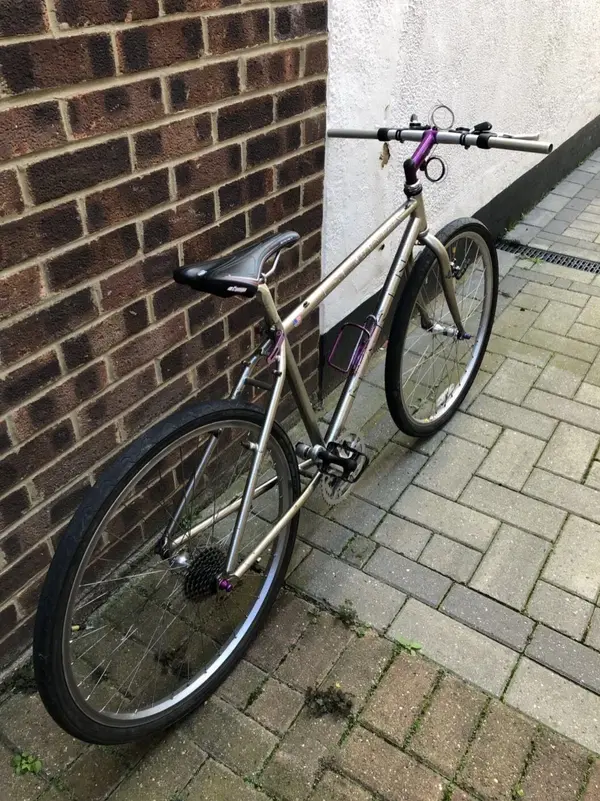

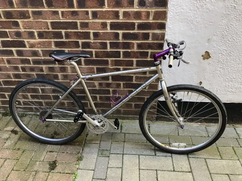

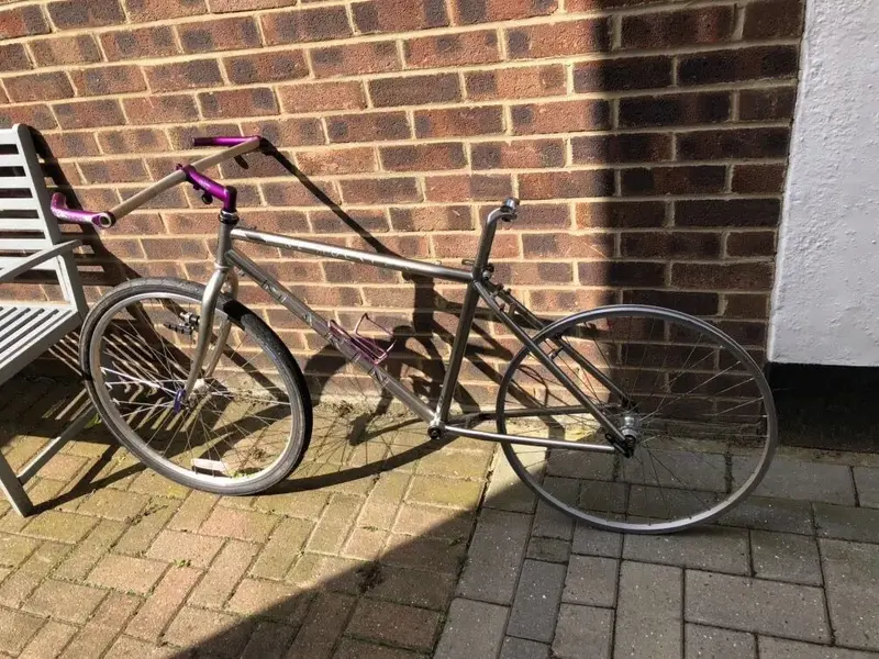

I picked up this lovely, if a little rusty Pine Mountain a good few months ago (for peanuts) and kept it in the garage. But as my other projects near completion, I need a new one.
So I plan to build this one up using, as best I can, period parts, but not catalogue correct (plus the slick tyres are likely to stay):
Spec so far:
Frame: Tange lightweight DB custom
Forks: Marin Rockstar
Saddle: Ritchey Comp (unknown year)
Seat post: 93 Marin Lite
Seat Clamp: Control Tech
Bars: Marin Ultra Lite
Stem: Marin Lite
Headset: Ritchey Logic
Bar ends: Onza L
BB: Shimano UN55
Pedals: DMR V12 (new)
Crankset: Deore DX MT60
Chain: KMC X8
Cassette: Shimano HG 7sp
Rear Mech: XT 7 spd (M735)
Front Mech: XTR triple
Brakes: 93 Alivio
Levers: Deore DX MT63 NOS 2 finger
Shifters: DX thumbies
Cables: Clark’s
Rear rim: ‘93 Araya VP20
Front rim: Weinmann Zac 19
Front Hub: Acera X M290
Rear Hub: ‘93 Exage
Skewers: Halo non QR purple
Tyres: Schwalbe City Jet
Pump: LifeLine performance (very good)
Edit:- bits I need:
- saddle maybe?
- replacement bar ends and bottle cage?

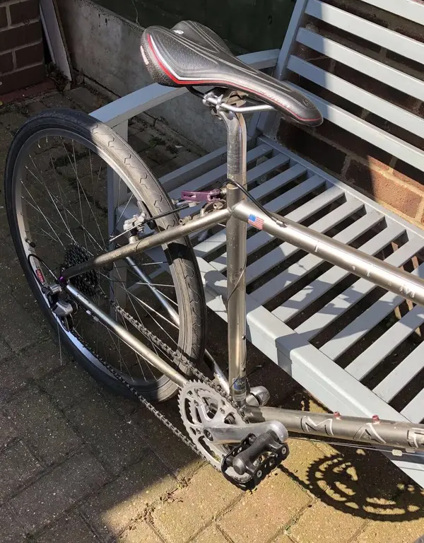

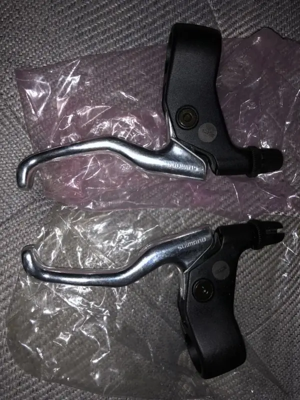

To go on:
Plus NOS DX brake levers and DX crankset incoming
Tricky1977
NOS DX Canti levers MT63
Not sure of the year?
Very pleased I went NOS

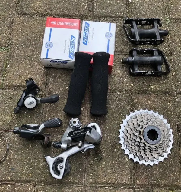

Quick update:
- New 122.5mm UN55 BB in (previous was too short)
- Deore DX Cranks (MT60?) polished
- Deore DX MT63 levers
- Deore DX thumbies fitted but not connected
- Tioga copy unbranded pedals
- Schwalbe City Jet all round
- Ritchey Comp saddle (looks nice but a bit new?)
- Trans X seat QR purple, very used
- Trans X rear QR skewer purple, new
Hope you all like it, it’s certainly taking shape.
Not weighed it since the cranks but was at 8kg, aiming for 10.5 which is around or just under catalogue weight (which would have come with STI and LX / XT mix).
Actually the 94 catalogue had no listed weights, 93 was 10.9kg and 95 10.5kg with quite a change of components such as Whyte and Titec rather than Marin Lite

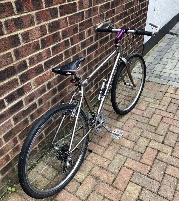

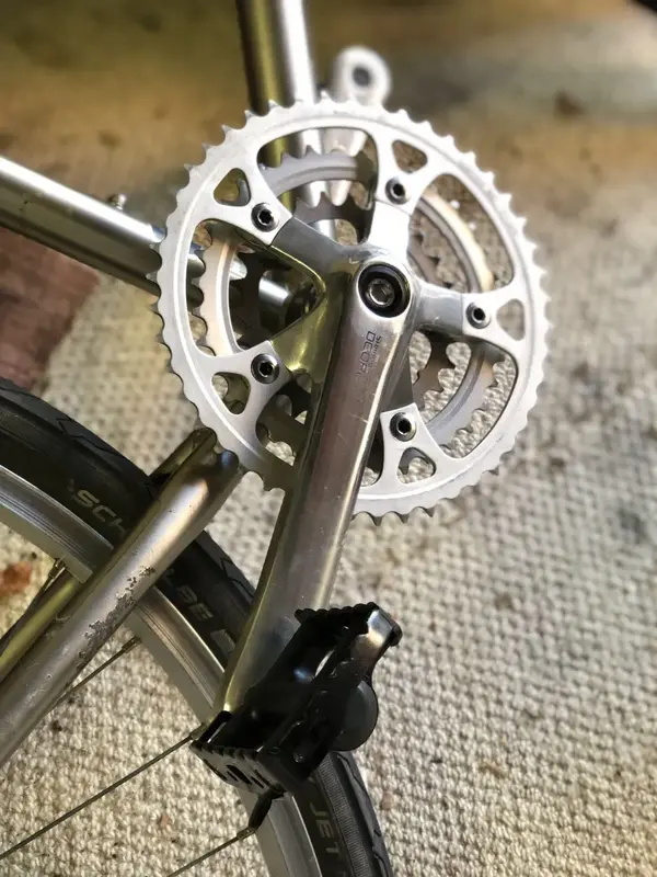

Tricky1977
Some gratuitous close ups

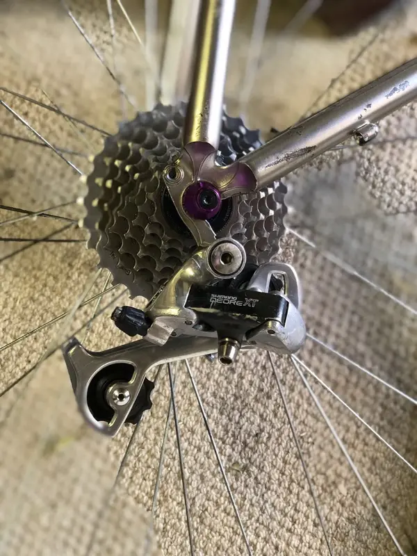

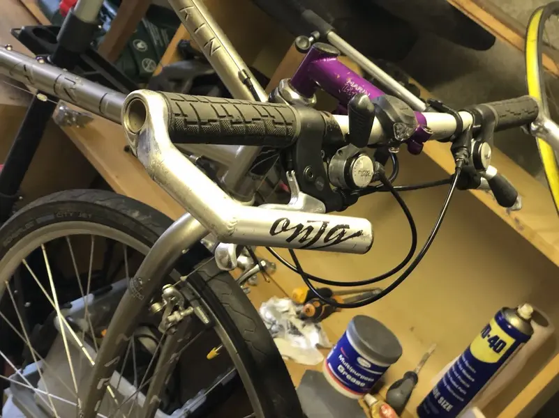

- Cabled the rear mech
- swapped the cantilevers over for “Alivio” 93 as the Tektro ones didn’t want to work, think the springs are gone.
- Fitted the chain.
- swapped the bar ends for some silver Onza L bends. The Marin purples need reanodising for sure.
- removed the bottle cage as it was also scruffy
- added grips
- weighed it.... 11.0kg :( and no front mech yet
Wonder what I can do to get 500g off?
I have some XTR cranks... and fancied an XTR rear which saves 50g.
Will add a photo later...

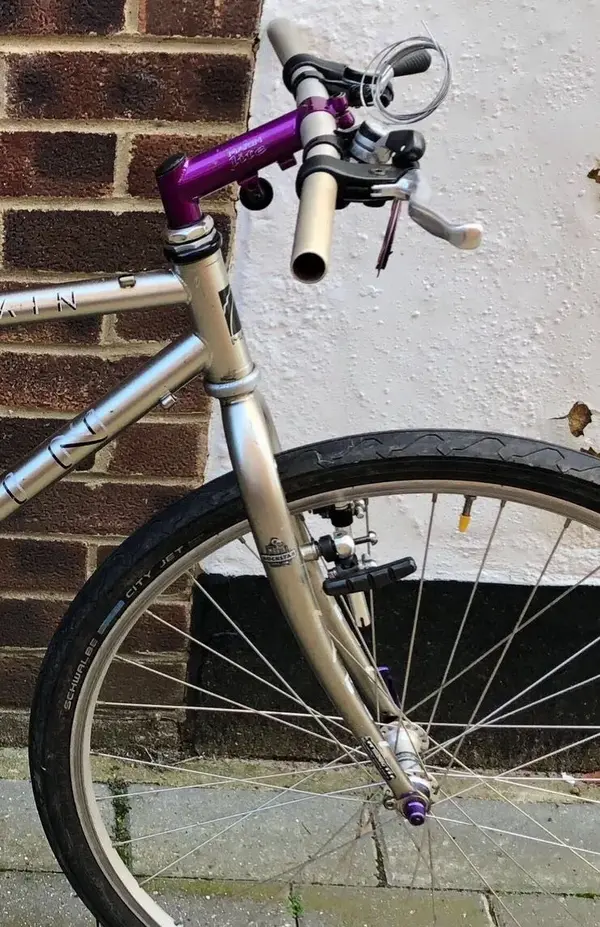

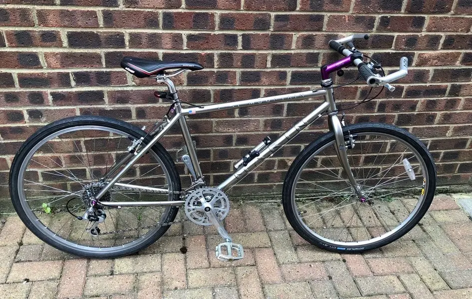

Tricky1977
Final form:
Derailleurs all indexing and shifting well, I gave the shifters a good lube and of course fresh cabling.
I’d forgotten how easy thumb shifters were to operate, I quite like them! I have an M952 XTR Rear mech to fit but seems the wrong era, and the XT mech works really well, so...
Lovely bike, fast light and nimble, rides lovely too
Should be around 10.5-11kg
