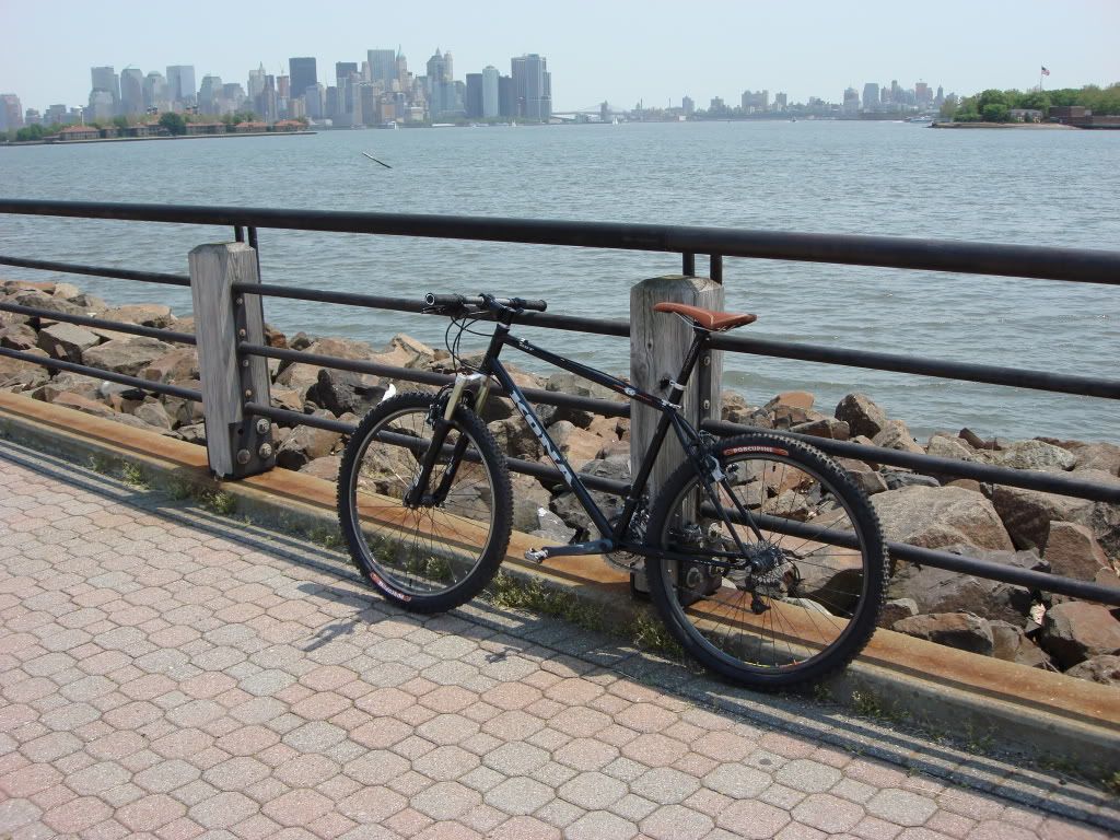

cant believe that it took another two months to get this finished, but finally got everything tightened up and ride ready. Went out for a gentle ride over to Liberty State Park on saturday on they new Hot and was very pleased with it. I'm relieved that it fits very well as I'm only 5'9" and was worried that a 19" frame would be too big, but with a 100mm stem it feels just right.
I'll be taking her off road in a week or so for the first time and fully expect an amazing ride!
Overall I'm very happy with how the build came out and the only thing I'll possibly change is the height of the front forks, but it doesnt seem to affect the feel of the bike too much as is...
Nice. Perhaps an older SID would be more appropriate travel wise. But nice all the same. You may find it a tad big on the trails though at 5'9. An 18" would be easier to throw around the twistys. But it's a freakin` Hot, so ride on amigo!
That's looking pretty classy Rich, the SIDs look absolutely right on it. If it was mine, I think I would be tempted to have the shop insert the spacer to take the travel and ride height down by 15mm, but as you say if you like the ride and the bar height the way they are then it's fine as it is.
As to size, you're within the height range for a size 19, but at the lower end of it. The only important differences between a 19 and an 18 are that the top tube is half an inch longer and the head tube is 2cm longer. So the cockpit length you've made with the 100mm stem is the same as a size 18 with a 115mm stem, no problem there. And the longer head tube could be another reason why the bar height might feel on the high side for you. But if it suits you, end of story. If not, the SID spacer could be the solution.
All in all, the higher bar, the slightly slacker head angle with more travel and the long top tube/short stem cockpit are all features of more moden design, so you can't be going far wrong.
