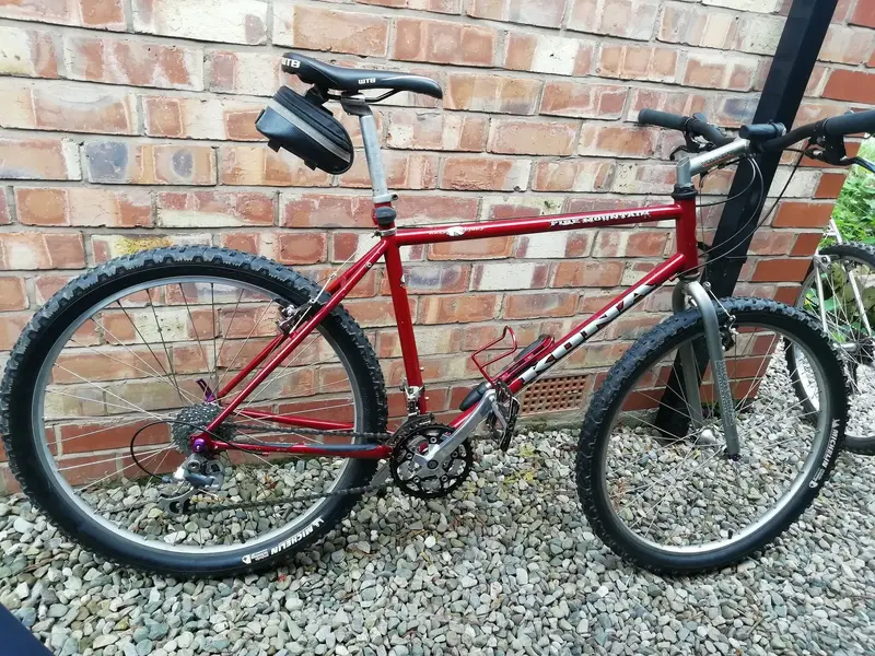

I've mentioned this bike a few times before. Bought as a project and got up a running with parts from the shed, stripped to sell, changed mind, and rebuilt but not as I want it to be. The aim is rebuild (again) but with some carefully selected upgrades, so it doesn't look noticeably different from standard (because I like it that way). Kona say in the catalogue that it is ripe for improvement, but you won't be winning any races on it - sounds like just my thing so my upgrades will be mostly from parts higher up the 1994 product range. IMG_20230627_194946.jpg IMG_20230913_172214.jpg
Nice example -- looking forward to the upgrades.
Thanks, it's got a bit of rust in places, but it's by no means serious and the paint still polishes up nicely. Have a few parts already which I acquired from a rather sorry looking 94 Kula that came up for sale locally. That's what gave me the idea to do the upgrades. I only bought the Kula because I noticed it had the rubber top cap for the stem which I was missing and the Kona brake levers which I sold and regretted. The Kula also had some other goodies on there which I shall reveal later along with photos.

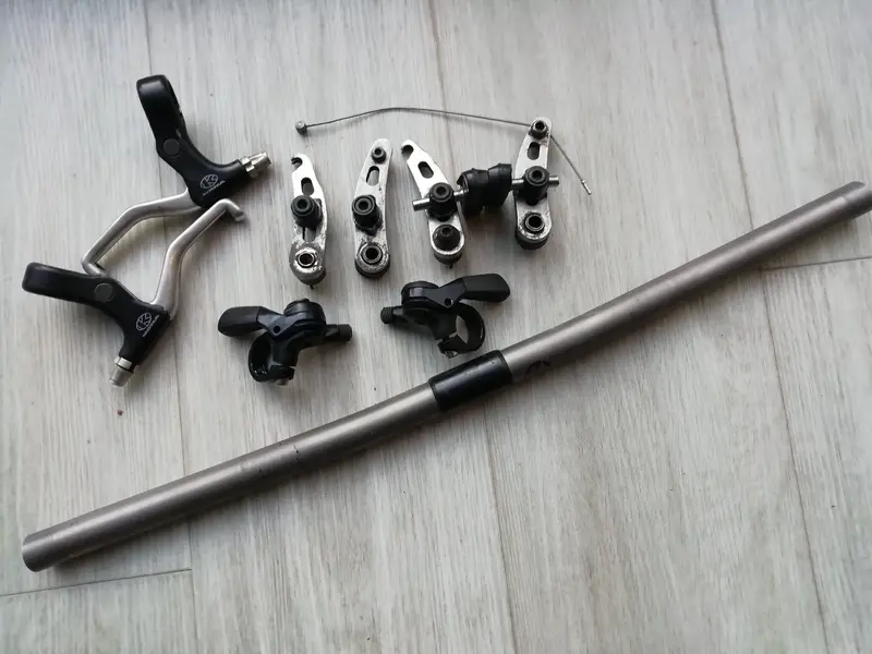

Here are some of the parts I'm considering.
- Kona brake levers to replace the ones I regretted selling - I actually found the shape of them a little uncomfortable, but that could have also been down to the fact the original brakes barely worked and how hard I had to pull them, so will give them another go.
- Kona Race Light brakes. Was undecided about these, but I think I'll give them a try. Just need a good clean and have a few minor bits missing. So these may be one of the last things to go on. Or I might go for the easy option and get some XT ones that are ready to use.
- Suntour thumb shifters. The obvious upgrade over the Deore would be XT, but Kona chose to spec these so I'll give them a try.
- Titec titanium handlebars. It was a pleasant surprise to find these. Out of curiosity I weighed them and they came in at 161g compared to 195g for the standard alloy ones. Width is around the same with slightly less sweep so I'm not sure how comfortable I'll find them, but will give them a go.
The colour of the stem and forks is also very close to that of the titanium so they will look nice on there.

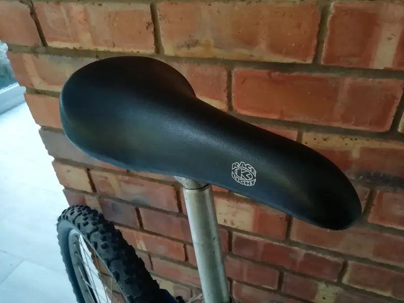

And a Kona Race Light saddle. This is exactly what was fitted to the FM in 94 only a better example than the one I had.
