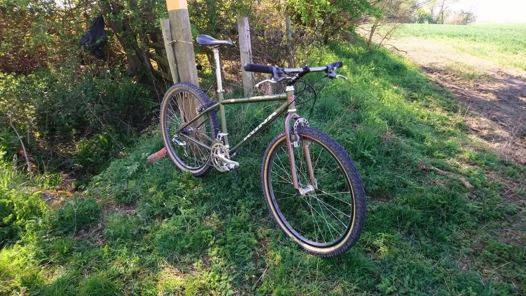

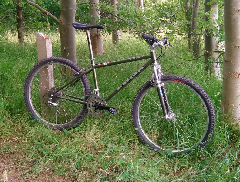

1994 Kona Explosif
Looking a bit different, crank went cos' I didn't want to break that much cash, Mag 21 off to try it rigid, meant a change of headset and stem, although I will get a conversion kit for the King at some point. M900 has returned to the Orange Prestige, I now have less qualms about riding it! Weighs in at 22lbs 13oz which makes me happy!
PS. Not sure how I didn't notice the dog egg bag in the tree! Take it home/put it in a bin, dirty feckers! DSC_0136-1280x722.webp
Out for a ride, it's a lovely little bike!

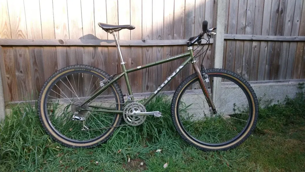

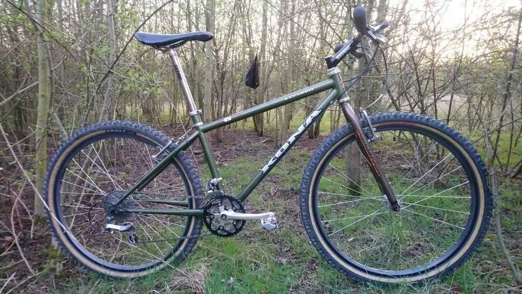

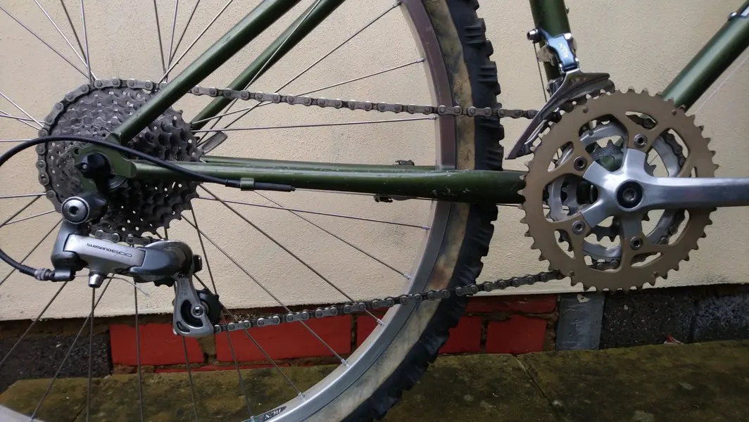

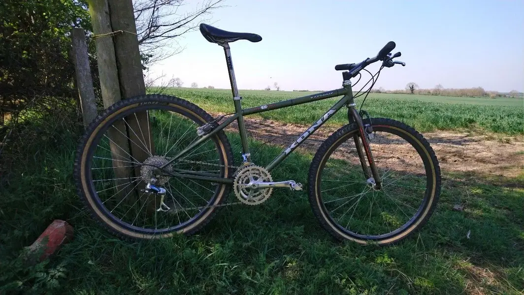

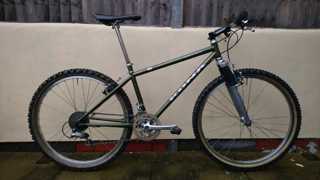

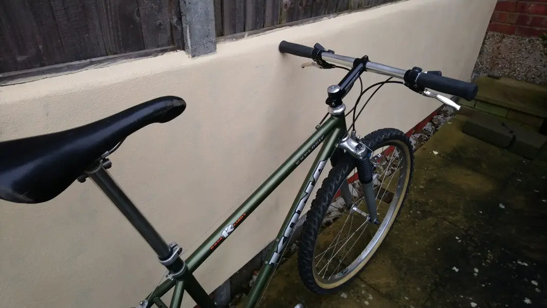

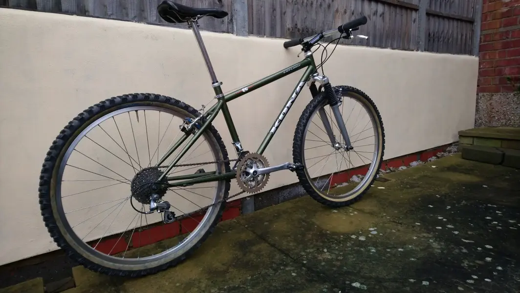

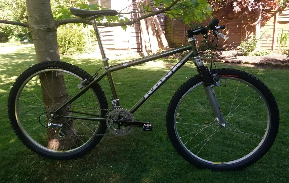

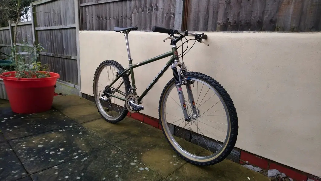

Haven't revisited this for a while! I was looking at my Cannondale the other day and couldn't help realising that the spec it has ended up with would suit the Explosif a treat, so out came the spanners!

Frame: 1994 Kona Explosif 16"
Fork: Rockshox Mag 21, SL crown and steerer, long travel kit fitted woooo 60mm :D
Headset: Chris King no logo
Stem: Titec t slot steel 120mm x 10°
Handlebar: Can't remember what it was badged as but it's the same as a Kona bar
with the internal ribs, same model no stamped on the end
Grips: ODI attack (not pictured)
Barends: n/a
Brakes: Diacompe 987 cantilever
Brake Pads: Aztec Control blocks (not pictured)
Brake Cables: Shimano
Cantilever cable hangers: Diacompe
Brake Levers: Diacompe SS7
Shifters: Suntour XC Expert thumbies
Front Derailleur: Shimano Deore XT fd-m738 (m900 in the pic)
Rear Derailleur: Shimano 600 rd-6401
Derailleur Cables: Shimano
Cassette: Shimano XTR M900 12-32
Chain: Sachs Sedis
Cranks: Sugino Mighty 900
Crank Bolts: generic Allen bolts
Chainrings: Sugino 44/32/22
Chainring bolts: Sugino
Bottom Bracket: Shimano UN-52 68x110
Pedals: Shimano M-525 SPD
Hub Skewers: Halo (not pictured)
Rims: Bontrager BCX-1 front, BCX-2 rear 32h
Hubs: Shimano 600 32h (rear conversion to 135mm axle)
Nipples: DT Swiss brass
Spokes: DT Swiss competition
Tyres: Tioga Psycho K front, Psycho TT rear
Tubes: bontrager
Saddle: Selle Italia Flite
Seatpost: U.S.E. alloy
Seatpost Binder: Kona
Weight: bloody good question :D

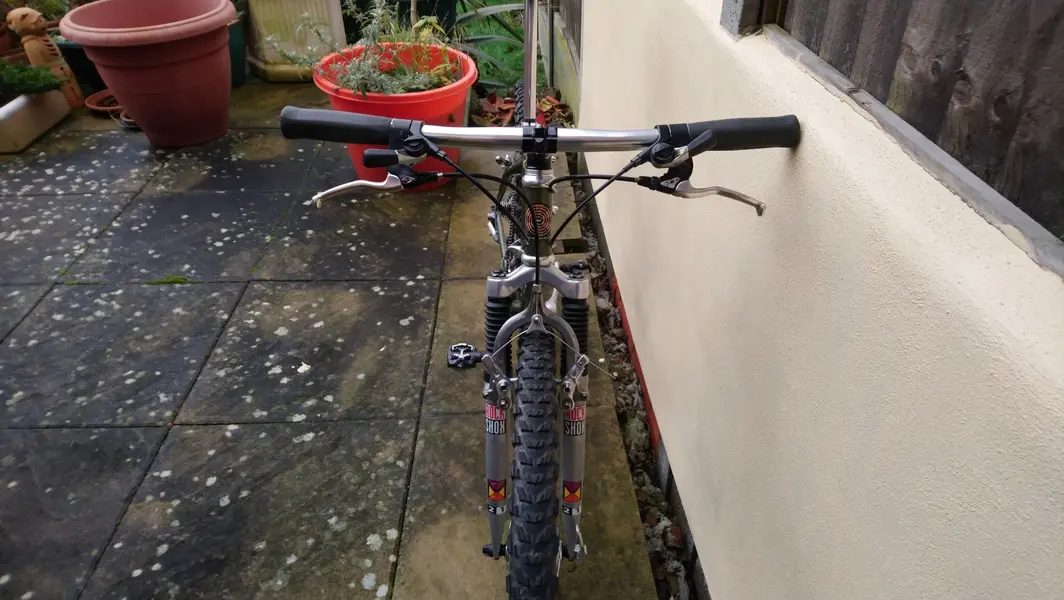

looking good with the Mag's and the new stem 8)
happy you post a pics. of the 94 Explosif with a Mag21 as commonly you see them with the Marz. - like mine have. But as the Marz. are loosing air, I wanted to testfit a Mag21 to see how it looks - which I dont need now :D
