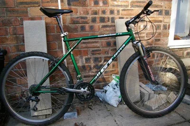

When I got this bike I had a plan to put purple anodised bits on it.
I started at the old pedals and never got much further.
Purple bar ends?

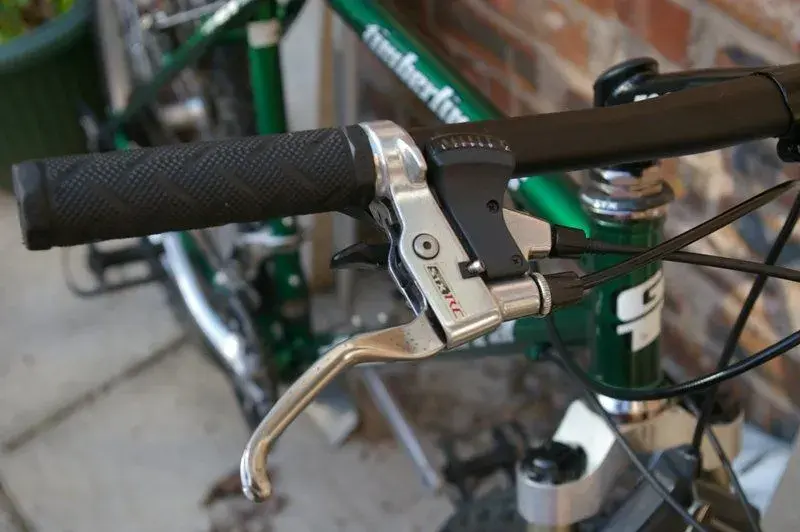

The bike is pretty much ready to go now, there'll be future updates but the addition of new shifters means it's rideable.
Not authentic in the slightest... Built to be ridden around my neighbourhood. It now has parts of Alivio, STX, STX RC and LX on it. Ironically probably would have happened to it in the 90s had I had the cash.
So here's the spec:
Frame: GT Timberline 4130 Chromalloy
Fork: Manitou Mach 5 Comp (Pro Outers)
Headset: Shimano STX
Stem: Zoom Chromalloy
Handlebar: Bikehut Alloy
Grips: Unbranded
Barends: N/A but coming soon
Brakes: STX (Thanks Retrokona)
Brake Pads: M-System
Brake Cables: Sithlord Specials
Cantilever cable hangers: Shimano
Brake Levers: Shimano STX RC
Shifters: Shimano STX RC
Front Derailleur: Shimano Alivio
Rear Derailleur: Shimano Deore LX
Derailleur Cables: Sithlord Specials
Cassette: Shimano Alivio
Chain: Taya Chain
Cranks: Shimano Alivio (In all bolts & rings)
Bottom Bracket: Shimano el-cheapo.
Pedals: Unbranded from my Avalanche
Hub Skewers: 'Outpost' branded *
Rims: Araya *
Hubs: Alivio rear, unbranded front (can't get the MBUK Club Roost sticker off the front :lol:) *
Tyres: Michelin Mildgripper PR *
Saddle: GT Gel *
Seatpost: Kalloy *
Seatpost Binder: Cheapo QR *
Weight: Yes... It weighs like only an entry level 90s GT could... 29lbs according to my scales but it has to be more..
* denotes potential future upgrades

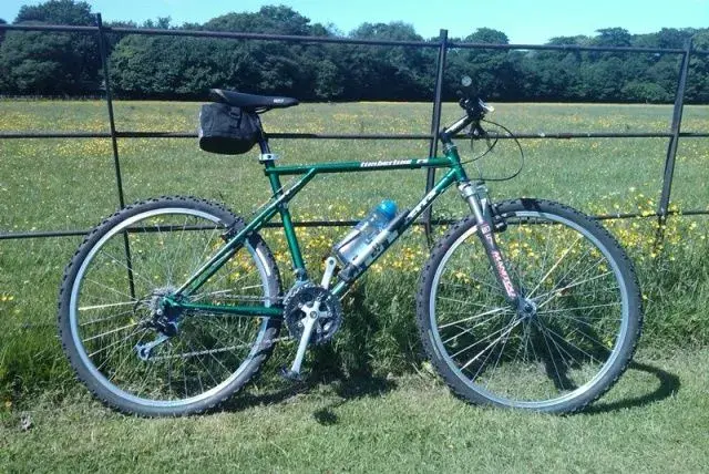

I did 14 road miles on this yesterday.
I don't know whether I love the mechanical gremlins or hate them :lol:
After 7 miles and at the furthest point from home I heard a whirring... Looked down to see the top jockey wheel on the rear mech had unbolted itself. Fortunately, the bolt was still holding the wheel in the mech at an angle and I had a selection of allen keys.
Other teething probs from it's first two outings:
* After it's first outing the whole headset had worked it's way loose. Either incorrectly tightened or the fork threads are busted, I suspected they were damaged earlier in the build. I will continue to monitor them.
* Either I didn't tighten the fork leg bolts, or they came loose at some point. Tightened up after it's first ride and stayed tight on the second one
* Both wheels are slightly buckled. I trued most of the problems with the rear wheel out, but my wheel truing skills match my ironing skills and my shirt looks like I was dragged through a bush.
* On the first ride I rode with only the old rear Alivio shifter, by the second I'd got the new STX ones... In the process of changing them over I appear to have frayed the gear cable so that'll have to go.
It was a giggle trying to complete a ride while simultaneously fiddling with the gear shifter to get the thing in the gear I wanted though.
Will need to build some confidence in it before I can take it to Delamere.... While remembering that my stopping distances on cantilevers aren't quite as optimistic as with V-Brakes.
Took this round Delamere today... 20 miles or there abouts. Great fun too. I actually don't feel quite as shattered as I have done on the Avalanche lately. Although I did miss the 32 tooth ring up at the rear once or twice.
No major mechanical issues aside from the rear cones being a bit knackered... Slightly wobbly. Oh and the chain occasionally slipped. I can live with that until I have a few quid for replacements.
