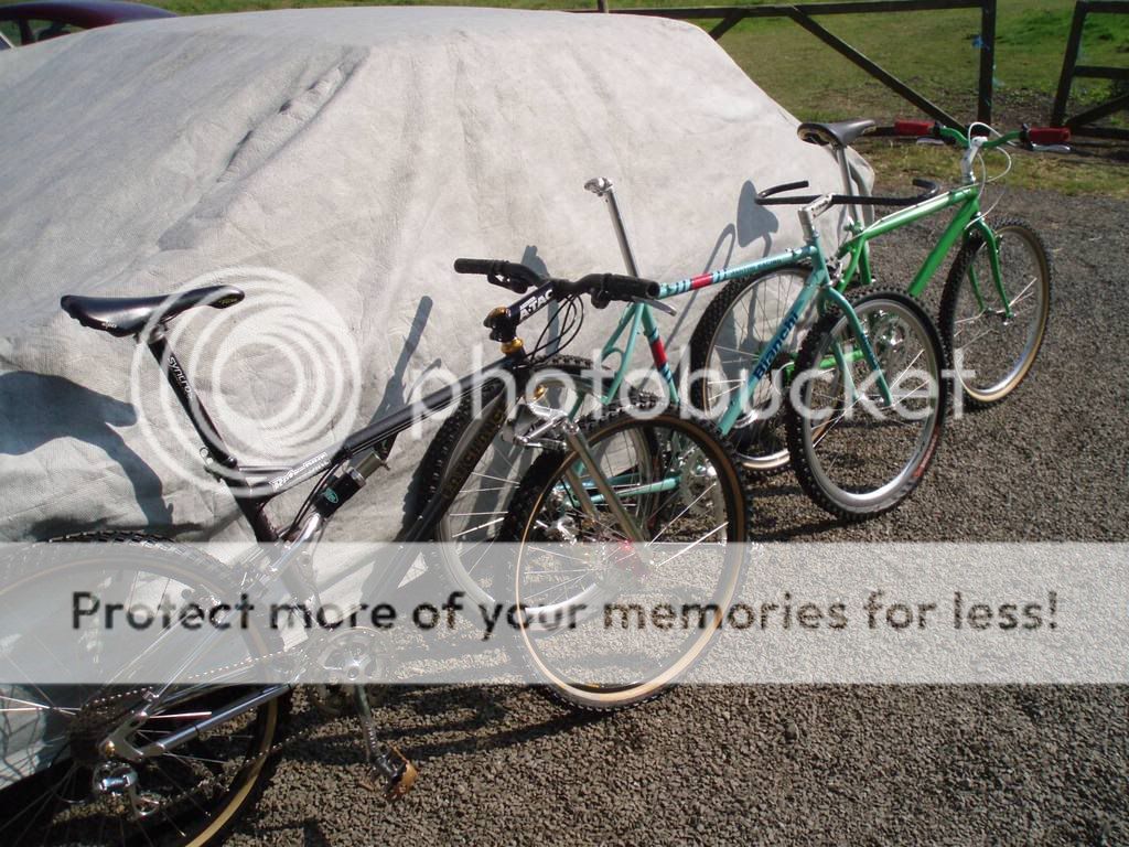

Just had it out for a blast around the fields- it rocks!
Just a brief run but first impressions are off a Yo with a super soft rear. It doesn't have much travel but takes the edge off the bumps well. There is very little sway on the back and virtually no pedal bob. It needs more air in the shock as its sitting low with lardy old me on it.
I need to work on the fork as its a little stiff over little bumps and roots and I think I need to change the cassette as the chain is slipping a little under load.

Finished at last and ready for its first run out. A few modern parts have crept into the build but its a rider and has to function. I think its retro in spirit- what do you guys think?
SPEC LIST
Frame: FAT CHANCE Shock-a-Billy, S/M 1995, Risse Racing shock and AMP seatstay brace
Fork: AMP Research F3 disc only
Headset: Chris King
Stem: Answer A.TAC
Handlebar: Syncros Riser
Grips: Yeti Speedgrips
Barends: None
Front Brakes:Rock Shox/ AMP Research Disc brake with 165mm Hope rotor, Ti bolts
Brake Pads: Rock Shox Carbon Metalic
Rear Brakes: Grafton Rim Crusher
Brake Cables:Shimano
Cantilever cable hangers: Onza Chill Pill in black
Brake Levers: M900 XTR
Shifters: M900 XTR STi
Front Derailleur: M900 XTR
Rear Derailleur: M900 XTR with KCNC Jockeys and SRP bolts
Derailleur Cables: Shimano
Cassette: SRAM 8 speed
Chain: SRAM
Cranks: Syncros forged
Crank Bolts: SRP alloy in green
Chainrings: Middleburn slickshift in 24-34-46
Chainring bolts: Generic alloy in black
Bottom Bracket: Syncros Titanium
Pedals: Xpedo Titanium clipless and Deore Flatties depending on mood
Hub Skewers: Not sorted yet- looking for Ringles in green
Rims: Mavic MA 40
Hubs: Hope Pro III Disc front, non disc rear
Nipples: Alloy
Spokes: Alpine double butted
Tyres: Tioga Farmer Johns Cousin
Tubes: Kenda
Saddle: Flite Alpes Titanium
Seatpost: Syncros
Seatpost Binder: Ringle Holey
Here it is amongst the 'hiden ones' at work
