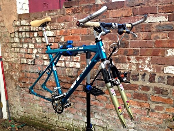

I thought it was time for another update on progress:
I'm almost in a position to finish it off now, just waiting on a new o ring for the head doctor and I'm taking the rear wheel in to be built on Saturday.

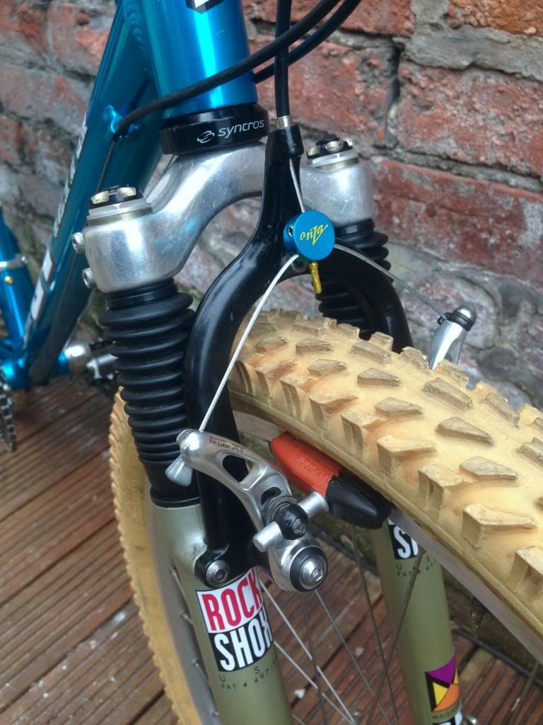

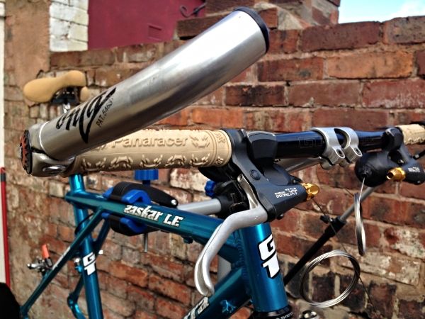

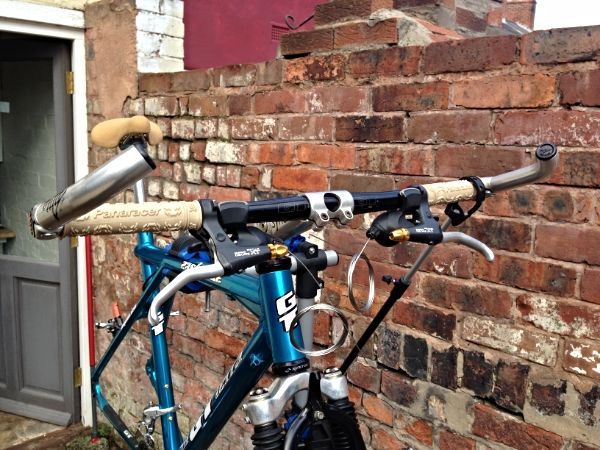

The front end is pretty much finished now and I'm happy with the way it's turned out. There is a GT bar hanging off of a Syncros stem. M737 shifters & levers finished off with Panaracer Magic grips and NOS Onza bar ends.

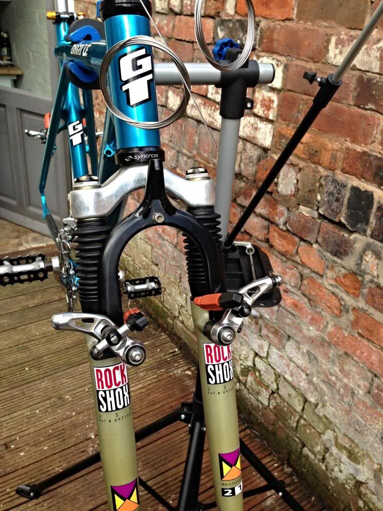

I've gone for a Mag 21 fork which has had new decals from gil_m and a NOS 11/8" crown & steerer. Brakes are XT M737 with Kool Stop pads.
I've got a black Bologna Lite fork winging its way to me, so I'll have the option of running with suspension or rigid which will be cool.

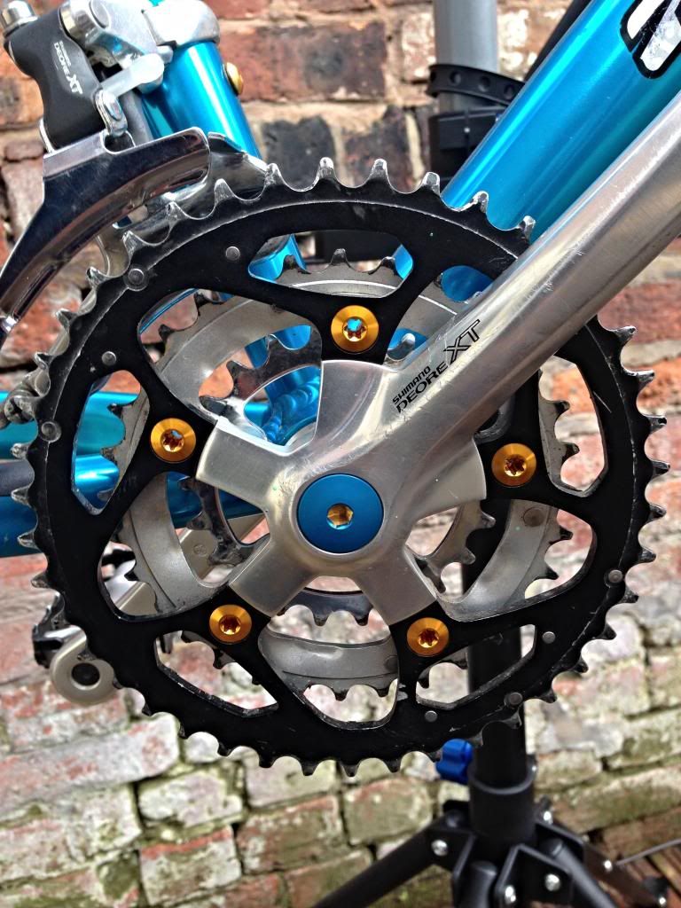

Cranks are XT M737 and I have added some ano bolts and finishing touches which I think are reasonably subtle and suit the frame colour nicely.

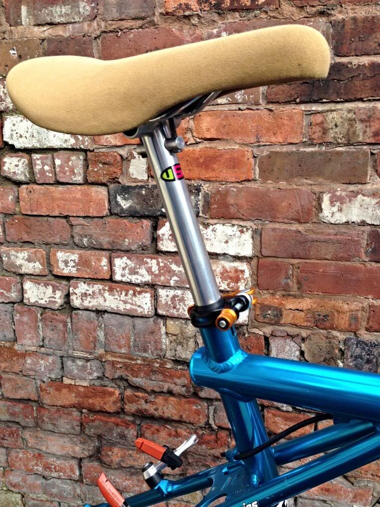

Saddle is a modern job off ebay chosen for its retro style and the fact it matches the grips.
Can't wait to get the wheel built up so I can finish it off now.
Re: 1994 Aqua Blue Zaskar LE
Rear wheel should be built by Tuesday.
New o-ring for the Hope Head Doctor arrived yesterday.
Might have a finished bike by the end of the week. 8)
Oh and if anyone wants a replacement o-ring for a head doctor, I have nine spares! :D
(Was still a lot cheaper than buying one from Hope though! :roll: )

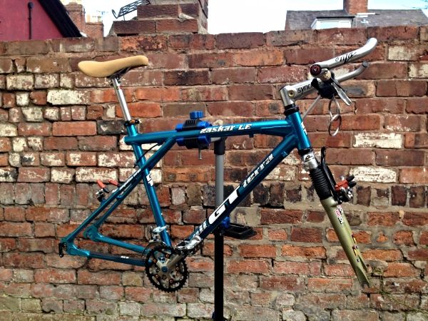

T'is done!! :D
Frame: 1994 18" Aqua Blue Zaskar
Fork: 1994(?) Rockshox Mag 21
Headset: 11/8" Syncros Threadless
Stem: 135mm 11/8" Syncros
Handlebar: GT- Black Alloy
Grips: Panaracer Magic
Barends: Onza
Brakes: XT M737 Cantilevers
Brake Pads: Kool Stop dual compound
Brake Cables: Shimano
Cantilever cable hangers: Turquoise Onza Chill Pills
Brake Levers: Shimano XTM737
Shifters: Shimano XTM737
Front Derailleur: Shimano XT M739
Rear Derailleur: Shimano XT M739 with SRP Gold breakaway & pulley bolts
Derailleur Cables: Shimano M System
Cassette: Shimano XT M737
Chain: Sram Power Chain
Cranks: Shimano XT M737
Crank Bolts: SRP Gold Alloy with turquoise alloy caps
Chainrings: XT M737
Chainring bolts: Onza Gold alloy
Bottom Bracket: UN72 78mm/110mm
Pedals: VP XT Copies
Hub Skewers: Shimano XT M737
Rims: Mavic 317
Hubs: Shimano XT M737
Nipples: Alloy
Spokes: DT DB Stainless
Tyres: Panaracer XC Magic
Tubes: Continental
Saddle: Unknown
Seatpost: U.S.E.
Seatpost Binder: GT? with gold QR
Weight: 25.5lb
Cheers.
Cast came off yesterday so with luck I'll be getting it muddy soon. As for weight; I have no idea. I really should get a spring balance and find out. :D
