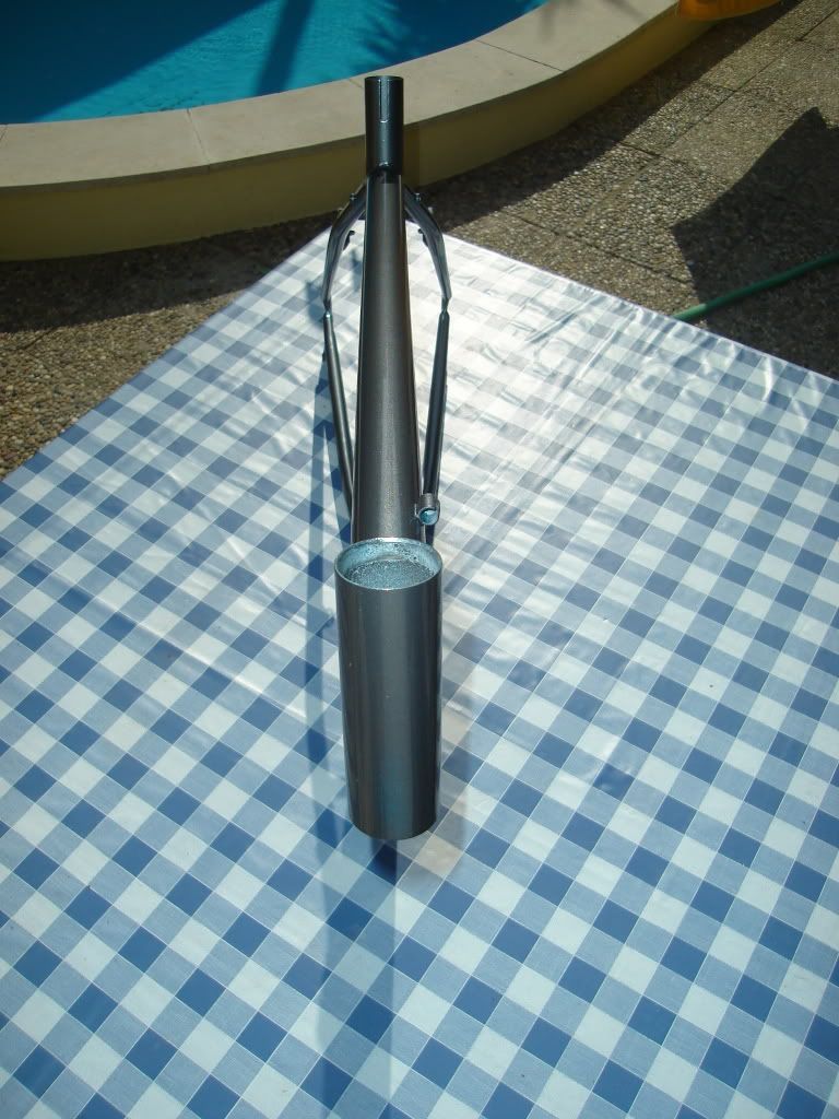

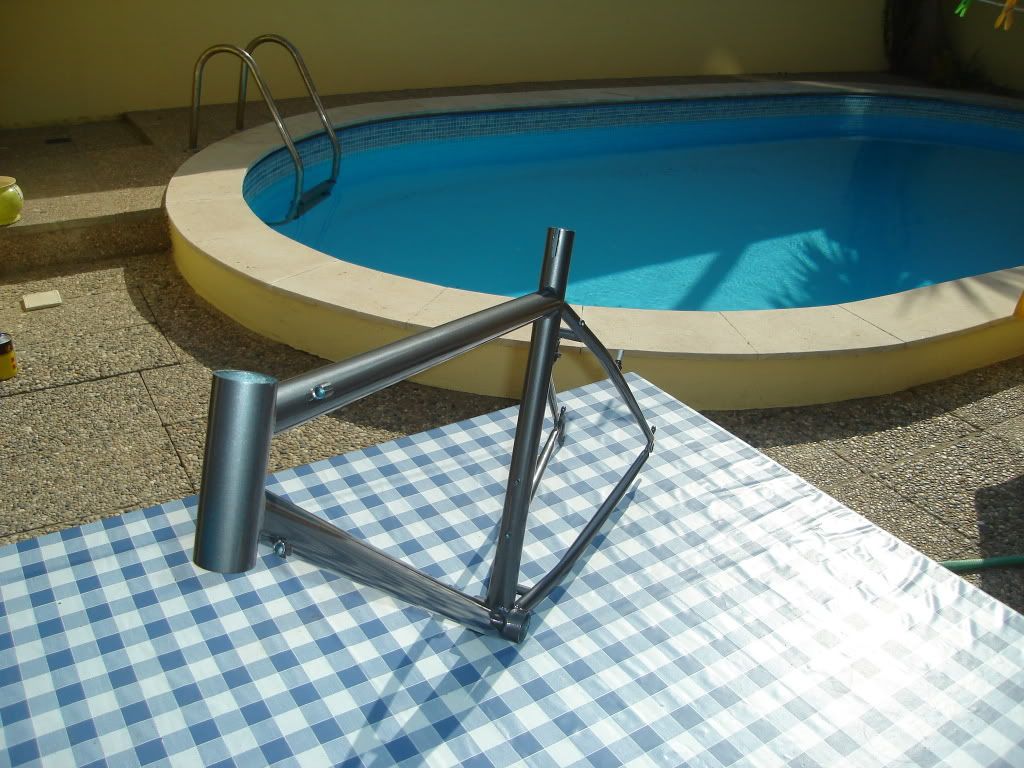

I'm not sure what's worrying you, it looks fine to me. Bear in mind though that however hard you work on it, any decent painter will still shotblast it because that's the only way of achieving a totally clean and smooth surface for the primer.
The only rust you need to worry about is rust that has come from the inside of the tube and has reached the surface, but I can't see any signs of that.
As far as the rust on the inside of the seat tube is concerned, you always get surface rust down there. Is there anything specific to make you fear that it might be structural?

I was worried because the chainstays looked really rusted so I stripped it to be sure there weren't any big rust spot's, it looks good after the stripping but I do not have much experience with rust so I wanted a opinion from you guys.
I know it going to be shotblasted anyway(already contacted a painter) but I enjoyed cleaning it.

It's the internals that matter, not the outside! It LOOKS structurally OK in the usual worst places. Can you feel inside the chain stays at the shell? Have you flushed it out with oil/white spirit to see what emerges? Does it "ring" OK when suspended and played like a triangle?
I've had at least two old steel frames on which previous owners have spent much money on pro re-sprays and which on closer inspection I've cut up and scrapped! The highly reputable (and expensive) folk who did one of them really should have known better....
