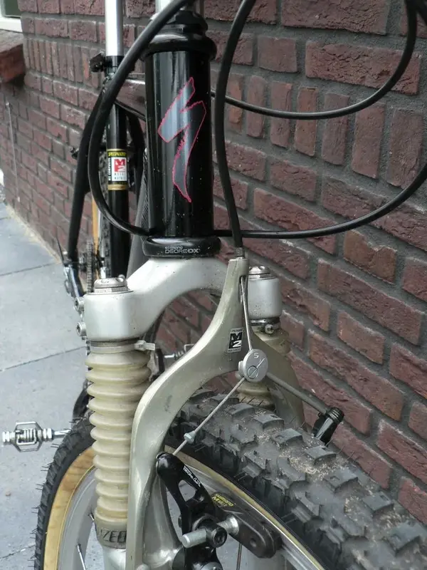

I've found an other fork with a M2 canti brace which fits the bike nice together with a DX headset all problems are solved. It's in a good working order :D

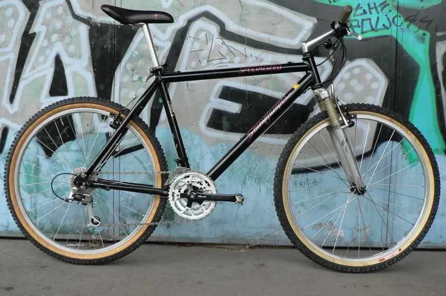

Sunday I took this bike out for a spin... :D What a fun bike to ride :D
Specs will follow soon 8)

Frame: 20" Specialized Stumpjumper M2 FS
Fork: Specialized Future Shock
Headset: Shimano DX 1 1/8
Stem: Specialized Team Cro-Mo 1 1/8
Handlebar: Specialized
Barends: -
Brakes: LX BR-M560
Brake Pads: Shimano M
Brake Cables: Shimano Deore
Cantilever cable hangers: Shimano
Brake Levers: LX ST-M560
Shifters: LX ST-M560
Front Derailleur: LX FD-M560
Rear Derailleur: XT RD-M735 7 speed
Cassette: Hyperglide 13-15-17-20-23-26-30
Chain: Hyperglide HG70
Cranks: LX FC-M560 46-36-26
Bottom Bracket: LX 560
Pedals: -
Hub Skewers: LX 560
Rims: Specialized X23 26x150
Hubs: LX HB-M560
Tyres: Front: Specialized Ground Control 26x1.95; Rear: Specialized Ground Control Extreme 26x1.95
Saddle: Specialized Prolong
Seatpost: Specialized alloy
