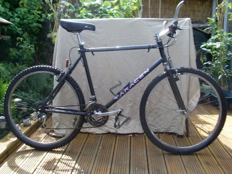

can anyone point me in the right direction to buy parts for my 1993 saracen sarhara,i want to bring it back to life,the shocks have seen there last days,they are max shocks as from factory.
would be very greatfull if anyone could help.
thanks eddie from harlow
fixed my forks
i brought some 3.3mm thick springs from euro springs,i cut them to 45mm
inserted them into my forks ,i have the some firmness as if my bike was new,cost 7 pound. the ride height is as it sould be,,sorted.

yea worked out well,once i found a long reach extension bar and 6 mm
hex piece and a very bright torch to see down the fork tube,not as factory,but works well,,
reply
hello,
go on e bay,put in compression springs,look for euro springs company,
then contact joanne through message,ask for spring size.
125mm long
2.34mm wire
22.2mm outside diameter 2.75£ +p&p
then cut spring to 45mm,they fit nice.
bit of hard work fitting them but they do work well
they also do a firmer spring i used could do being a bit softer
try below or buy both see whats best
152mm long
3.3mm wire
19.45mm outer diameter 4£ each
best of luck eddie
