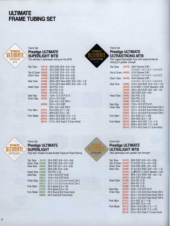

decals are Gil repros. as nice as they are, i will replace them if i can source originals. RM head/seat tube badges I can do for sure as they aren't quite right. the RM downtube decals a maybe as I'll have a source for replacements but I'd like to stick with the white on black and not sure at the moment. I'll prob leave the Thunderbolt model decals as is until I print off ones needed for my Titanium and do both. I want to add tubing decal and I believe it would by white diamond shape Tange Ultimate superlight/ultralight MTB decal?

The '93 may have used a Rocky branded tube decal ?
I have no actual idea though and unless you're good with identifying tubing, neither will you.
Tubing, geometry and fillet or not construction all custom to the buyer as far as I know.
