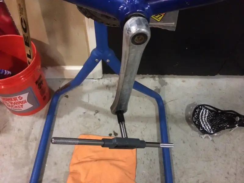

another step forward… mustered up the nerves to tap the crank threads to be able to fit the pedals with ti spindles. all went well *phew* and the pedals now thread in nice and smooth. :D
I love using my taps, but I agree, the first time is very stressful, especially on such a nice crank set!

i decided to tap from back to front on the cranks. less nerve racking as there's no chance of messing up the threads at the beginning where the pedals are inserted trying to square the tap going in. ;)
it also helped i did some practice tries on a number of less important cranks i had on hand.

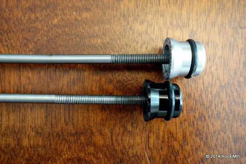

not sure which thread i should put this update in as i've not decided what to do with these just yet. but since all the "WD Pro"-style Ringle "re-working" was in this thread, decided to dump this here.

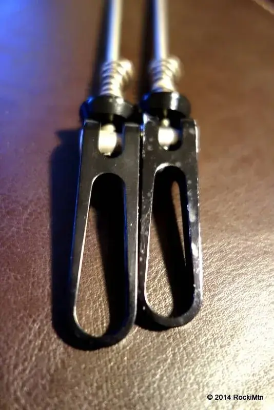

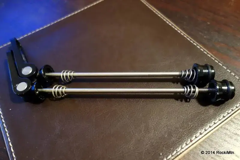

originally i was only looking to pick up one of these Ringle "road" skewers. my intentions was to strip it down and convert it into a seat binder to somewhat match a set of Critical Racing skewers currently on my Cirrus, which now may be shifted to the Altitude. however, luck would have it, there was two independent sales for what looked to be matching front and rear that i could make into a set. i scored both but when they arrived, the shorter that was advertised as a front was WAY too long and the threads stopped beyond the fork drop-outs. :facepalm:

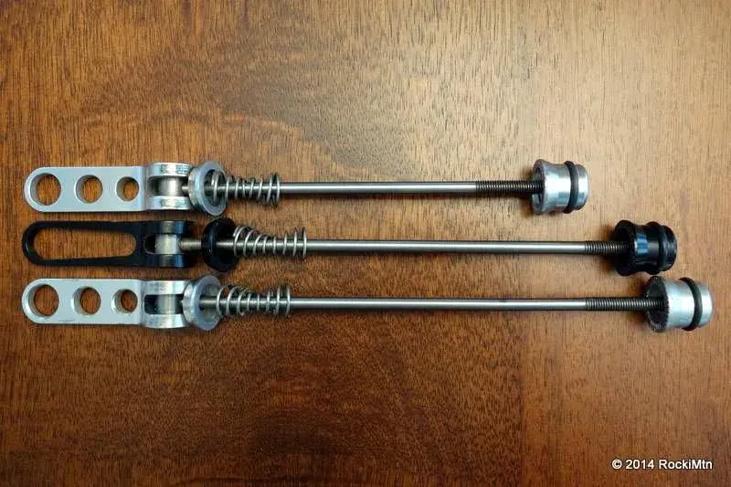

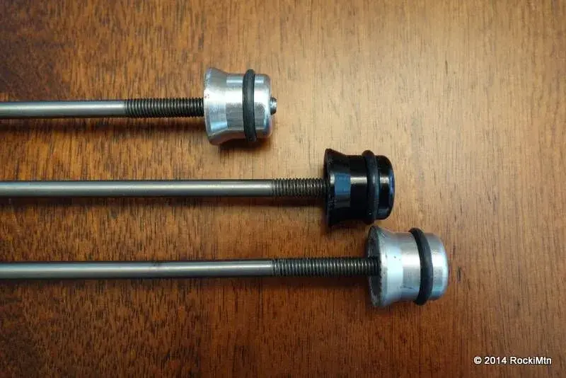

as you can see the shorter one compared to a complete 3-holed Ringle set, the threads end at the same spot as the rear. so i'm guessing it's a rear that's been cut down. however it's a tad too short for a rear application, at least for a mountain application, perhaps on a road bike it would be fine? :?
anyhow, i decided i would add threads and trim it to fit as a front. a made use of the newly bought die and tap set i picked up to get a proper handle for the pedal taps i borrowed for the cranks. after a arduous amount of time and effort, i've added about 25mm of threads. enough that it'll work on the front now. you can see where the old threads end and the new ones begin by the dark/light thread areas. just need to trim it down to the appropriate length. :D
