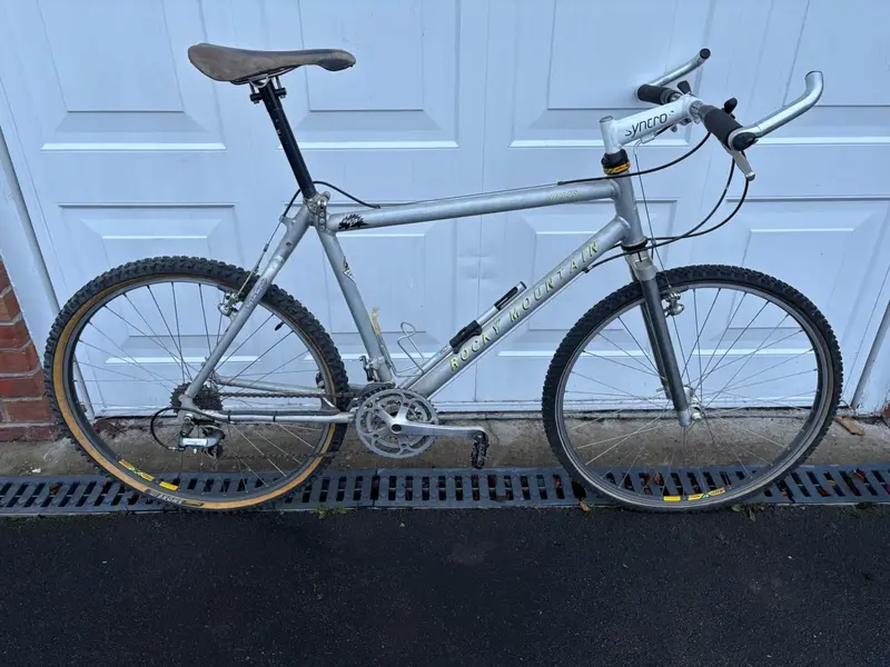

1993? Rocky mountain Nimbus.
I am the winning bidder picking up tomorrow.
My first RM any input appreciated always drooled over them.
I will have a proper look over and get some pics posted.

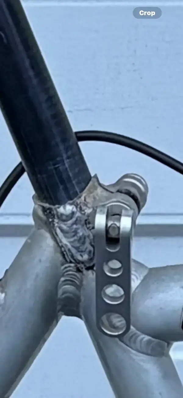

Good work - even with the weld I think well worth the outlay!
The weld looks slap dash but if believed, it stopped further damage. A decent aluminium welder could probably clean that up and carry out a professional repair if the current job bugs you. Personally the bike and the kit on it, makes a good purchase.
Hi I agree with
the weld I'll look at the repair redo guess it could weaken with more welding. I think the seat post is not inserted to correct depth resulting in damage.
It was a common problem on the early Alu Rockies , same on the Stratos, Cirrus, Experience.
You'll probably find the seat post is 400mm long, as it's a Syncros early one, so goes a long way in.

I am looking at the catalogues and getting info together and picking up tomorrow - the buyer (orininal) sounds ok too. I have a couple of Easton Elite frames and rate the ride feel. I will post up pics and go slowly on this one try to keep it used look and decals. I would be interested if I could find the builder and welder from the frame no. I have a few on the go Orange and Marin + a Park Pre Team 925.
