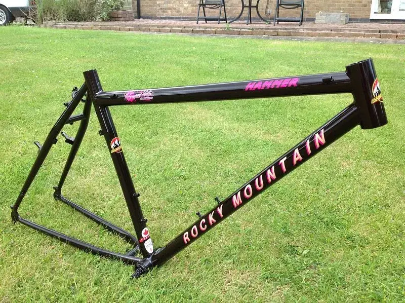

Hi all again, another quick update, I've completed the lacquer coat on the frame, and it looks pretty good. I have a couple of runs to sort out both other than that it's done.
So after waiting a week to let it harden, I shall be starting the rebuild next weekend, yay!
oops there should have been a pic attached to that last post!
And big thanks to Gil_M who sent me the replacement decal in time for the weekend! :-)
here it is:

claret73":3ck02t8u said:
Schweeeet!!! 8) 8)
That's looking so Good! Bet you're happy after all the hard work has paid off?
Thanks, yeah I'm really please with it so far, I can't wait to see it all back together. But I'm making my self wait to let the paint harden. It's killing me! ;-)
