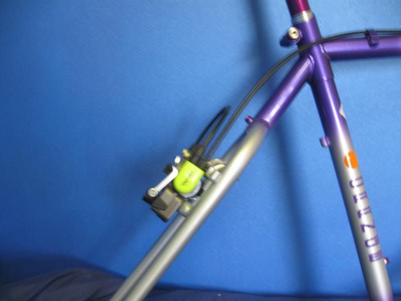

As for the brakes... I may find some good condition Magura Racelines in neon yellow (as fited bitd) as the rear brake cable stops are already drilled out to take the hydraulic hose, so running cable brakes would mean a long run of outer, or something else?

The smaller Orange frames (I've had a couple) don't have canti stops due to the super-short wishbone and get around the problem by using a seat bolt mounted canti hanger like this.

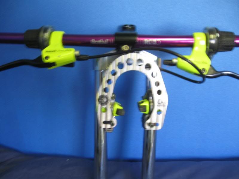

I managed to find some Magura HS22 Raceline brakes, the same as I had fitted when I originally built the bike up, flouro yellow & purple are certainly eye-catching in an early 1990's kind of way! :shock:
The Gripshift SRT800 X-Ray shifters are now fitted as well.
Originally I never used the magura brake boosters or the quick releases, however I remember that the canti studs on the forks did begin to bend outwards a little towards the end of my prevous ownership of the bike, so this time around I think I'll use a brake booster on the front...
The HS22's I bought came with a couple of the later Magura boosters, and also an Odyssey "U4-Plus Titanium" brake booster, which although manufactured later seems pretty pimp 8)
Is there a way of running a non-Magura brake booster and still retaining use of the quick-release mechanism? Or is it just a case of living without the Q/R (not a big deal for me really).??

the removal of the canti hanger i think is beneficial, i usually have a "if the canti hanger is there you must use it" rule but if you are/were using maguras then it not being there looks so much nicer than it being there and redundant.
