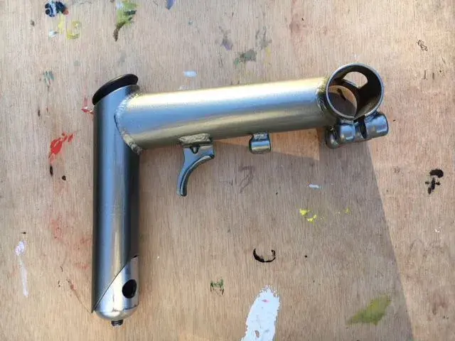

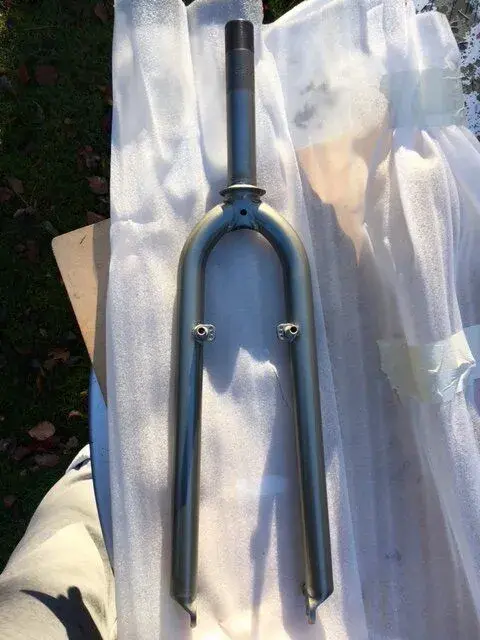

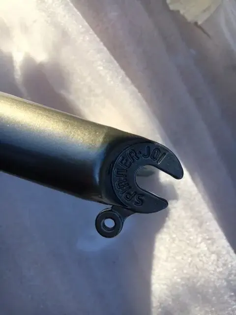

Couple of updates from autumn. Been a slow burn, mainly from lack of funds, obtaining parts for a Hei Hei - also in the works - and wanting to get everything 100% before finally pushing now to finish .. ➡️
Over the summer, I acquired a battered 93' Cindercone, to use as a donor for the Hot, and decided to have the forks restored to match the original silver. Ooey Custom kindly offered re-doing the donor spare stem, which was little mangled, as a freebee so took on the offer.
Not sure yet if I'll use the original chrome version, that the 93' Hots originally had fitted, or use the new coloured matched one :D Chrome version is marginally lighter :facepalm:
