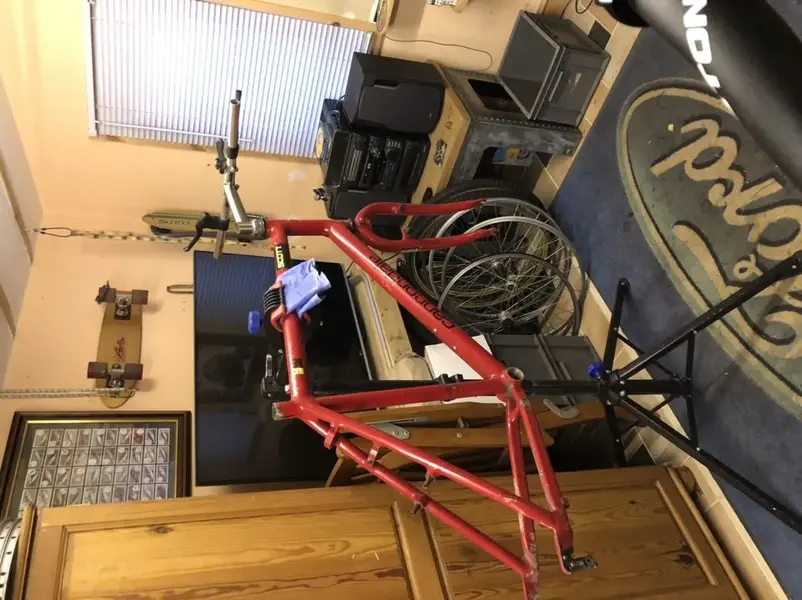

Picked up this f/f on Saturday after purchasing on e-bay. Was a bit of a punt tbh - the seller had it listed as a ‘Scott mountain bike frame’ because it had a Scott sticker on it. I could see it was a beast of the east so chucked a bid in at the last minute and won it at the starting price. Had to drive to south London to get it though.
There were no details on size in the listing and it measures 18” c/c or approx. 20” centre/top, not sure if that makes it a large or an XL - from what I understand they sized these differently due to the high bb? Any advice?
Anyway it’s all there and no cracks, although plenty of chips and scratches. Put a couple of wheels on to see how it sits and I’m happy with the look of it.
I have LX and XT components knocking about so it’ll get assembled and ridden - see how I like it, paint will be touched in for now. Possibly might re-powder coat and fresh decals in the future.
Hope you like - any thoughts/comments welcome, will keep the thread updated as I go.

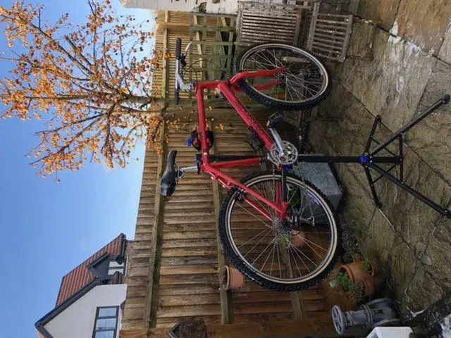

sparkybhp
Update
Got the paintwork all touched up and built the bike up with components I had in the spares box. Just waiting for a front mech to turn up but other than that it’s all there for now.
First impressions are good, nice and light bike, long stem and narrow bars give an old school feel to the ride which I like.

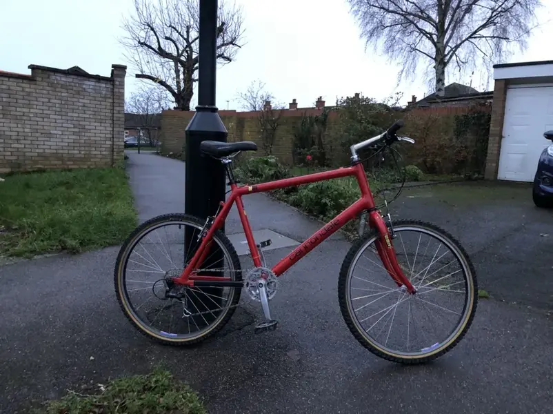

sparkybhp
Update
Almost finished now, front mech came today so that’s on and fitted, Panaracers turned up earlier in the week and they look the business (thanks Jon Smith on here).
I’ve also got some Deore LX hubs in black that I’m thinking of lacing on to these Ritchey rims, not sure.
Had a dig around the forum and worked out that this is a 22” frame from November 1992.
Going for a decent ride on it tomorrow, see how it performs.

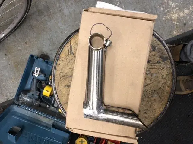

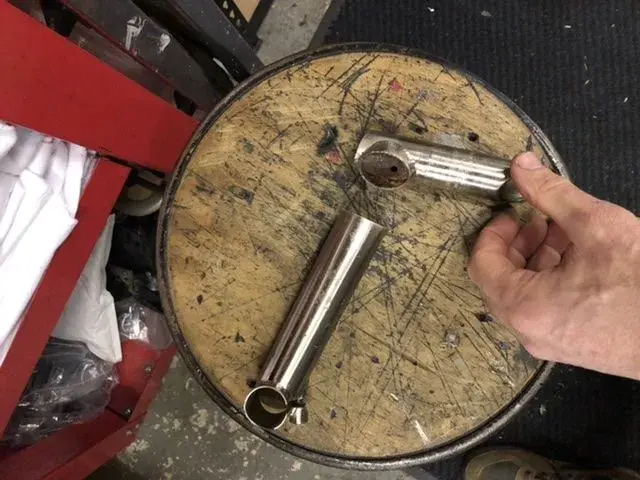

Biggest change was to cut and shorten the stem by 25mm or so, this helped make it less of a stretch to the bars for me.
Overall it’s looking pretty good now, and it’s doing a good job as my go to winter bike. Think that’s about it for now, might go back on eBay when the weather gets a bit better - see how it goes.

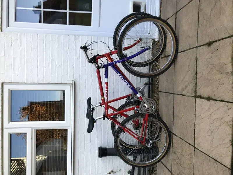

sparkybhp
Ha, it is! The head tube is crazy long - check it out next to my Scott which is a 19” large..
