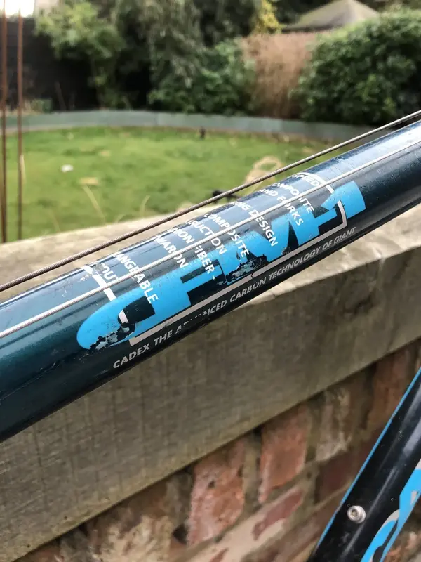

One other thing to watch on the Cadex - the size large has a very horizontal top tube and it is very easy to smack it with the end of the handlebars in a crash (or just the bike falling over). I am careful about this, but my frame has some chips on each side of the top tube as a result. It still seems strong, but It might be advisable to either adjust the stem or bars so that they don't make contact.

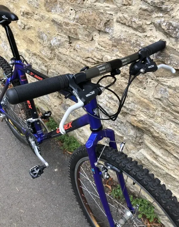

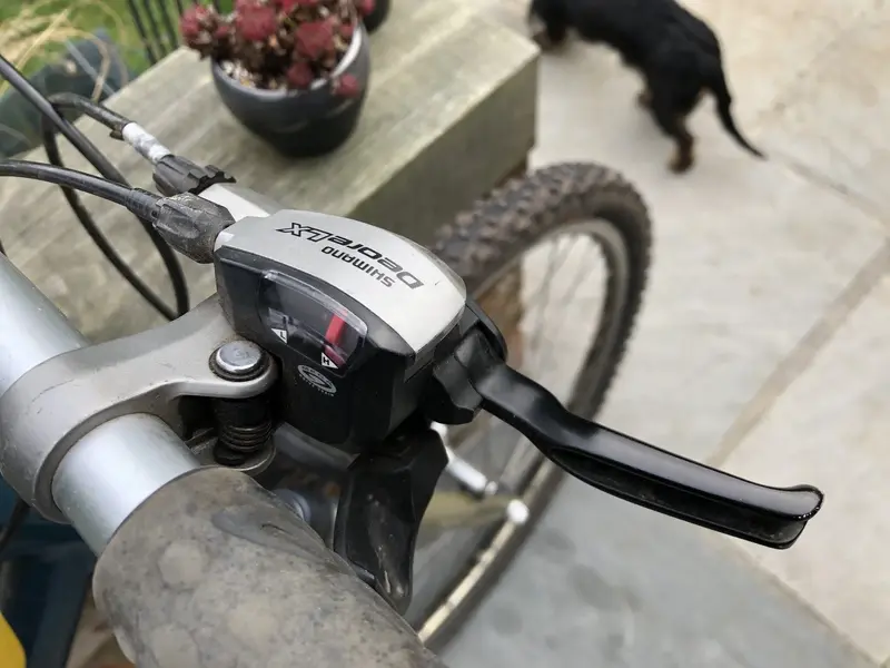

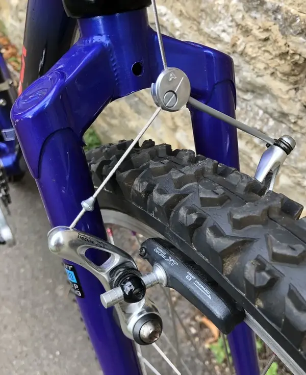

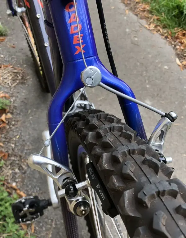

A few updates that I have been meaning to do for some time…
- V-brakes out, Cantilevers in
- V-brake levers and separate shifter pods out, brifters in - I purchased a pair of M738 brifters a while ago but only just got around to fitting them, only to change them again immediately for some better condition M737 brifters
- Short chain out, longer chain in
- Tatty M525 spds replaced by the same in better condition
Took it out for a ride and was reminded that the wheels mustn’t have been riden much since being rebuilt as there was plenty of spoke ‘ping-ing’ 😂
It’s a lovely clean bike, but actually a shade short in stem length, so I may look for a longer one.

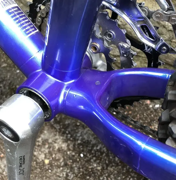

Also include a few shots of the bonded sections just for the hell of it :cool:

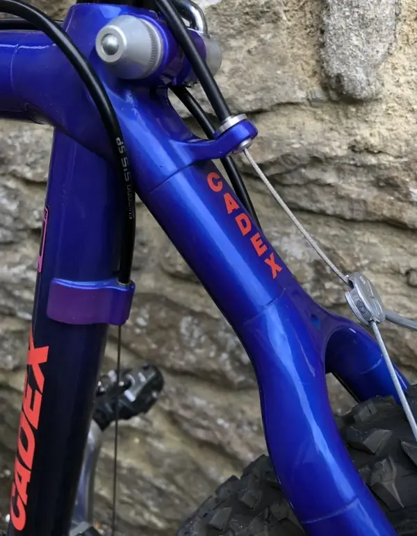

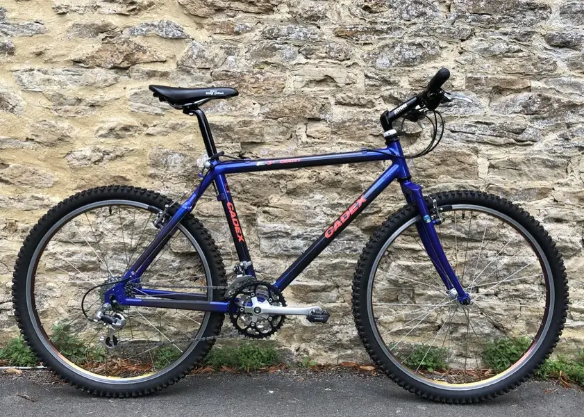

Whilst not exactly what I had, a NOS or perhaps ex-Demo 1993 frameset came up for sale on Gumtree and I couldn’t resist buying it.
I had the majority of parts in my parts bin, so the build has been quite simple. Although the parts used are a couple of years newer than the frame, as the frame has barely been used I figured they’d be ok, and I sourced new missing parts where possible.
Here's the finished spec and a few pics of the journey. Hope you like it :)
Frame: 18” Giant Carbon Fibre (Tubes & Stays) CFM-3 - NOS / ex-demo?

Weight: 11.07kg / 24.4lbs

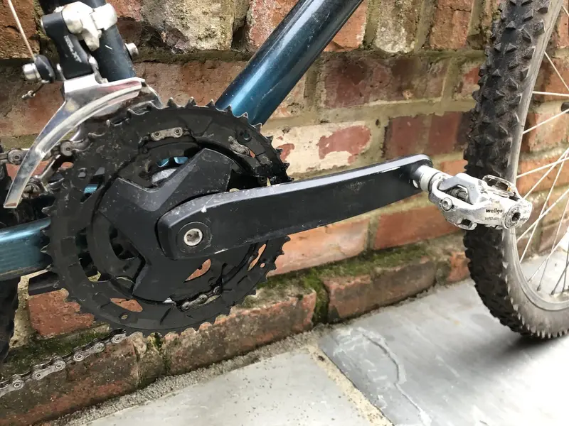

I have today collected the model that I was after - a CFM-1.
It’s not in the best of shape, but I plan to strip it down and build it back up to my ‘’95 DH Worlds’ spec or as close to it as possible. Given the condition, I’ll be looking for parts with similar patina!
But first to strip it down to a bare frame and sell off what is salvageable / bin the rest.

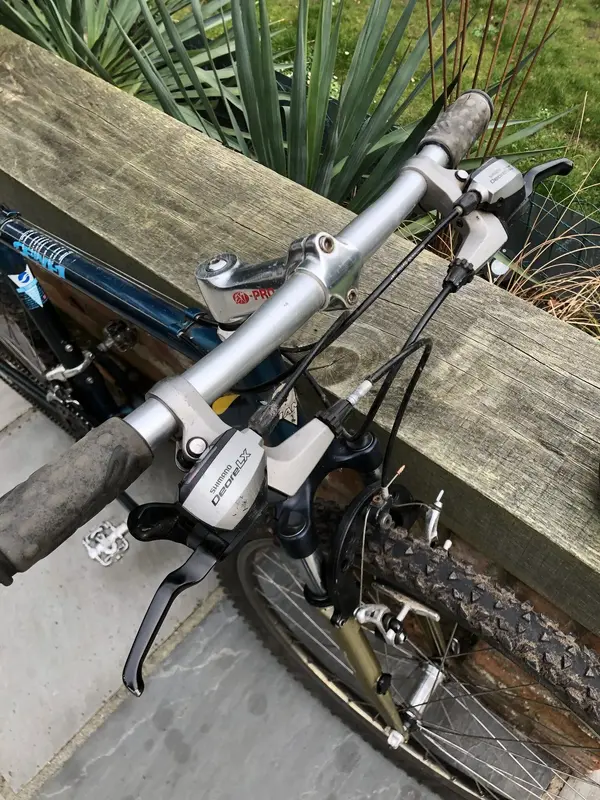

No excuse for a Chainset like this 🤮
What on earth are these?!? 😵‍💫
