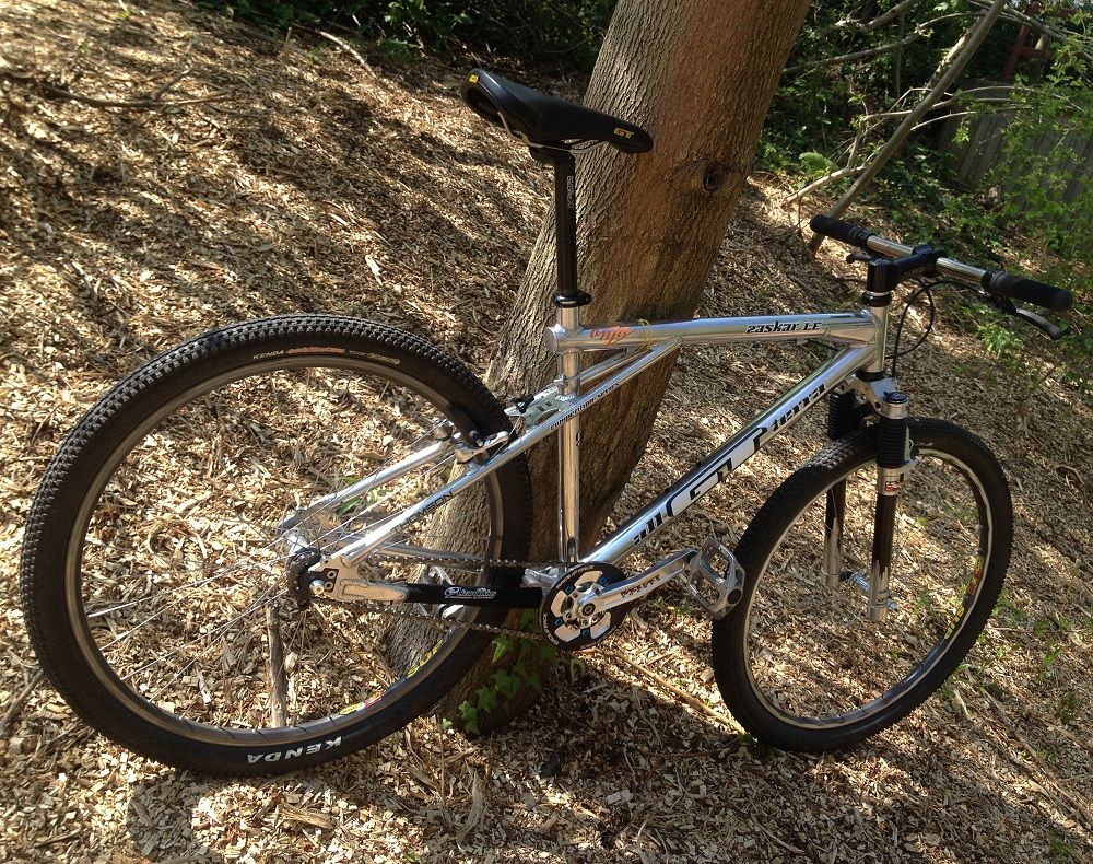

May i ask whats the best way to achieve the same hight polish finish? What did you use and whats the secret? Looks awesome! I have a couple frames that need the same treatment...
Autosol metal polish, Tesco value (or similar) dusters and toothbrushes and lots and lots of elbow grease !!
MADJEZ":1bk3l7lx said:
I used 120grit for the deeper scratches etc then 800 1500 and 2000... Then t-cut metal polish
Sean 8)
Great thanks!
SEANSTEPHENS":3owqjz5u said:
MADJEZ":3owqjz5u said:
Sean 8)

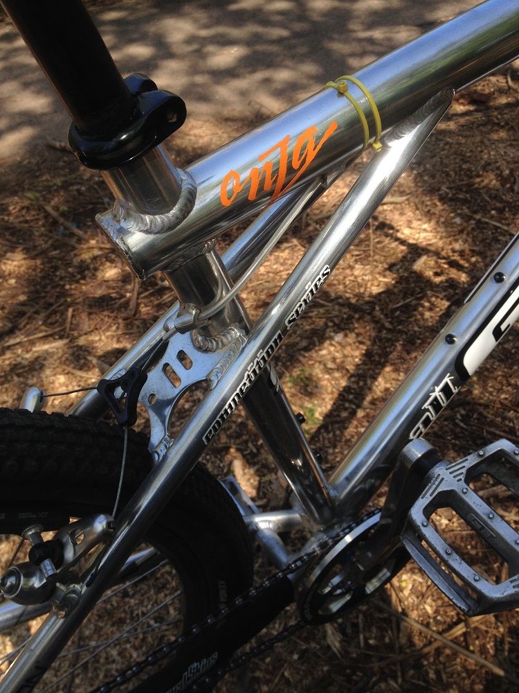

Ian W":c7q77xfs said:
That looks awesome 8)
Where did you get the decals from? They look original...
I got them from member cherrybomb, they were leftovers from his zaskar. The set was originally made up by Gil m i think.
Are You still riding yours?
Sean
