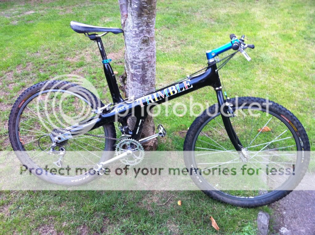

As promised full spec list as it stands.
Frame: 92 Trimble Inverse 4 (Suspension Corrected) 1698g
Fork: Doug Bradbury Manitou
Headset: Mountain Goat Roller
Stem: Ritchey Force Cro-mo
Handlebar: X-Lite 535 3 degree
Grips: ODI Mushroom "John Tomac"
Brakes: XT BR-M734 (RR) & Deore MT62 (FR)
Brake Pads: Koolstop Eagle II
Cantilever cable hangers: Shimano
Brake Levers: XT BL-M733
Shifters: XT M732 Thumbshifters
Front Derailleur: XT FD-M735
Rear Derailleur: XT RD-M735
Cassette: HG70 12-28
Chain: Sram PC890
Cranks: Cook Bros Racing (with one-off spider)
Chainrings: Pace
Chainring bolts: Tioga branded
Bottom Bracket: Syncros Titanium
Pedals: Shimano SPD PD-M737
Hub Skewers: XT M730
Rims: Araya RM-395 Team
Hubs: XT M730/M732
Tyres: Panaracer Smoke/Dart (Re-issue)
Saddle: Selle Italia Flite titanium
Seatpost: Use Alloy
Seatpost Binder: Steel/Alloy 3DV (no name)
Weight: 25.4lb

Looks a smaller frame than mine col
The hooked drop-outs are different , maybe sus corrected , brake bosses are different too
Told mines a 1989 , no 260 ( iirc) of approx 500 , I have a set of those forks for mine but need a 1" steerer for them
Or 1" steerer to fit my rs1's
