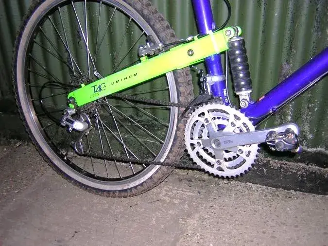

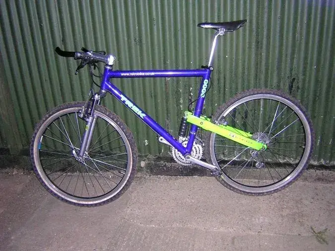

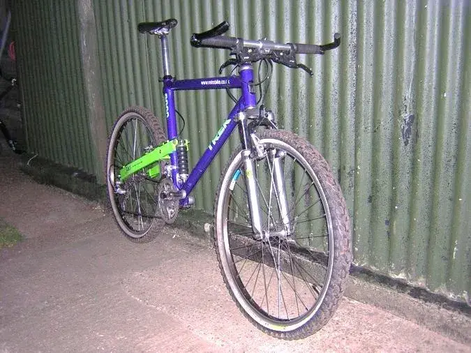

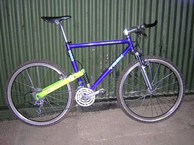

Got the build finished tonight.
Brief spec is as follows:
DX rear mech, cranks, cantis and hubs
XT shifters/levers and front mech
Kalloy seatpost and bar
KORE stem
Vetta saddle
WTB Velociraptor tyres
Havent ridden it yet, so report to follow probably after the weekend.
