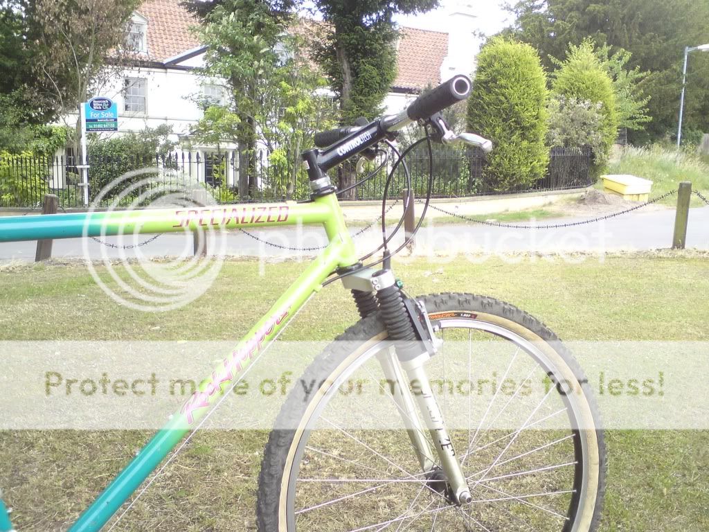

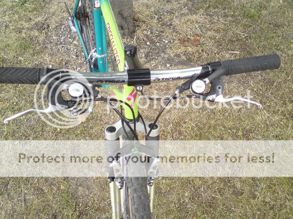

1992 Specialized Rockhopper Comp
Got to be the first bike of yours I've seen without an 'ano bolt kit' fitted :)
Are they the thoroughly modern Tioga bars from On-One/PlanetX site ?
First time for me i recognize a Specialized fork. I love it. Any more info on that? I would put on the green chill pills instead of blue ones.
Looking forward to see some updated pics.

There might be some detailed internal pics soon if all goes right (or wrong :lol:) Assumption is they are pretty similar inside to the MAG20/30 fork.

It does match rather well doesn't it.
Can we give it a try when I bring the bike round :wink:
No its not Ben the Dale hasn't any ano either :wink:
Yes they are the On-One Tioga bars, £10.00 seemed to good a bargain to miss :)

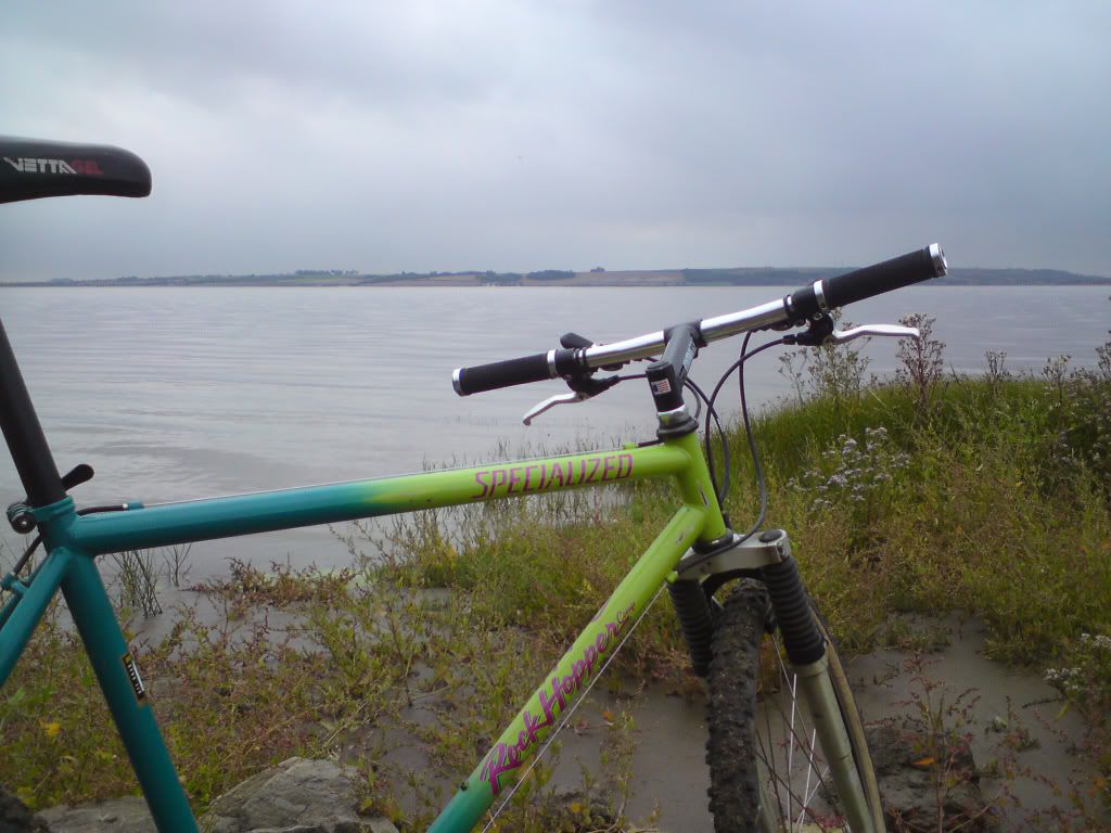

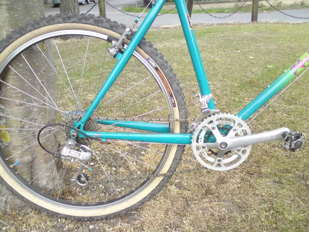

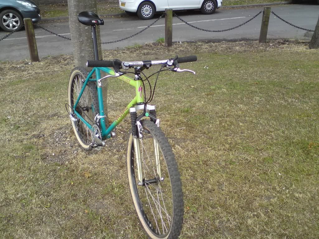

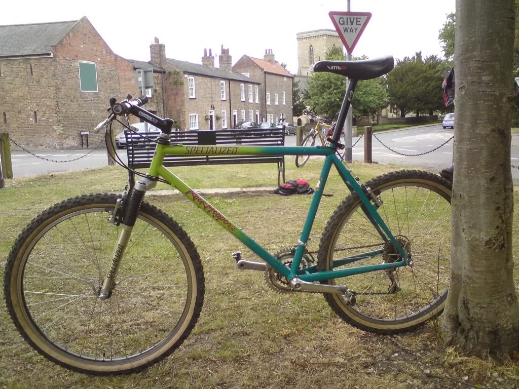

I took this out for its 1st ride this morning and it performed very nicely apart from finding out that I hadn't torqued the cranks up properly and having both arms come loose miles from the car :evil:
Fortunately Mrs Fluffychicken came to the rescue by driving out to us with a 6mm allen key :D
All done now apart from a set of lock on grips that haven't arrived yet and and a nicer pair of wheels when funds allow.

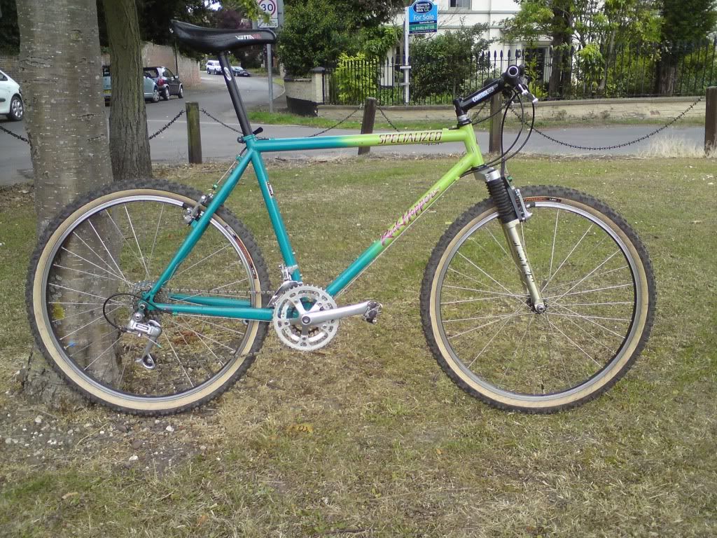

Frame: Specialized Rockhopper 1992
Fork: Specialized Future Shock
Headset: Deore Dx
Stem: Controltech
Handlebar: Tioga
Grips: Lock on
Barends:
Brakes: Deore Dx
Brake Pads: Ritchey
Brake Cables: Jagwire
Cantilever cable hangers: Onza Chill Pills
Brake Levers: Dia Compe SS7
Shifters: Deore Dx Thumbies
Front Derailleur: Deore Dx
Rear Derailleur: Deore Dx
Derailleur Cables: Shimano
Cassette: HG?
Chain: Sram
Cranks: Deore Dx
Crank Bolts: Srp
Chainrings: Shimano SG
Chainring bolts: Srp
Bottom Bracket: UN54
Pedals: Spd's
Hub Skewers: Shimano
Rims: Ritchey Vantage Comp
Hubs: Deore Dx
Nipples:
Spokes: Stainless
Tyres: Irc Mythos
Tubes: Specialized
Saddle: Vetta Turbo
Seatpost: BBB
Seatpost Binder:
Weight: 27lbs approx
