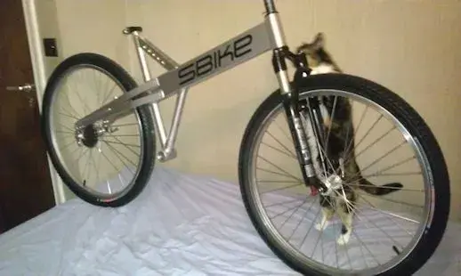

Managed to score a 2007-ish RS Reba Team fork. The fork had an overhaul last year, but It'll get another one anyway. I plan on taking it apart and repainting it to suit the frame (which will be white).
Due to the Reba's air pressure system, I was able to play around a bit with it and lower it to the 50mm of travel I wanted.
The geometry and appearance were checked and approved by my personal quality control team.
