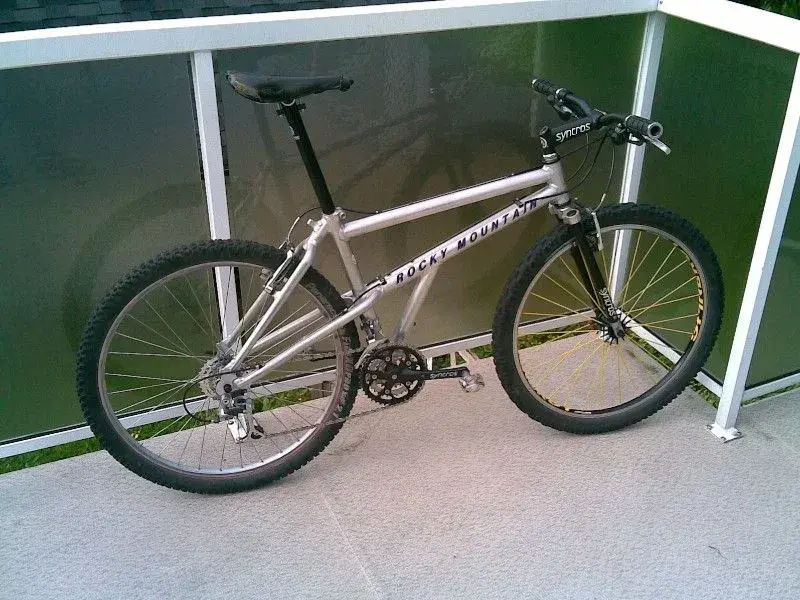

A lot of changes are expected but here's how she sits so far...
early 90's Rocky Mountain Experience
Syncros seatpost
Syncros stem
Syncros forks
Syncros cranks
Yeti ARC carbon riser bar
XTR Rapidfire shifters
XT V-Brakes
XT V-Brake levers
Shimano PD-M515 SPD pedals
Avocet O2 Ti railed saddle
FSA steel square taper BB
Spinergy Xyclone front wheel (28 PBO fiber spokes)
Mavic 231/Deore LX rear wheel
SRAM PG-850 8 spd cassette
Shimano chain
XT/XT derailleurs
Deore LX chainrings (steel inners, alloy outer)
Panaracer 2.2 Dart Soft Condition steel bead front tire
Panaracer FireXC Pro (Japan) kevlar 120 tpi rear tire
Generic tubes
Oury Lock-On grips
Shimano threaded headset (cheapo model with low 33.5 mm stack height)
24.51 lbs as she sits. I should be able to get her to 23 lbs by swapping tires, tubes, wheels and bottom bracket.
It has a really old school Syncros seatpost with a long extinct top clamp and I wonder if I have it facing the wrong direction. Why? The rear bolt seems perilously close to the bottom semi-circle.
Can any other original Syncros seatpost owners comment?

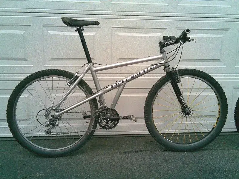

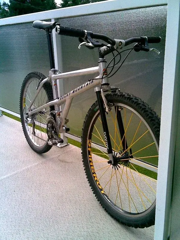

a few more
