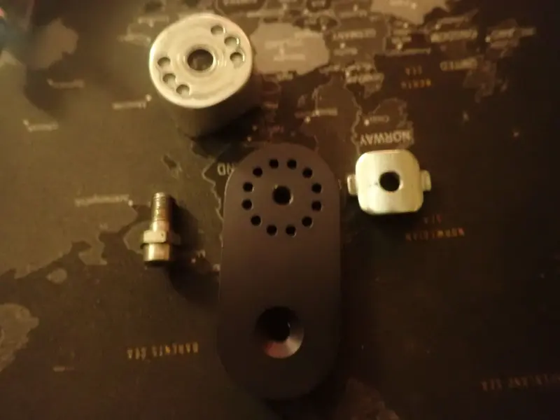

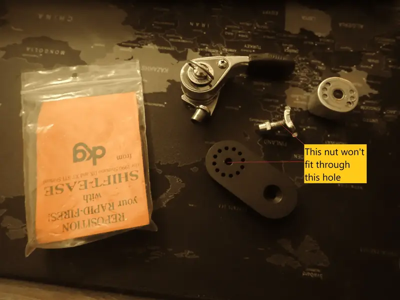

Hit the first of probably several brick walls.
I bought some suntour thumbies in order to use the towers to mount XT shifters on the DKG's, I already have some custom made band clamps on the way from a kind Spanish RBer, however today I discovered that the holes in the DKG's through which the screws need to attach to the tower clamps are too small, or the tower clamp nut holes are too large, either way I can't use any of it. :oops:
It looks like I bought the wrong kind of suntour shifters with the wrong kind of towers, so if someone could tell me which exact model of shifters I need to get that would be great, the towers are fine, it's the damn nut that fixes the clamp to the tower that is the problem.
It's not the end of the world, I'll still get the bike riding by next weekend even if I have to use barcons or the suntours with their new drop bar compatible band clamps, however before I take the bike up a notch to full XTR I'll need the right tower nuts.
Hi and heads up for the nice build idea!
The Dkg are made for the first two Generations of XT Trigger shifters,
If you really want to use the Xt-ThumbShifters keep searching for wtb multimount perches.
Otherwise Multimounts can be also made to work with early generation Suntour shifters.. but there is a baseplate modification needed unless you use the LD-2800.
WTBs even earlier sausage links (adapter plates) for suntour towers in use with their friction shifters can be easily reproduced.
