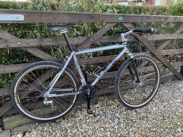

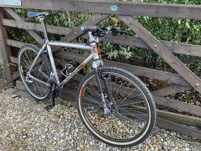

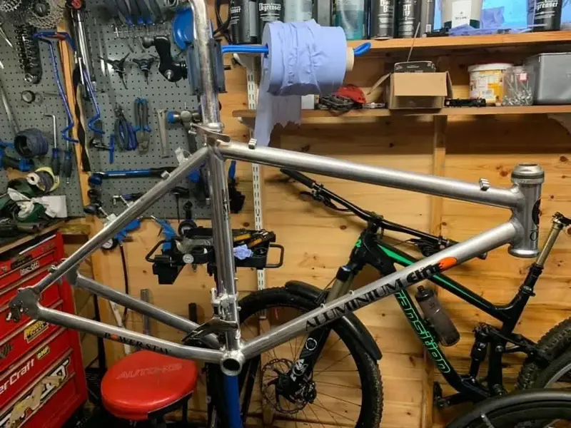

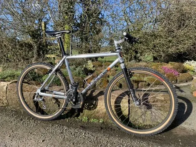

As they seem to be relatively on trend at the mo and also as I found myself project less in January I managed to pick a real nice Elite frame, all polished and ready to go.
Jumping forward a couple of months and it’s all built mainly from parts that I’ve had in “stock”.
I've gone down the DX route as we all love it and as anybody the knows me I have a thing for RC30’s so there in situ 👍🏻👍🏻Bucking the trend of having everything polished I’ve kinda gone the other way and apart from the frame nothing is polished.
I’m very pleased with the end result, hope you all enjoy

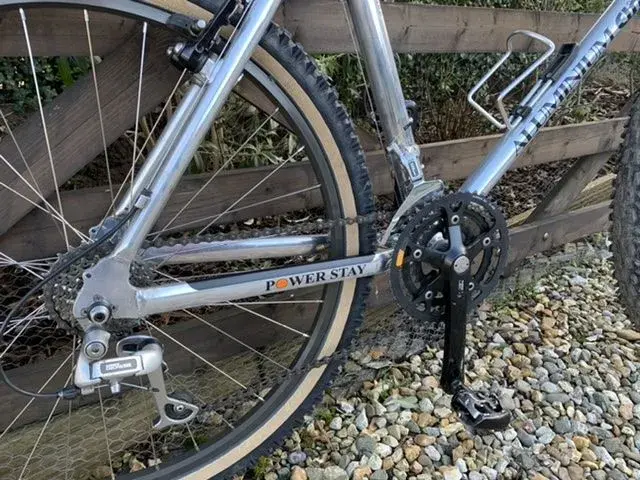

Frame: 1992 19” Orange Elite
Fork: Pace RC30 Mk2 in black
Headset: Tange 1 1/4
Stem: Ali Stalk
Handlebar: Pace RC130 Black
Grips: Orange Mushroom
Brakes: Shimano Deore DX BR-M650
Brake Levers/shifters: Shimano Deore DX ST-M071 STI
Front Derailleur: Shimano Deore DX M650
Rear Derailleur: Shimano Deore DX RD-M650
Cassette: Shimano HG
Chain: Shimano HG
Cranks: Shimano Deore MT60 Chainset 175mm
Chainrings: SG-X
Bottom Bracket: UN55
Pedals: Shimano SPD Pedals PD-M525
Hub Skewers: Deore DX SQ-M650
Rims: Mavic M231 CD
Hubs: Shimano Deore DX hub FH-M650 HB-M650 in Black
Tyres: Panaracer Smoke and Dart
Saddle: Flite Ti
Seatpost: Kalloy

Mighty collection Davo, will fit nicely amongst the fruit bowl. Yes the Pace definitely go better than a silver alloy fork. Anyway keep up the great builds buddy 👍😎
