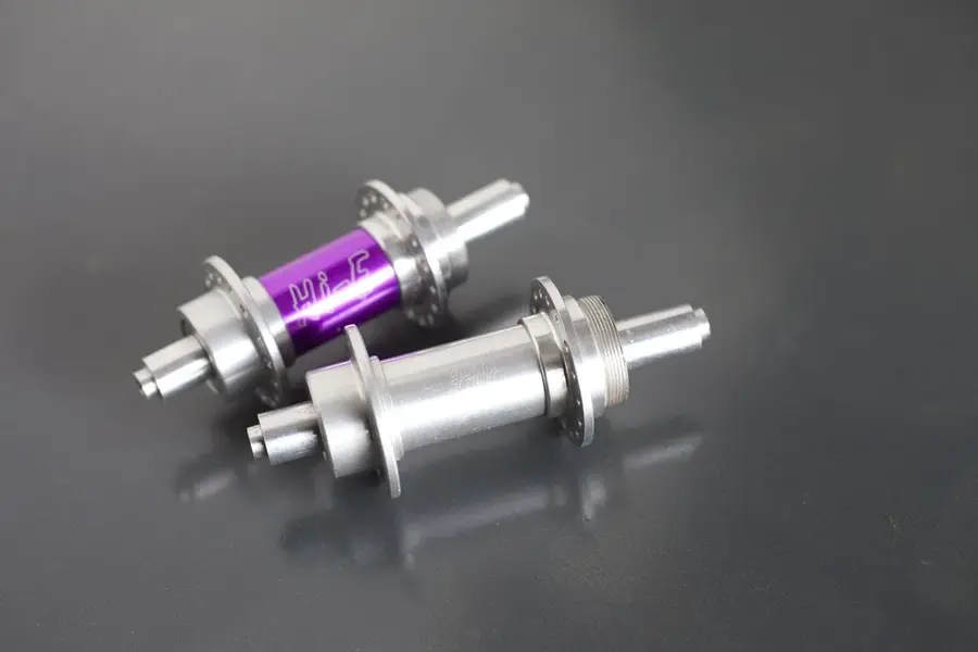

that's the rear one, only need a front hub and 2 rims...

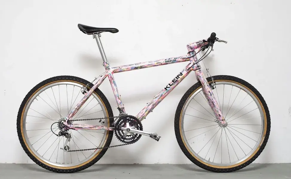

the silver rear hubs is laced in to a Mavic X517, for the moment, NOS Campagnolo freewheel 12-27 added, Ritchey Z-max WCS 26x1.9 fitted, result....8,84 KG
why not try to make a 2nd UltraLight with al the spare parts.....
without some titanium already on 8,97 KG, these bikes loose weight easier then their owner :facepalm:

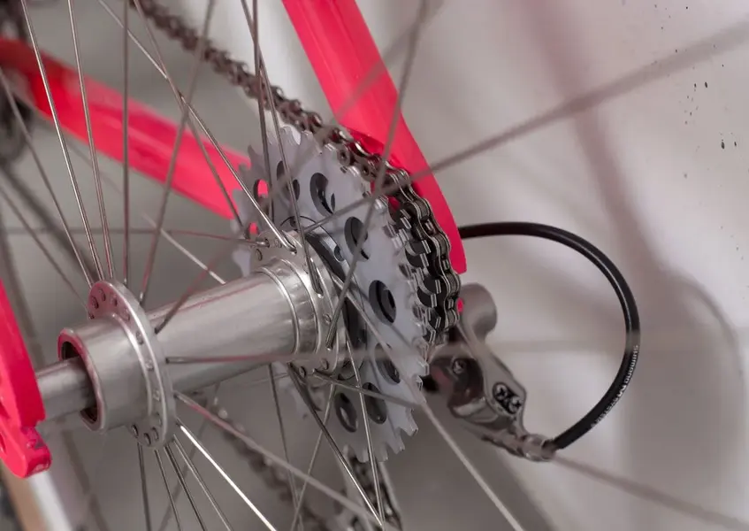

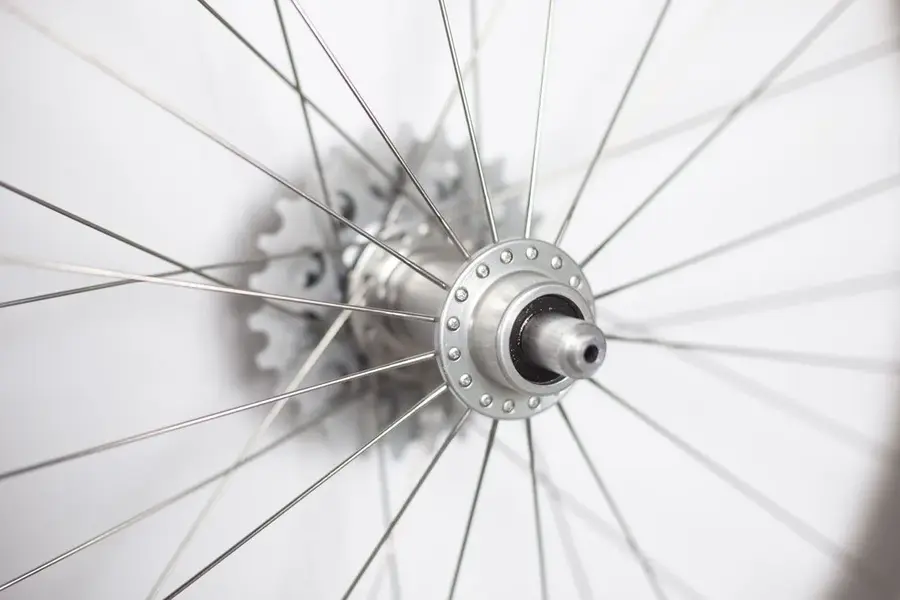

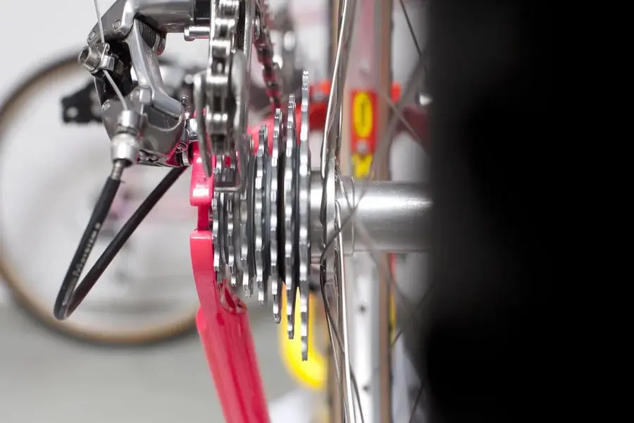

mmmmmm, i think i need an other Hi-E hub :facepalm:
compared to the Ringle which was in before, the freewheel "moved" 4 mm more outwards, not enough space anymore for the chain to do his thing.....
Anyone with a Ultralight who can share a picture of their set up?
Pretty big gap between the freewheel and the spokes/flange :roll:

Re: 1992 Klein Adroit Backfire
I told you about this problem... I ran into the same issue on a test fit I did. I added spacers under the drive side axle end cap to move it outboard.
Double check your axle spacing.
I also sanded down the cogs/spacers on my campy FW to reduce the overall height and then I added 2-3mm of spacing to the hub.
Maybe have to start sanding :wink:
Thanks!
@Jon, it did with my Ringlé hub, but not at the moment....
