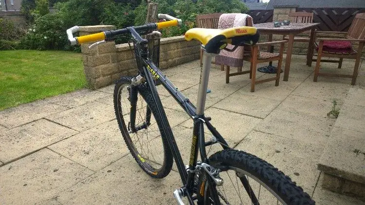

Just bought an early, guessing 1992, Jamis frame from the bay, looking a lot like a Diablo, but decals missing. Seller states that seatpost won't go down more than 2 inches as he thinks there is a snapped off seatpost in there. Bit of a gamble, but must be someway of removing that bit of post? Acid? Any ideas?

Well its arrived and looks like a caustic soda jobby! About an inch of post stuck 2 inches down the tube! Some slight distortion of the tube where someone has tried to prize it out!

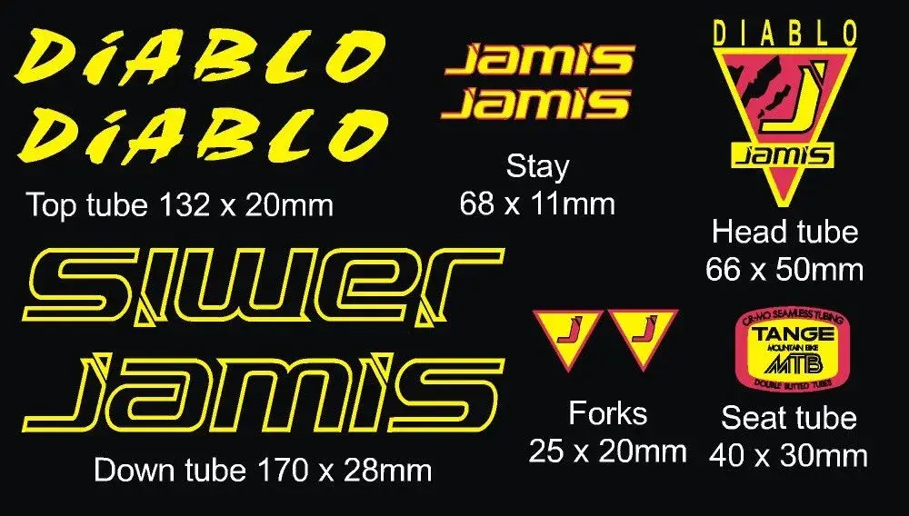

Ok its done! Took me three goes with the caustic soda. I don't think the solution was strong enough the first couple of times, but the third time it disintegrated the rest of the post in 15 minutes! lol. Its taken some of the paint but is going to the powder coaters soon. Waiting for some proofs from Gil for the decals first, then measure where they go. Will post some pickies when I get a chance to reduce their size! lol
