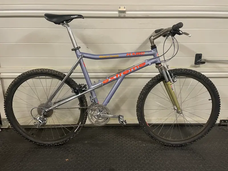

This is the steel rear triangle/aluminum front triangle mutant from 1992 I believe (couldn't find a MTB catalog to verify [lots of BMX catalogs out there but no MTB editions], but it seems to be the consensus of the google searching I have done). The frame did not come with a fork and I am trying to determine the appropriate axle-to-crown length to get: 410mm or 440mm. Any advice/input/thoughts would be very much appreciated!
John
Would most likely be around 395 at that time - 410 might work okay, 440 would definitely be too much.

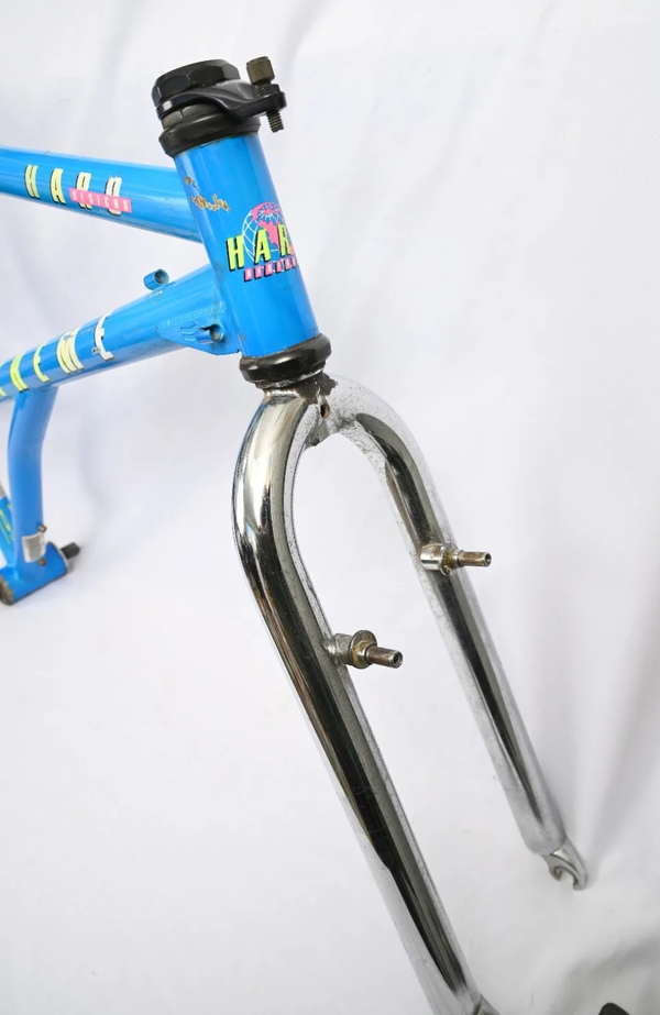

This rigid fork was nice too because it had a design with straight legs. At least in the 1991 Extreme it was using Tange tubing an had a axle to crown height of 395mm.
Picture of the 1991 version, where same rigid fork was still chrome-plated.
