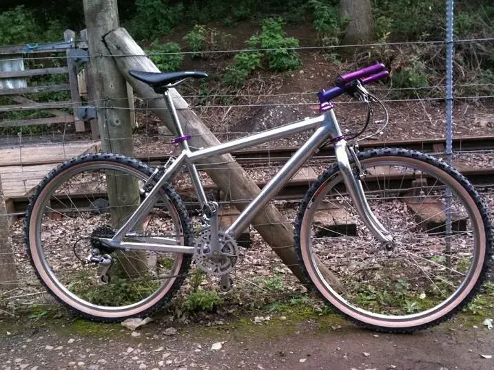

I have red paint left over in the fork dropout think it used to be red..... Anyone?
The cranks are suntour comp md and alegedly original, which would indicate a m1000, but are the framesets identical throughout the mxxx line?
Getting all antiques roadshow, which is worth more a mxxx 3.0 frame or a beast of the east?
I don't know... Not exactly a Beast like bottom bracket height. :?
Still a bad-ass bike though. 8)

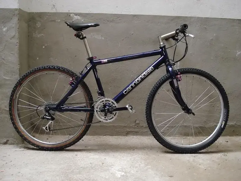

As for price, there isn't enough of a value difference, in my experience. Condition is the determining factor for old Cannondales, value-wise. Yours is in great shape, so there you go.
Although if somebody wants to tell my my 93 Beast is worth millions, well then I'd be more than happy to listen. :lol:
timdrayton1":2cvm1v4r said:
anyhoo frame number is 51502926160 on the right stay there is B1-039
I'm sure… sorry.
For reading your frame number :
5 (rear drop out spacing : 135mm) 15 (the size of the frame) 0292 (your frame was product in february of 92)6160 (sequence number).
So your frame is a small 15" classic 3.0, not a" Beast of the East" :wink:
The smaller size of the Beast of the East frame was 18", but if you consider the highest BB, the seat tube seems to be a 15". Other difference between the 2 frames : On a BotE, the seat stays are weld in the same level. On the small 15", the seat stays are weld higher than the horizontal tube.
So, your bike can't be a M800 or a M600, the only 2 bikes sold with a Beast of the East frame.
But good news : your bike should be more stable in downhills, because your gravity center is lower :wink: . I've got a 15" frame too, and I ride it with a lot of pleasure :D

All C'dale from the SM400 to the SM omega have the same frame (except the One or 2 bikes with the BotE frame). Only the groupo changed.
So, a classic level frame (yours is sloping because of the small size) equiped with suntour XC comp MD was M1000. With shimano XT, it was M2000…
On other hand, the classic top level and the BotE sloping frame were both 3.0 series frame :D
