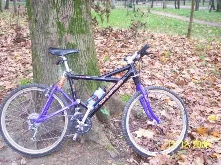

I also needed to service time ago the delta v fork, there were some places specialized in headshok, you can google it, but I found them very expensive, and anyway you have remove the fork and send it...So I visited the shops in my city, finally in one I found an experienced mechanic who serviced almost for free it as he was really happy to touch the glorious Delta V2000. My advice is to go to your local shop and if possible look for a mechanic over 30's year old..
These forks needs some lubricant outside from time to time, mine works really smoth now.
