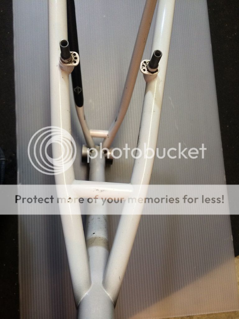

To confirm the dropouts are correct for a '92-93 version, I have owned a 1991 frame with similar (now belonging to Ratbane on here), although these were Shimano stamped ones. I wouldn't worry about the mudguard eyelets either, I believe owners could specify choices of braze-ons as well as colours. My 1995 Hot is equipped with them for example. I am yet to see any Hots with rack mounts on the seatstays though, but never say never :)
I totally agree, there's no doubt in my mind that it's a Hot (I have stated my interest in case of a sale :wink: ) just trying to figure out some of the anomolies about the frame, the '93 decal's, the Tange decal, geometry etc. Also I can see now your right about the mudguard eyelet's, no mystery there.
However I do stick to my previous statement about the paint job (rear triangle). Still look's like a home job to me, the white just isn't solid enough, bit patchy in some area's, just doesn't seem the quality you'd expect.

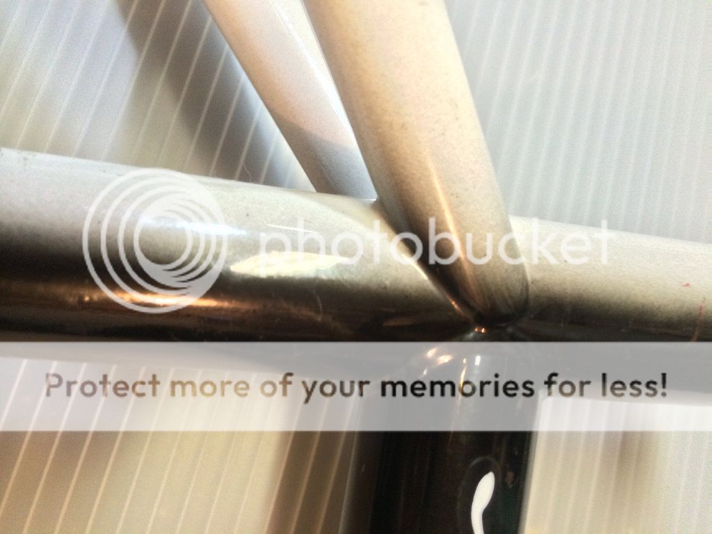

As far as the paint, there may be some confusion. As I wrote before, it's ALL painted white, then the front triangle was sprayed black, and then blended/oversprayed/faded onto the chain/seatstays. So if the rear triangle was repainted, the front triangle was repainted, too. It's black over white, not white over black.

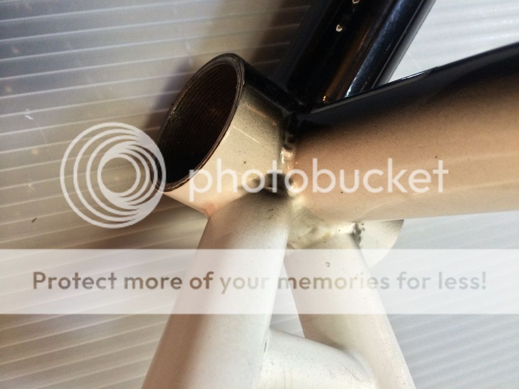

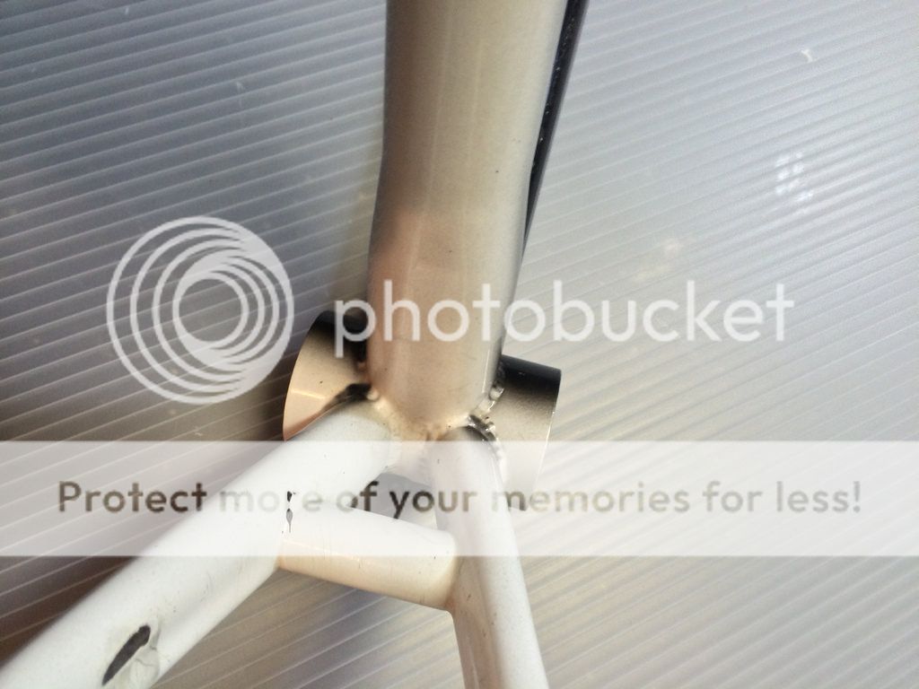

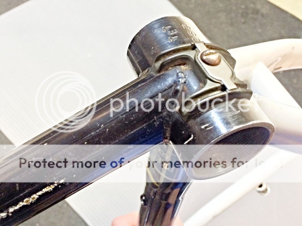

I took some more pics, and really tweaked the brightness/contrast on the one of the downtube/BB to show the splines in the tubing, so don't say the paint looks funny there! Black doesn't show shadows too well... Also note the tapered oval seat tube.

Mmmm, absolutly love the splined downtube's on these frames! Interesting you say the frame was painted white and than the front was painted black. Is this because beneath the black (through the chip's etc) you can see a white undercoat? I'm no expert but I'm guessing this is the primer which the frame recieved before the top coat. Many of my Kona's have a coat of white underneath the top coat. And if you look at the bottom bracket shell for example the white just doesn't seem solid enough (bit patchy) to be a professional job. Don't get me wrong, not looking to stir thing's up here, just interested :D And regardless of the paint work, it is still a beautiful frame :wink:
So the whole bike was primed, and it could be a light color primer. The seat tube and BB are primer, then white, then black. So maybe the bike was primed white, then the rear half was painted white, and then the front half was painted black?
Still not sure about the DIY and "patchy" comments. Here's an example of the BB area. Any black area on the white is black paint OVER the white paint, over the primer. Not half-applied, patchy white paint on black. Confusing in pics, but makes sense in person.
Maybe they had a new guy in the paint booth that day?

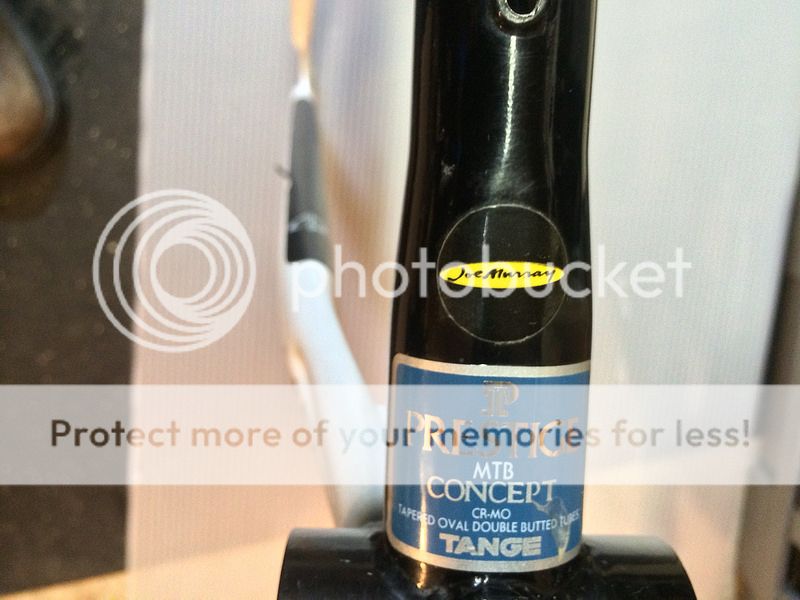

Looking into the seat tube tange decal placement, it seems there was some type of sticker mid-tube for '91-'92, and then the badge was added higher up for 1993?
1991:
1992:
1993:
Was '91-'92 still the TBG sticker on the seat tube? Moved or lost entirely in '93?
