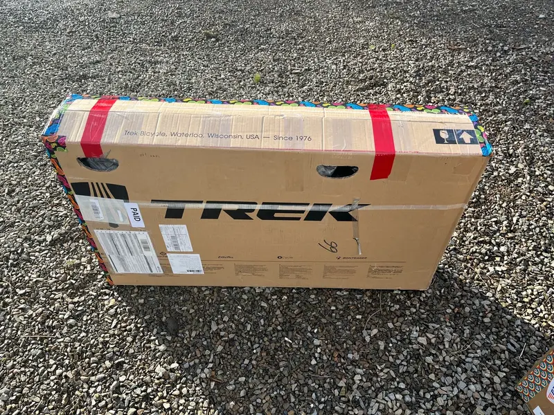

BUT… The temptation was too much for me to ignore it. A little work bonus money came in unexpectedly. So what better way to spend it. I contacted the seller and it was still available. Decided to pay the full asking price (approx. $1300) and import it to UK (Aberdeenshire, Scotland). The seller was great to deal with, another retro enthusiast with a nice collection. Lots of details & photos were shared. With shipping agreed, and with my payment made = the nervous wait started as the Trek 8900 made its way from the USA to Scotland. Not in one box, but in two boxes! Due to shipping constraints = not cheap (approx. $280).
The good news = 7 days later, both boxes arrived in Aberdeen courier depo safely.
The bad news = both boxes had import & tax charges to pay before releasing the boxes the last 20miles to my house. Leaving me another £380 to pay (ouch). I knew the risks, sometimes you don’t get hit, other times you do. But I bought it knowing I would probably have to pay up. So I did and boy was it worth it!
As I unwrapped the boxes, parts it became very apparent this Trek 8900 was in amazing condition! Not quite but almost NOS. I loved the handwritten note as I opened the first box. So, I’m dedicating this thread to show case the full strip down, service and rebuild I have just completed. Bare with me as I upload all the photos / story during the next 24hrs. You will get the full rebuild. Enjoy!

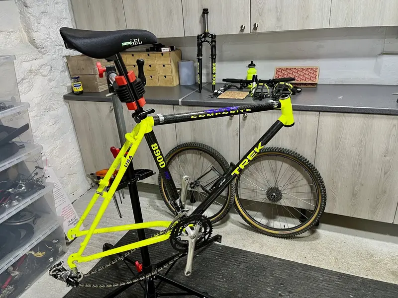

First job, unpacking and fully stripping the bike… straight away I decided I would ditch the onza bar ends and replace the original foam grips which were tacky / rock solid. Also the 2nd gen Smoke/Dart tyres were nice but I wanted the older 1st gen Smoke/Dart tyres. Luckily, I had a decent lightly used set in my collection to use. Usually I replace all the cables (inner and outer), but it became apparent they were immaculate and had the right text say “Suntour Accushift” on the outers. Removed with care so I could reuse them = had to save some money somehow (lol). Lastly the RockShox out ATI books were not going back on, as I prefer the raw look without.

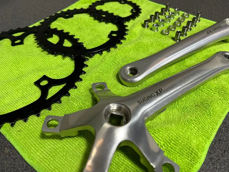

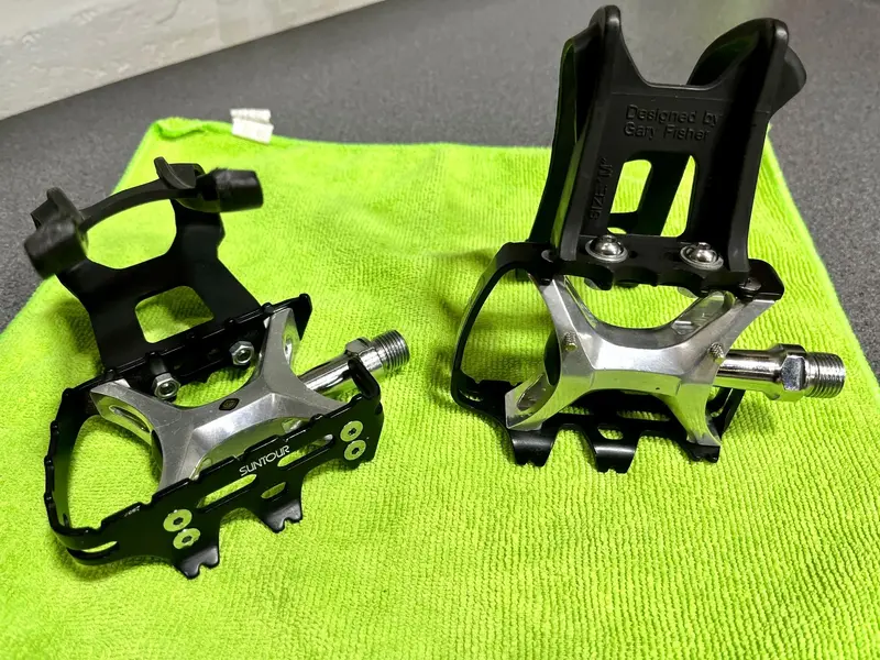

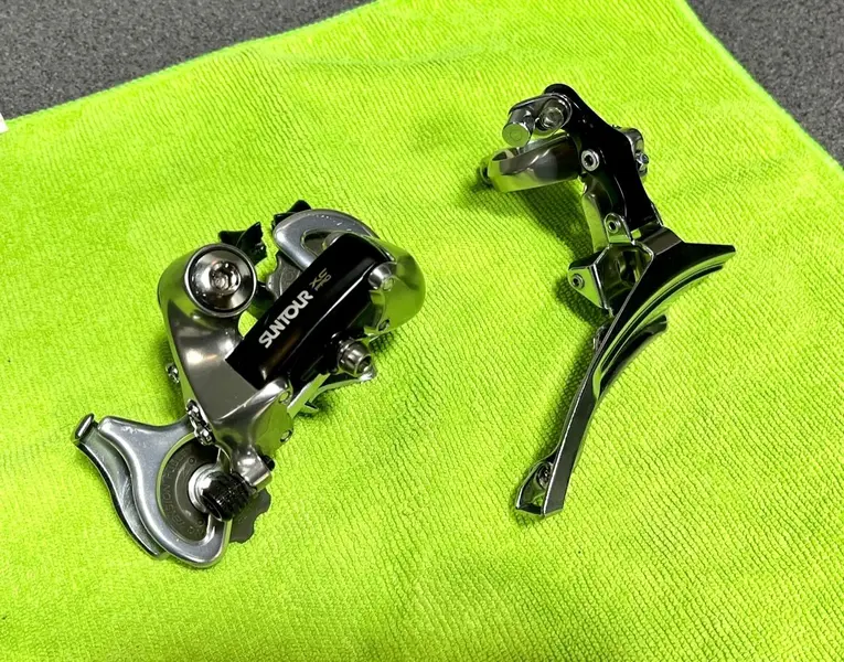

The next job is always the best bit, over the course of 3 weeks I carefully unbolted every single part. Cleaned, then polished and serviced items as I went. I'm an ex bicycle mechanic of 30yrs and used to be a Rock Shox service technician. Got the Rockshox certificates somewhere in the attic = lol.
Not everything was perfect. List of things done:

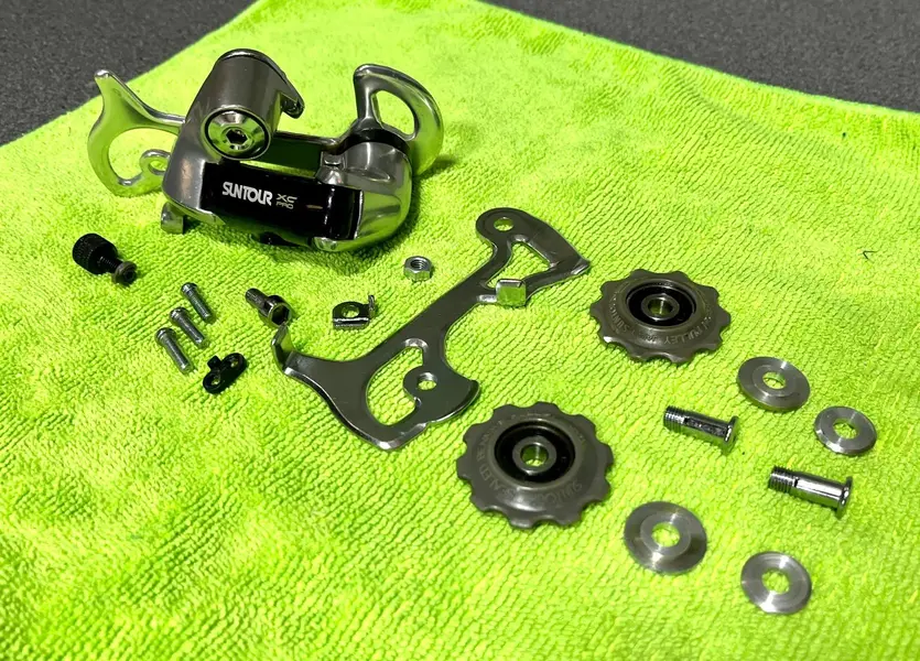

Suntour Por XC mechs striped, they were sticky from sitting so long, cleaned and serviced.
