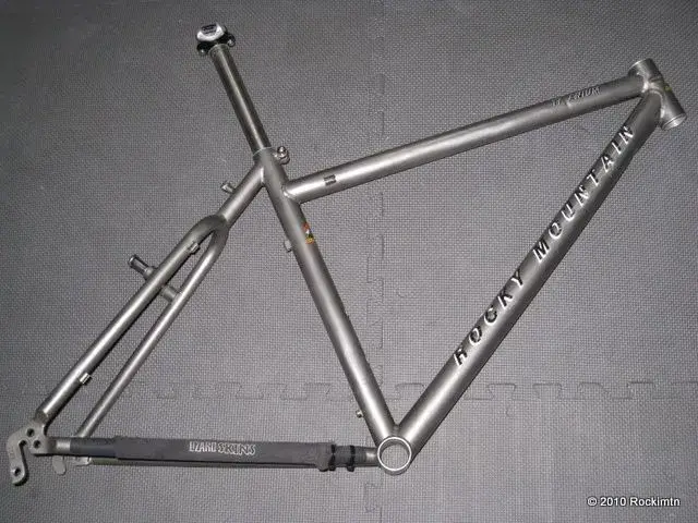

Try to get that down-tube dent sorted... it's just in the right place to fold the down-tube if you have a heavy front end impact!
Lovely frame though. Hope you can get it sorted.

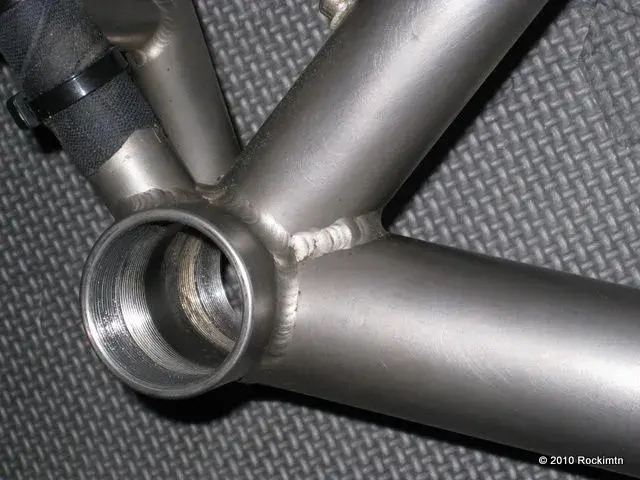

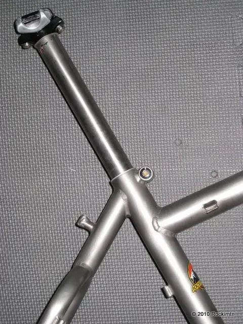

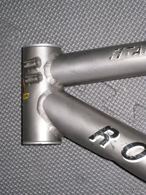

anyhow, morning breakfast today was citrus cleaner and titanium dust to give the old girl a good clean and massage with a scotchbrite pad. tidied up quite nicely. did notice the welds aren't as neat as on the Merlin however.

seems my 27.0mm Dean Ti post fits the frame, so i guess i'll be taking that off the market. ;)

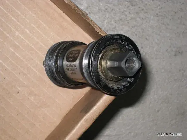

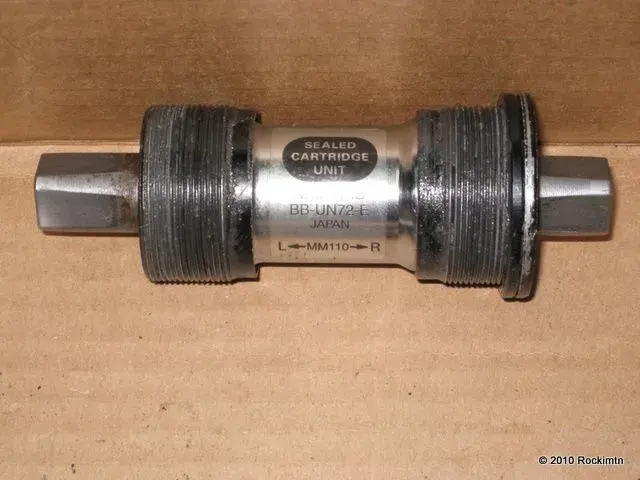

strange bottom bracket i found in it. it's a UN-72E. it has a spacer on the drive side and also some sort of collar on the axle. i thought it was shot as it didn't spin at all, but once i removed one cup, it was smooth. maybe the cup was press on the bb too tight???

Pity it's suspect and you're so far away, I could just do with a UN72E! Puzzled why it's in this frame though - is it a 68mm bb in a 73mm shell? Even if so, it would be a bit tight on the non-drive side, surely?

Figured out the E stands for E-plate mounted front mech. Believe it's 68mm on the cup but I'll confirm. I'll test it out a little more tonight when i get home. I'm pretty sure it might have been just the cups being overtightened onto the bb forcing it to stick.
Not sure what you mean about it being a bit tight on the non-drive. Can you explain?

how would one go about trying to fix it? i was going to just build it up and ride it. i've read about "rolling" steel tubes to get dents out. is this possible with Ti?
