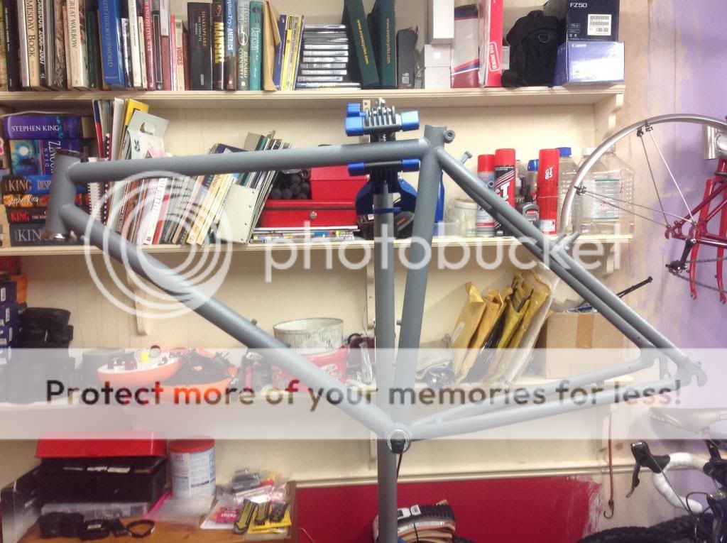

Update time.......a big thanks to stu for his efforts. A bit of packing and posting, and some time in his painting classes and I'm left with this.......
.....it looks great, and once I've had the forks/stem/bars powder coated in tangerine orange it will all come together and look stunning.

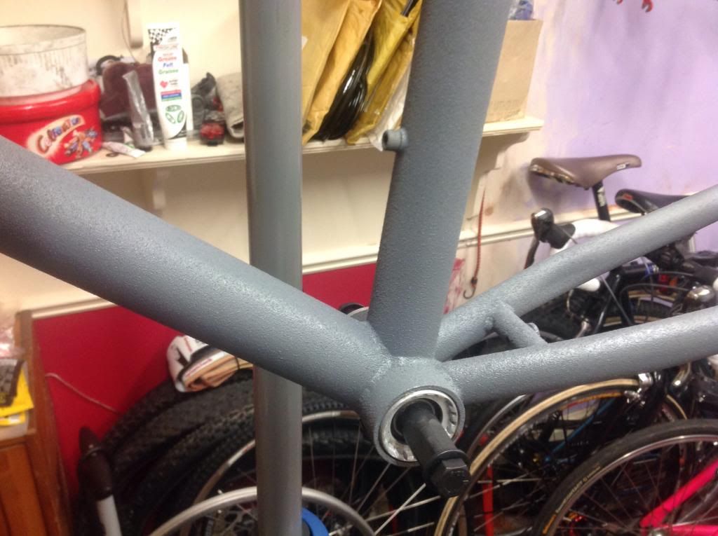

.....the finish is best described with a picture.....
.....the texture is that of relatively coarse sandpaper. It does however leave me with the problem of adhesion of graphics. I didn't pre-order a set and waited until I had the frame back, and knowing the problem with standard zolatone and reproduction stickers I doubt they will withstand the onslaught of a muddy life......has anyone else overcome this issue?......

Well Daz it will look great when it is built. It is very difficult to re create that finish, trying to get equal coverage on a frame is not easy due to the way the textured paint naturally wants to travel downwards as it is atomized, plus zolatone has white specs in it, you suffer the same issues trying to recreate that. Daz if you can mark out exactly where the decals are going you could always flat that area with some 1200 wet and dry. This will create a slightly smoother area for the decals to adhere to, hope this helps mate :D

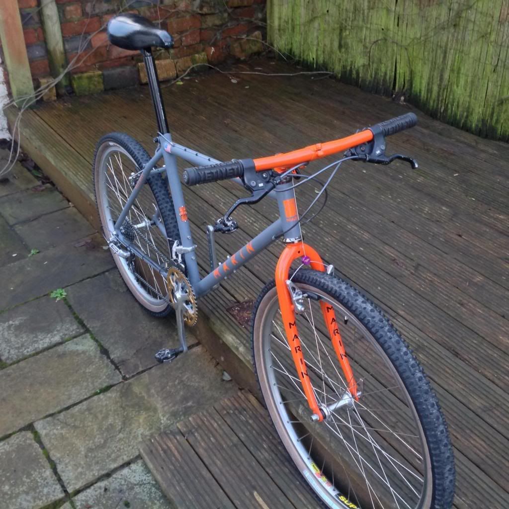

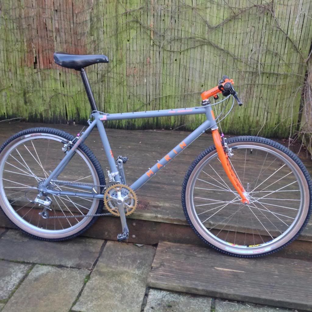

Bike finished over the weekend. It's been the most involved build I've done and I'm delighted with the result......
The repainted frame looks just great, thanks to you stu (slmracing) for your efforts. I'm glad it proved useful to your classes and I hope I've done it justice!
The stem was a karma offering from bryncrug72, many thanks again martin!........
The front end has been powder coated, detailing from Gil and basically a full strip and rebuild. I've gone right into it, even spending time tapping out the threads for the grub screws on the canti's......it all got a bit anal really!.......
It's largely original. Some changes were made by the previous owner who replaced the rims, and I have fitted new brake blocks and a chain (the old one lost half it's weight when I decreased it to have a proper look).
I've tried to stay true to its original character though, with a spot of purple ano just because.......to be honest I'm made up with it, it will be a shame to get it muddy!........ :D :D
