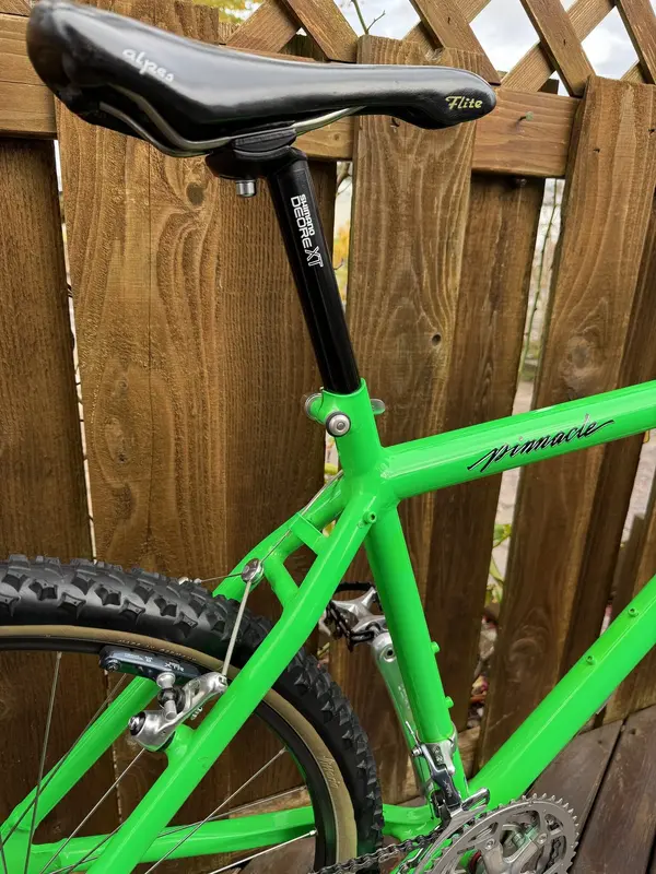

I also had a minty XT seatpost needing a new home and think it suits my new build better than the Syncros unit.

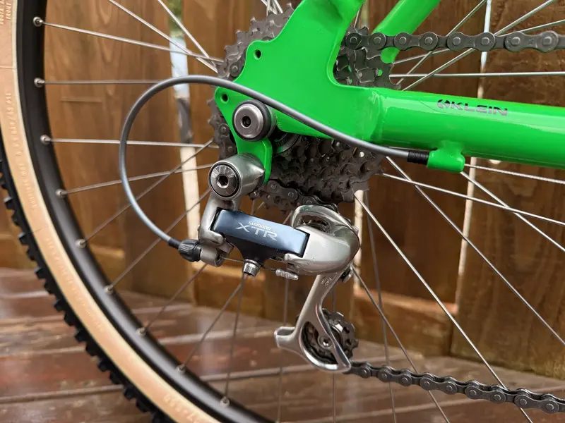

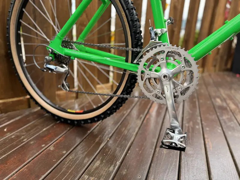

Iโ€™ve now got an almost full M900 build for the first time, only missing the headset & seatpost. Added all three XTR skewers, derailleurs, wheels, cassette, brifters, cranks & brakes.
I can always keep on eye out for a headset but really like the XT seatpost so itโ€™s staying.

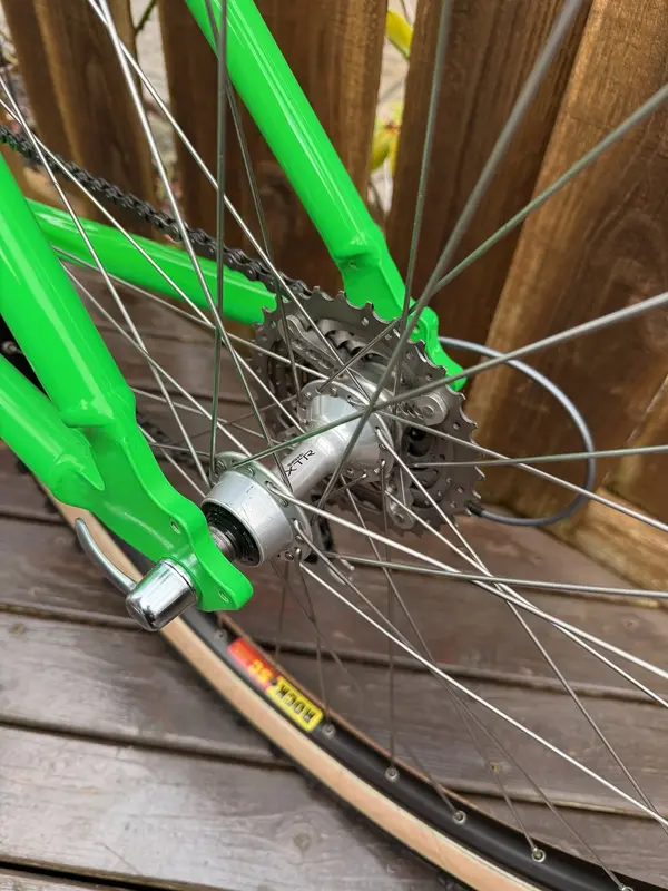

Managed to get ahold of some NOS Ritchey dark ano rims. These rims are a bit new (around 96โ€™) but have that good olโ€™ Mavic style profile I was wanting and paired to M900 hubs look fantastic IMHO. I generally prefer dark ano rims against tan wall tires. I think Iโ€™m getting better at wheel building with about three sets under my belt now ๐Ÿ˜Š

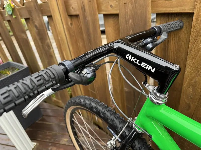

A couple other minor tweaks: Klein chainstay protector & proper ALL white stem decals (no black outline typically used against paint which is not black which came with my previous frame decal set)

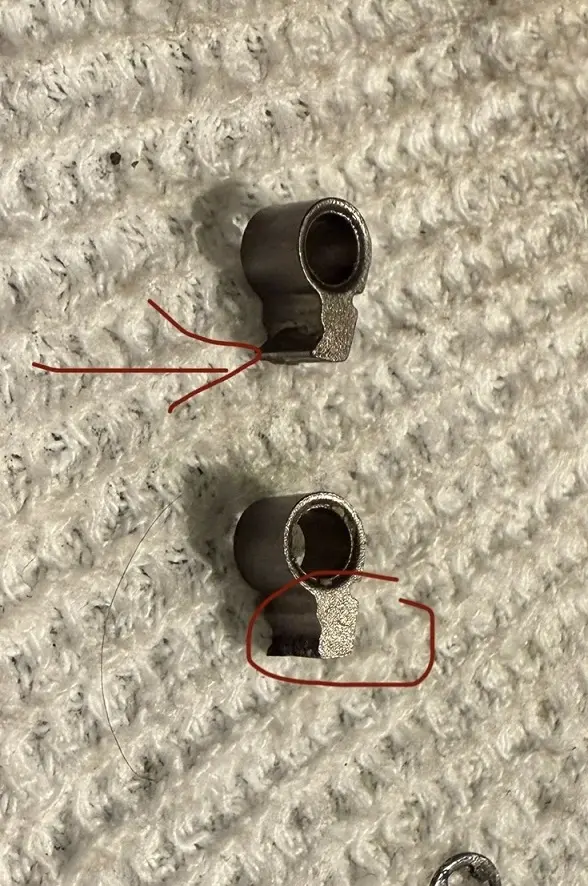

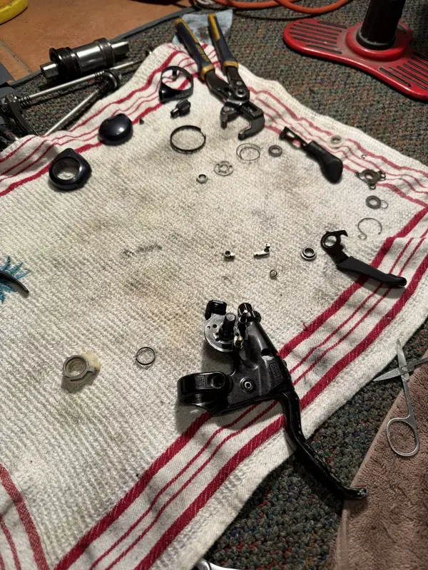

As with many M900 brifters 30 year old gummy internal grease required them to be fully rebuilt.
I had got the brifters back functioning using WD-40 and a toothbrush after removing the housings to scrub out the gummy grease. They felt like they could use some grease though so aided by Youtube videos took the plunge and completed a full rebuild of each shifter. I found a partially broken pawl in the front shifter. Luckly I have a set of DX brifters of the same era kicking around and stole a replacement part from it to replace the broken piece, see photo.

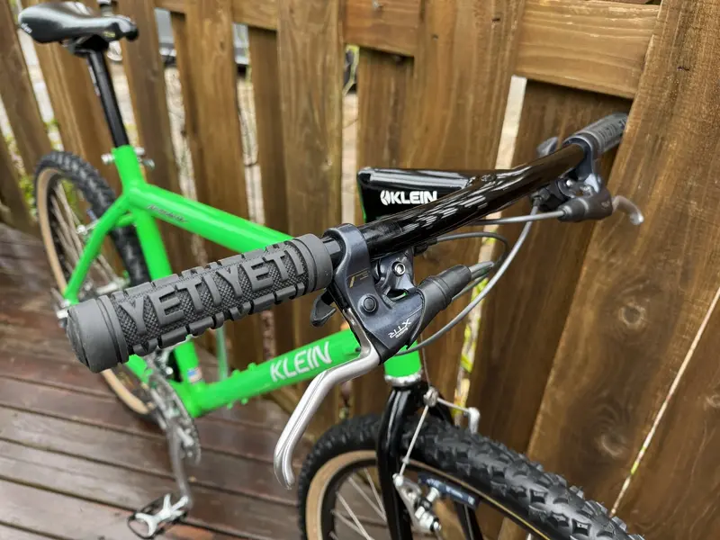

I have to admit that riding a full M900 drivetrain for the first time was very impressive. It doesnโ€™t just look great but really does live up to all the hype from BITD ๐Ÿคฉ

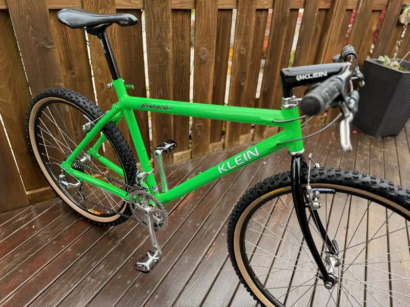

Updated build spec:
Frame: 1991 Klein Pinnacle, 19โ€
Fork: Spinner SCI
Headset: Campagnolo 1040/A
Stem/Handlebar: Klein MC1
Grips: Yeti Speed
Cantilever Brakes: Shimano XTR M900
Brake Pads: Shimano XTR M900
Brake Cables/Housing: Jagwire Grey
Brake Levers: Shimano XTR M900
Shifters: Shimano XTR M900
Front Derailleur: Shimano XTR M900
Rear Derailleur: Shimano XTR M900 c/w Carmichael Titanium Pulleys
Derailleur Cables: Jagwire Grey
Cassette: Shimano XTR M900 12-32
Chain: KMC
Cranks: Shimano XTR M900
Crank Bolts: Shimano XTR M900 Titanium
Chainrings: Shimano XTR M900 (46/36/26)
Bottom Bracket: McMahon Racing Titanium c/w SRP Bearings
Pedals: Suntour Superbe c/w XC Pro Cages
Hub Skewers: Shimano XTR M900
Rims: Ritchey Rock SC (32 Hole)
Hubs: Shimano XTR M900
Nipples: Brass
Spokes: 14g Stainless
Tires: Vittoria Freedom Duel HDC
Tubes: Generic
Saddle: Selle Italia Flite Alpes (94โ€™)
Seatpost: Shimano Deore XT
Seatpost Binder: Shimano XTR M900
Weight: 23 lbs 6 oz
