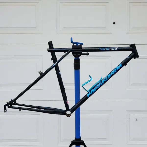

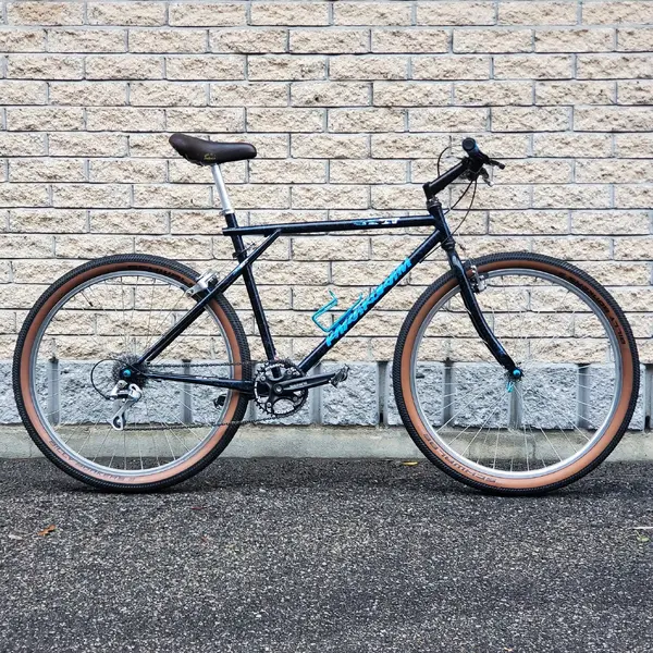

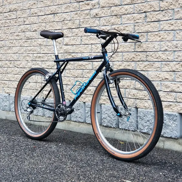

My next project will be this lovely 1991 GT Karakoram with the iconic "Blue Widow" paint job.
The guy I bought this bike from used it as a daily commuter for years, so it is far from spotless! Hopefully, it can continue to be somebody else's commuter for many more years after I'm done.

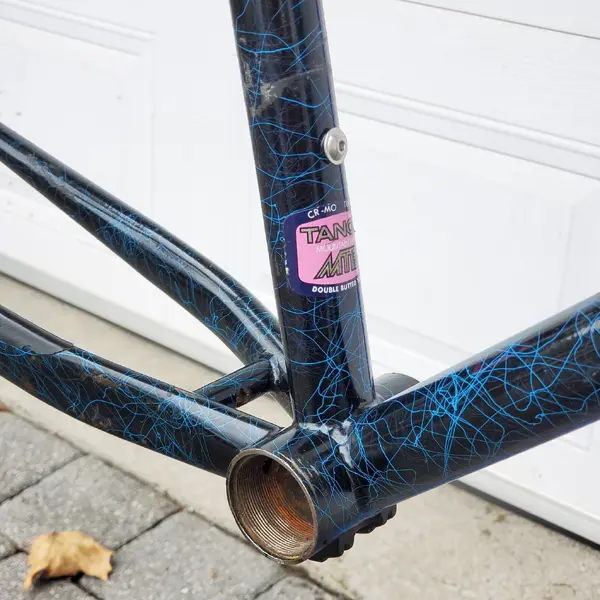

I already took the bike appart with no major issue. The only surprise I had during this process was the water in the BB shell making a rusty mess in my appartement (to my girlfriend's pleasure). Fortunately, the internal damage made by the water appears to be minimal.

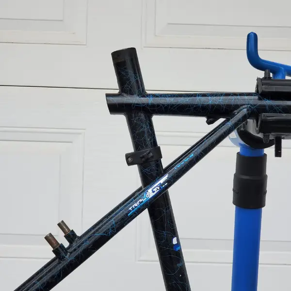

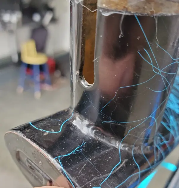

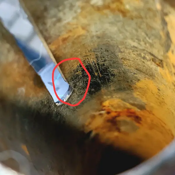

The frame inspection brought out another surprise... there is a tiny crack at the end of the seat clamp's slot (<1mm). It is tiny enough that I should be able to drill a bigger hole at the end of the slot where the crack is to remove it.

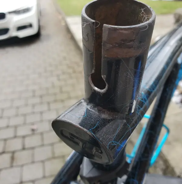

The first thing I did after taking the bike apart and have the inside of the frame dry off was to tackle the seatpost clamp crack.
It is hard to see in the picture, but it is there...
First thing I did was to drill a bigger hole to remove the crack. I finished by sanding with a Dreimel tool to have a smooth finish, reducing the chances of another crack forming.
Hopefully I was able to extend this frame's life a little bit!

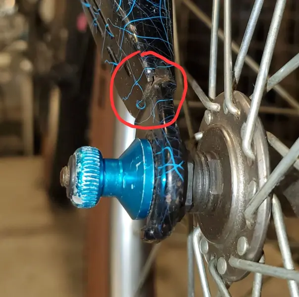

After taking it for a short ride, I cleaned it one last time before putting it on Marketplace. And that’s when I saw this :
The other side for comparison :
This bike might be a bit more beat up that I initially thought… How I found the microscopic crack near the seat post, but missed this big hole near the fork dropout is still a mystery! For now, I obviously won’t ride or sell it. Unfortunately, repairing the fork is a bit above my knowledge and the equipment I have. Replacing the fork would be the simple solution, but I would love to try to salvage the original fork. Where else will I find one with the same amazing paintjob!
And so, this ambitious project comes to an halt until I have the fork repaired. I'll post an update when things move!
It's hard to tell from the photo if the drop outs are pulling out of the fork or if the dropout itself is failing. Find a local frame builder to get an opinion. Personally having knowledge of numerous framebuilders, that is fixable & a black base coat of paint with blue splattered over isn't the hardest thing to attempt to replicate. This bike would certainly have a lucky history if you save it.
