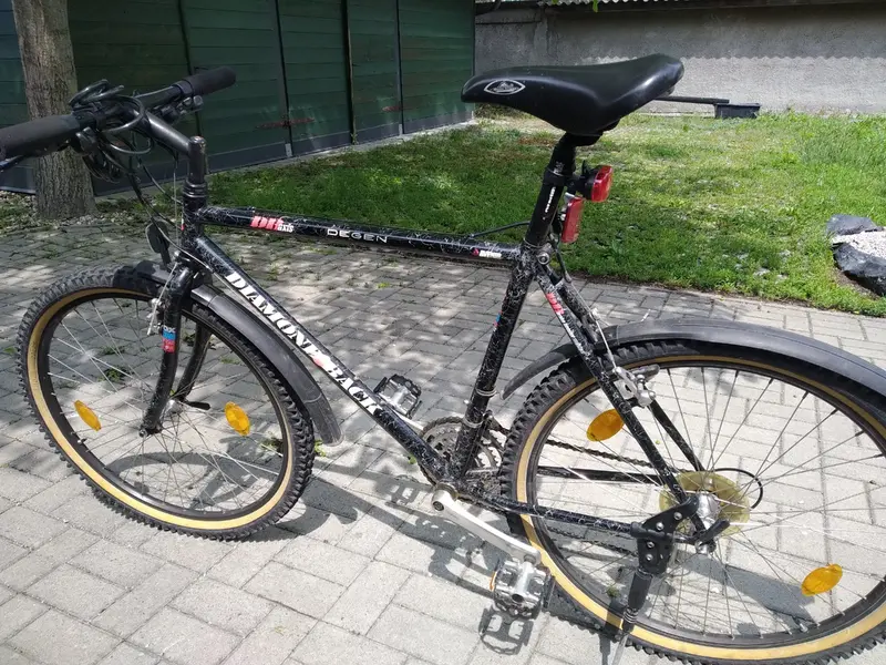

Hi all, I decided to sell on my 1991 axis bike. Iget in possesion of that last year. However I collect more racebikes than MTB's. Full XT Sholimano, even the brake pads are still the original. The mudguard was not authentic, therefore I removed this. The tyres panaracer smoke still perfect. What is a correct price Ican ask for in your opinion, please? Thanks
