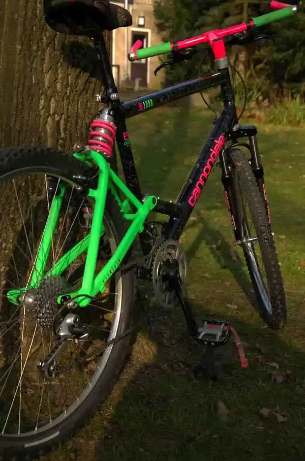

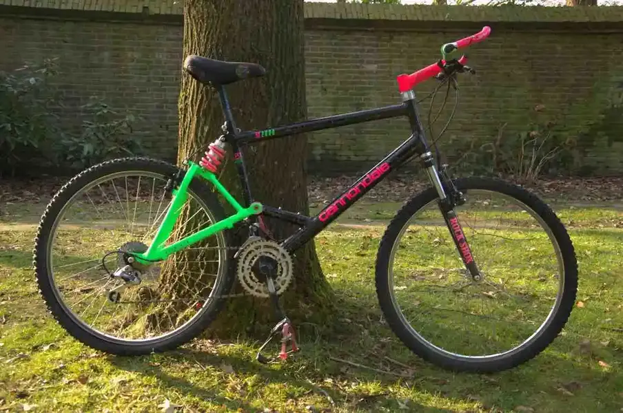

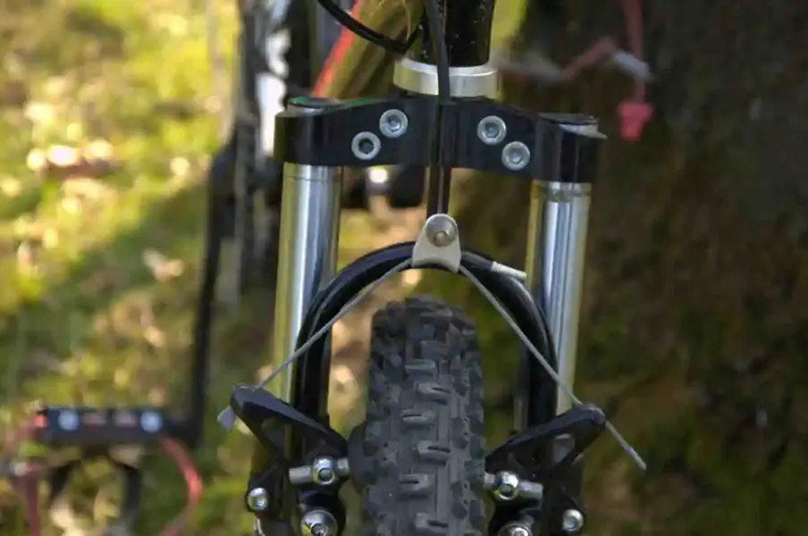

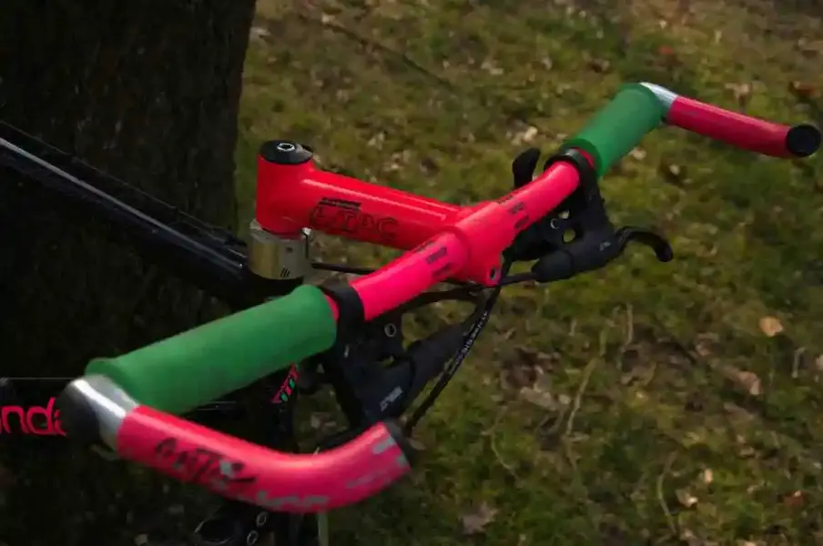

Today I took the SE2000 out on its maiden voyage. I covered 20 miles and enjoyed every one; I really like the bouncy Cannondale. There were times it felt a little sketchy and that was mainly on the road and that could be because of the tyres (which really didn't suit conditions); overall impression is that its a far better ride that expected and as a result I plan to take it out more.
Final spec is as photos however I'll be changing the post for a silver Ritchey one.
Frame: EST Suspension 21"
Fork: Pepperoni
Headset: Ritchey Logic
Stem: Flexstem
Bars: Hyperlite
Grips: Tioga Biogrip
Brakes: Cannondale Force 40 Dia Compe 987
Brake Blocks: Dia Compe
Brake Cables: Shimano XT
Shifters/Levers: Shimano XT M092 STI SLR
Front Derailleur: Shimano XT
Rear Derailleur: Shimano XT
Gear Cables: Shimano XT
Cassette: Sachs
Chain: Shimano HG90
Cranks: Shimano XT M730
Crank Bolts: SRP
Chainrings: Shimano SG
Chainring Bolts: Sugino & SRP
Bottom Bracket: Shimano XT
Pedals: Shimano M525
Hub Skewers: Ringle
Rims: Mavic M231 CD
Hubs: Ringle
Tyres: Panaracer Duster Pro 1.95
Tubes: Michelin

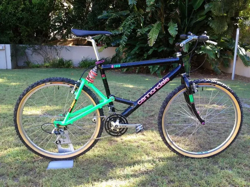

I got Myself a SE 2000 as well
I got Myself a SE 2000 as well, what a spectacular bike!
