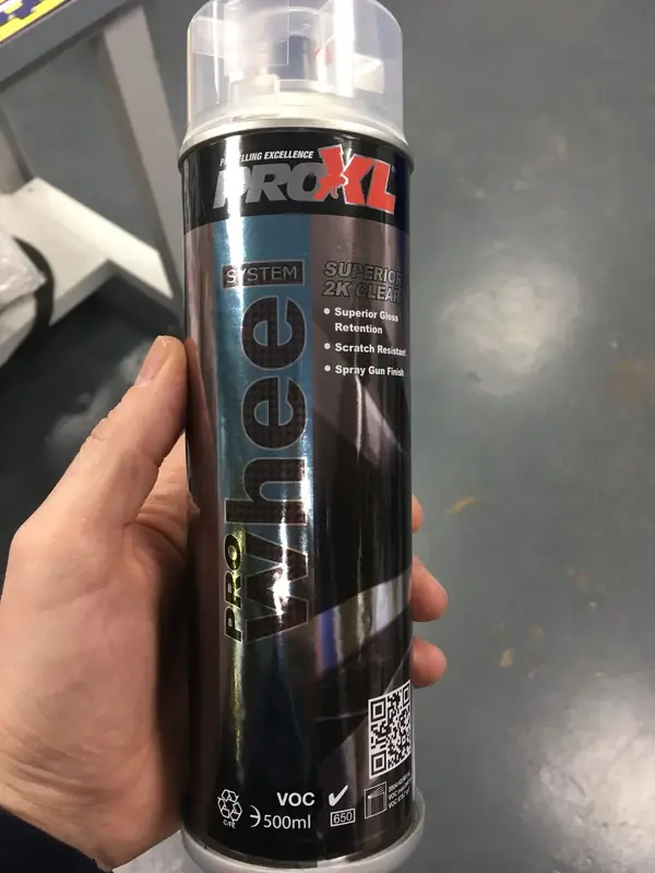

That looks a great finish. I can’t tell if you’ve lacquered it but if you haven’t and you want to, I’ve used this on a Team Telekom replica I did and I’m impressed with how it went on and how hard the finish is. It’s basically ‘2-pac’ in a can. FA8D1E60-8EC6-462F-A6A8-CD315CB80CDB.webp

That looks a great finish. I can’t tell if you’ve lacquered it but if you haven’t and you want to, I’ve used this on a Team Telekom replica I did and I’m impressed with how it went on and how hard the finish is. It’s basically ‘2-pac’ in a can. View attachment 544892
Some lacqueres can cause 'bubbling'. Lacquer contains a lot of solvents that have to evaporate. Some have more potent solvent content than others - it is not a curing process like varnish. If the surface hardens before the lower layer finishes evaporation, you get bubbles. You get more bubbling in hot weather.
I used Montana's own varnish spray to keep it synchronized but thanks for that. Graff city also do a good 2-pac lacquer.
Yes there is definitely a technique to avoid bubbling or ‘orange peel’. I was lucky that I had use of a spray booth to do mine.
