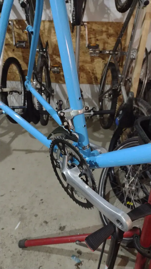

Since I didn't want to polish the cranks to a high gloss, I simply cleaned them of all grease with chain cleaner,
then sanded them with 600 and 1000 grit sandpaper and finally polished them with metal polish.
They are now satin to slightly shiny and still have some scratches. But in my opinion, that fits in with the overall picture.

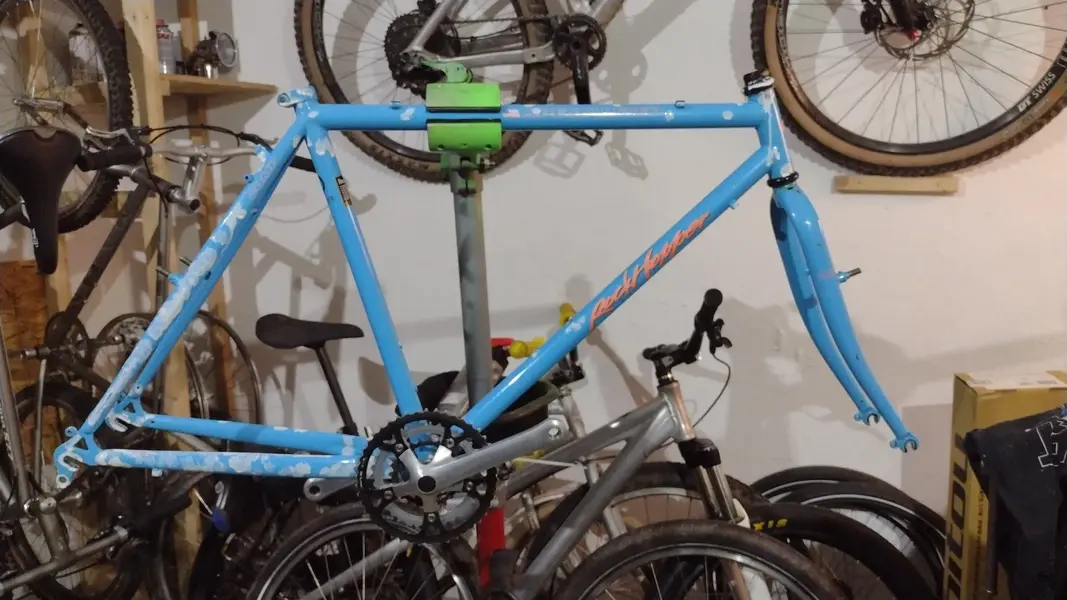

Today it finally continues. The first thing I noticed was that I have to do the rust treatment again because I haven't achieved the desired effect yet.

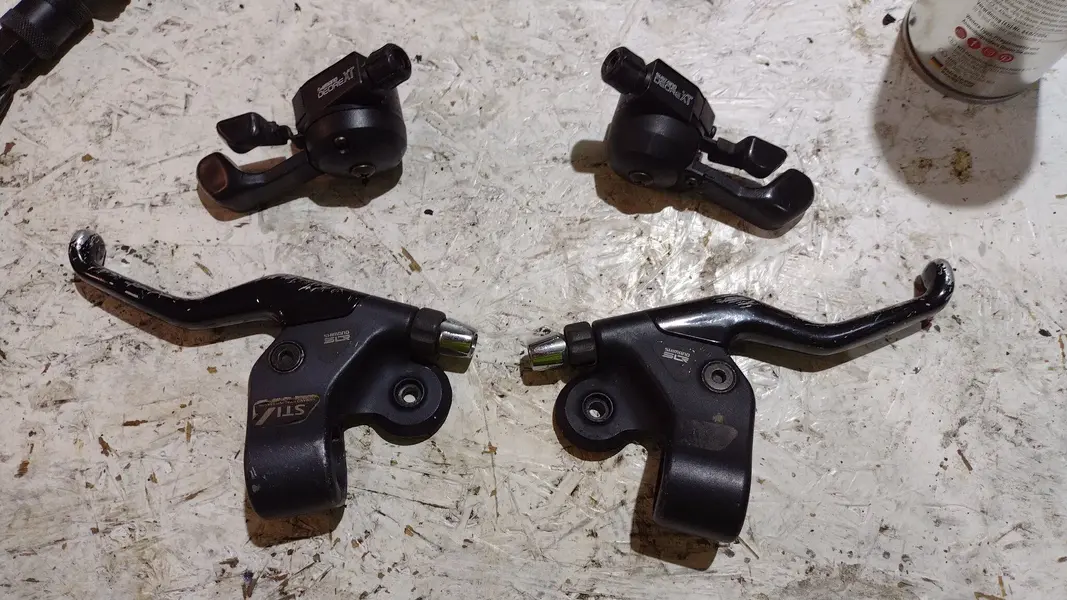

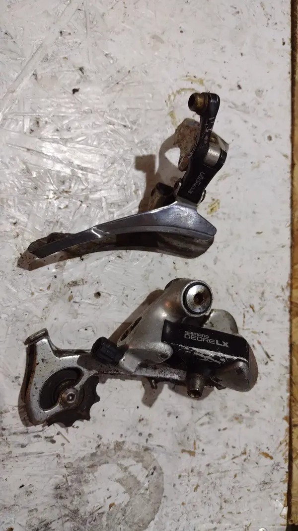

Then I'm going to work on the rear derailleur and the front derailleur.

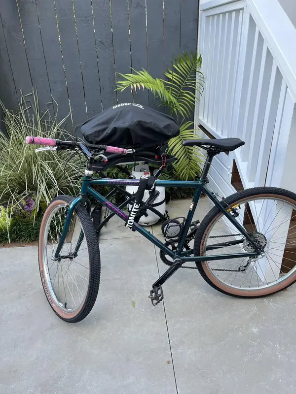

Inspiring work, thank you. I just got this rockhopper and have done a light clean and polish in the way you recommended. It has come up looking great with the Billy Bonkers on too.
Next step - the handlebars. Thanks for the tips.

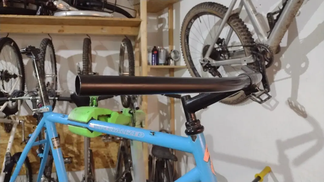

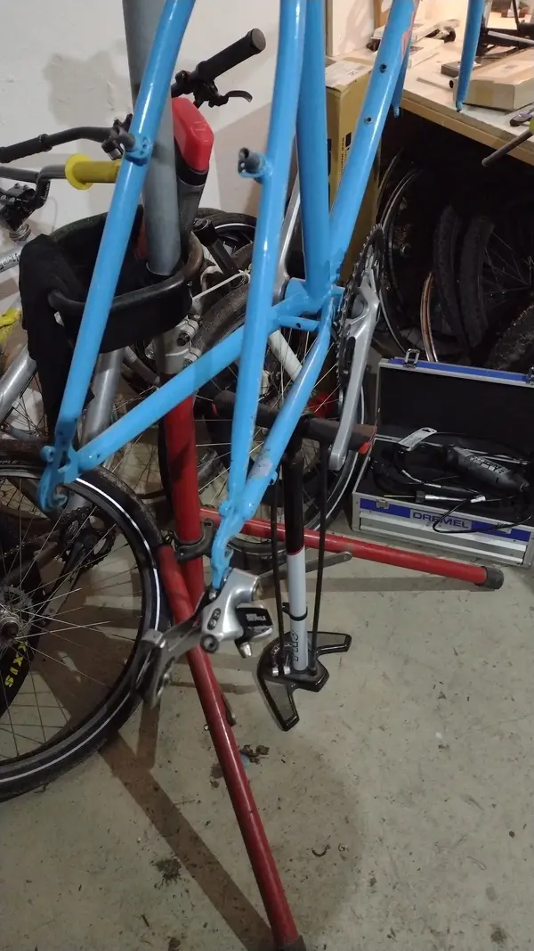

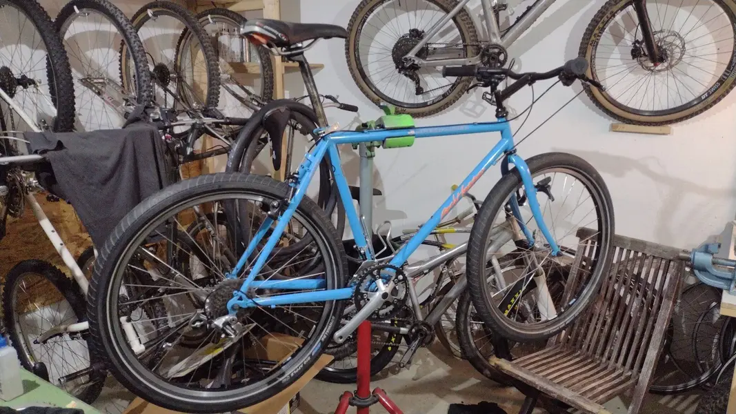

It's starting to look like a bicycle again.

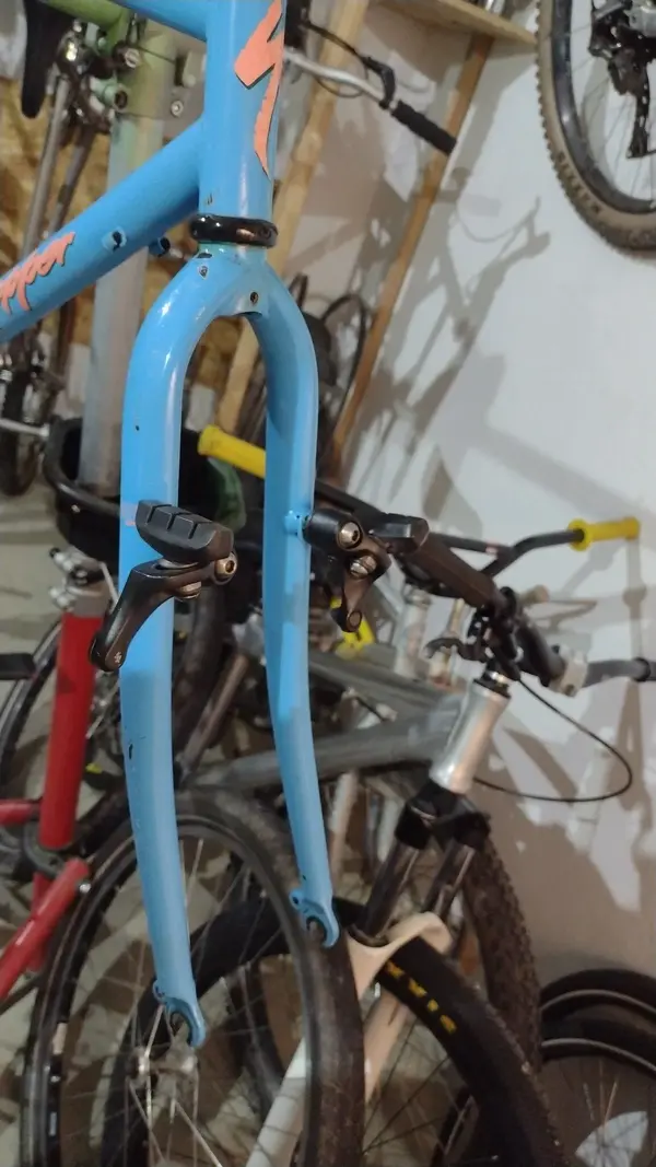

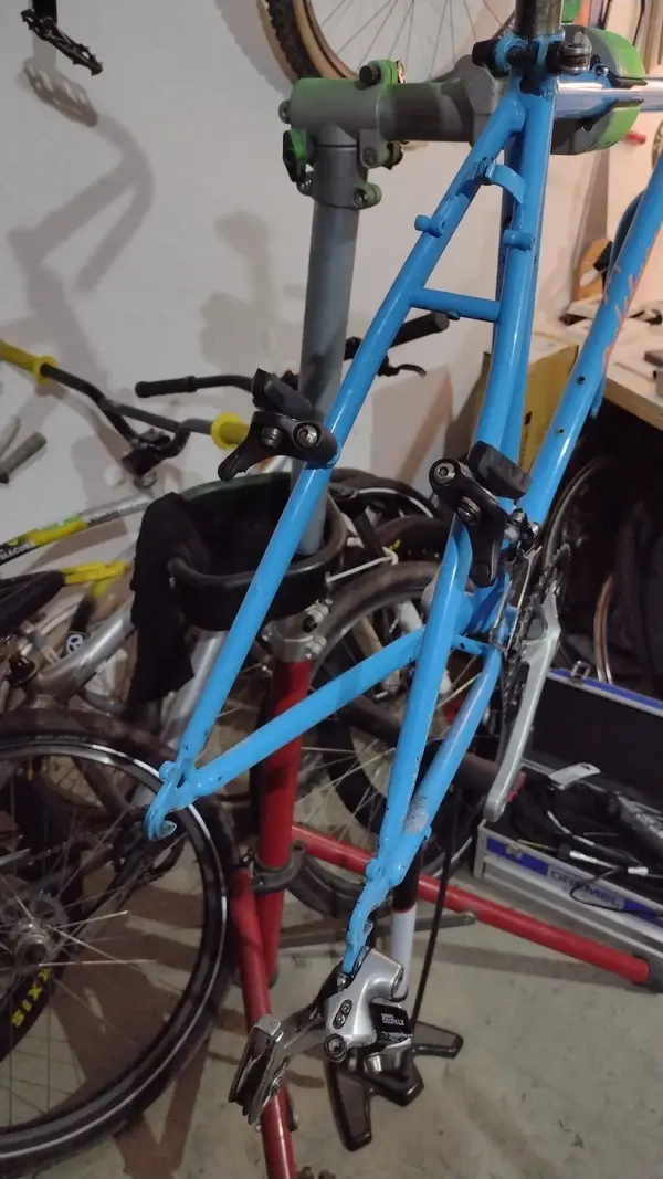

The wheels are freshly centred, bearings greased and everything runs smoothly again. The rear brake was more difficult to adjust than I thought, but now I'm happy with it. Now the rest of the wiring gets done and then she's ready.
