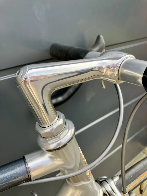

Then I gave the newly purchased stem a once over. These are amazing pieces of art...

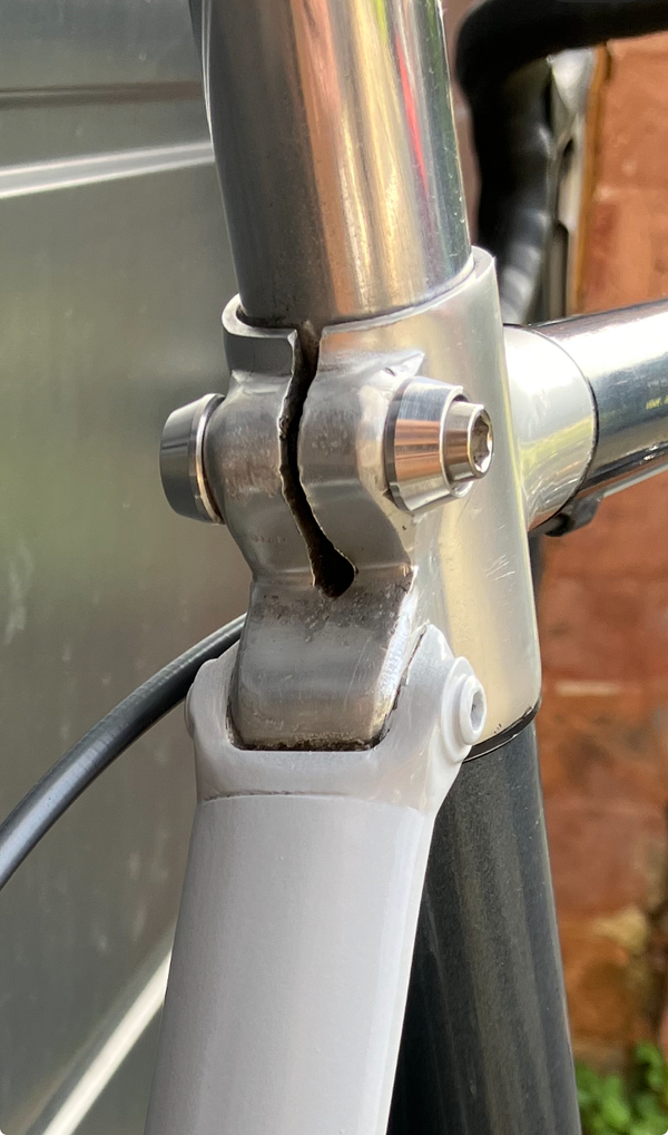

Before I got heavily involved with the frame and forks, which will always take centre stage in terms of sheer time and effort to bring back to standard, I investigated the seat bolt arrangement. Raleigh saw fit to whack a chromed steel affair in their alloy lug, and bond it in there with some sort of glue. Not only was the original part really shabby in terms of finish, it was always pretty messed up with rust, not forgetting that it was bonded into the lug. Once the seat bolt was removed I could take some accurate measurements and pass them on to Dan Chambers (Danson on here) and see if he could make an aluminium copy for me. I'd been waiting on Dan to take receipt of his new lathe, and this was one of the first jobs he put through it. If you've had the pleasure of dealing with Dan, then you'll understand what a great bloke he is, and I would recommend his skills should you need them. Here's the replacement along with a Titanium bolt...

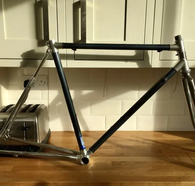

After much consultation on the best way to approach the frame, I decided on maintaining the original paint on the main tubes, retaining the original anodising on the lug work, but fully repainting the steel work in its original colour. The difficulty in managing this part of the project is because the steel work is so badly rusted, and it literally runs into the alloy lugs, so stripping the paint will be a real challenge. I went to see several people about the best way to remove the old paint and rust, and they all gave the same advice; use P80 sandpaper by hand and don't stop rubbing until every little bit of rust is gone. Any other mechanical means is too aggressive, or won't be effective at getting into the detail of removing the rust pitting precisely. At first I started by hand, then I came across the little P80 Dremel sanding wheels. These were perfect for the job, and could be applied with the just the right amount of pressure, so as not to damage alloy lug work, or the steel itself. Let me tell you though, it doesn't save much time - it takes forever to get the finish back to bare smooth metal, with zero rust pitting. Here are the forks so far...

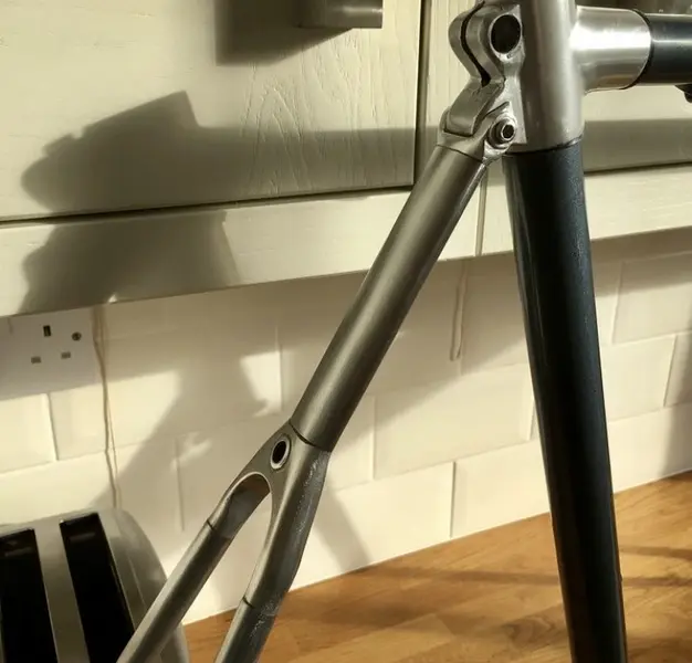

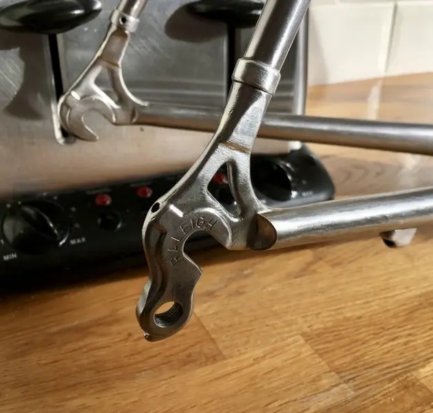

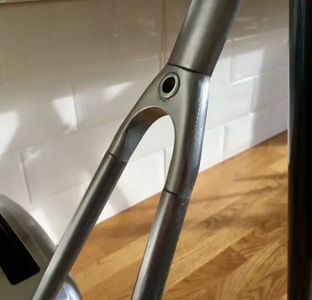

The complicated wishbone. Alloy, steel, alloy, steel, etc...
I'll keep going with the rear forks and post up some pics before the paint process. The main tubes came up pretty good with some very fine emery paper to remove the rattle can black paint, and then some Meguires Polish to buff up the old paint and lacquer afterwards. The original decals have been removed and measured up, as I'll be getting those made up again, although with a slight twist as the original ones were awful, and always looked dated for such a progressive design. I won't stray too far from the original concept though.
The main 3 frame tubes are Reynolds 3 2.5 Titanium. These tubes are bonded into alloy lugs. The front forks are Reynolds 753 steel, as are the rear chainstays. The rear seat stays are a mixture of 753 steel bonded to alloy brake bridge and alloy bolt carrier for the attachment to the seat tube clamp. All pretty complicated when you try and explain it!
So, the steelwork is free from paint and rust now, but it's cost a Dremel and a load of accessories to get there. I had to get pretty inventive with variations of sanding discs sandwiched with cardboard in order to get the paint removed around the seat stays without damaging the surrounding areas.
It all goes to the sprayer tomorrow, and I've just been to collect the paint I chose. I was stuck with the paint for quite a while as there are no records available on what colour Raleigh used. The other issue was that my original paint had faded, and become so badly tarnished with surface rust that it wasn't entirely clear what colour it even was. My memory is backed up by literature, which states the paint was simply light grey. The paint on this frame looked white, but that had been a victim of weathering. Trying to maintain the original colours, and vaguely British, I opted for a current Jaguar/Land Rover colour - Yulong White, which is actually light grey.

The three main tubes aren't short of their scratches, but for the most part, they're good enough. It's good to retain a small degree of patina and honesty with the bike too.

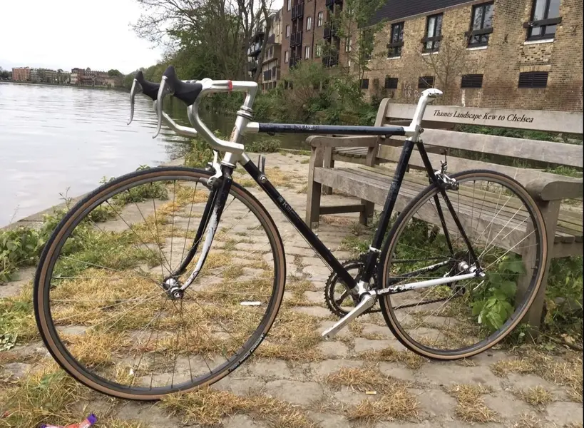

A quick turnaround on the frame and forks meant I collected it today. I'm really pleased with my choice of paint, as the balance in colour is just right.
I had a little bit of time to prepare and fit some components. Remember that these are mostly the components that I bought the bike with, so they will be slightly more worn looking in places than I would have chosen if I'd been building from scratch.

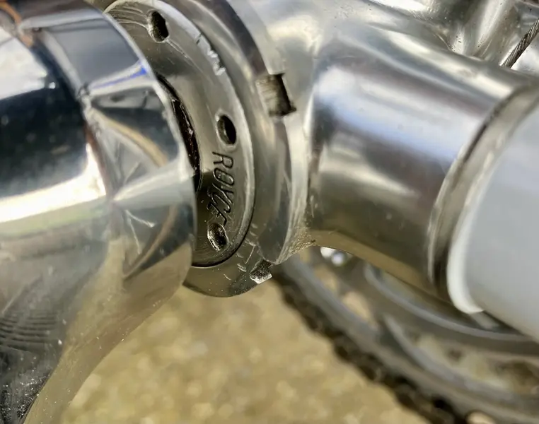

I'll put the Dura Ace bottom bracket away in my spares, as it's a bit rough on one side, and really it needs another axle as there’s too much wear. I have a plan to use a Titanium axle anyway. I bought a 113mm floating Titanium axle a few months back; it's actually a McMahon one, which will be perfect for what I need. The original Shimano axle was a few mm off centre to accommodate the chainring side. Most of the available Titanium BB's use a central collar which always places the axle in the middle (and stops it from moving around), but with a floating axle you get to choose the chainline (but you still need something to hold it in place, hence the locking collars). So, here's the list of bits I've gathered from different sources, with which I'll make my own BB with.
It's Royce cups and bearings, McMahon axle, and Action Tec collars to position the axle exactly where I want it to sit. It’s a lovely thing, and about as fitting as I could get for a British bike.

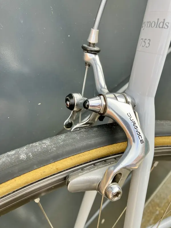

Headset was put back in place, and it's impressively smooth. Next up were the brakes. They were seized on one side, and covered in a lot of black paint underneath, so took quite a bit of time to get in a condition I thought was acceptable.
