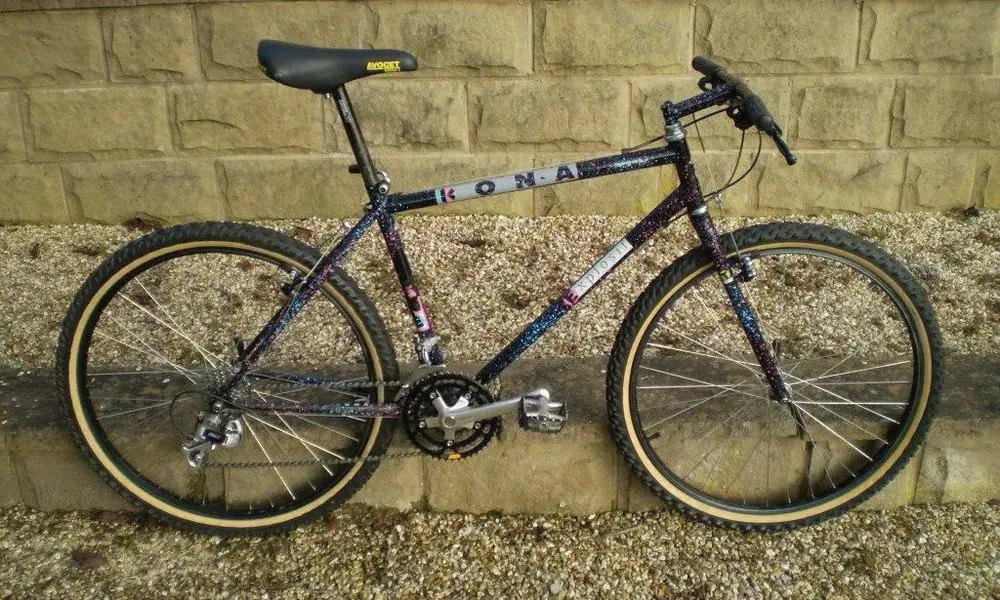

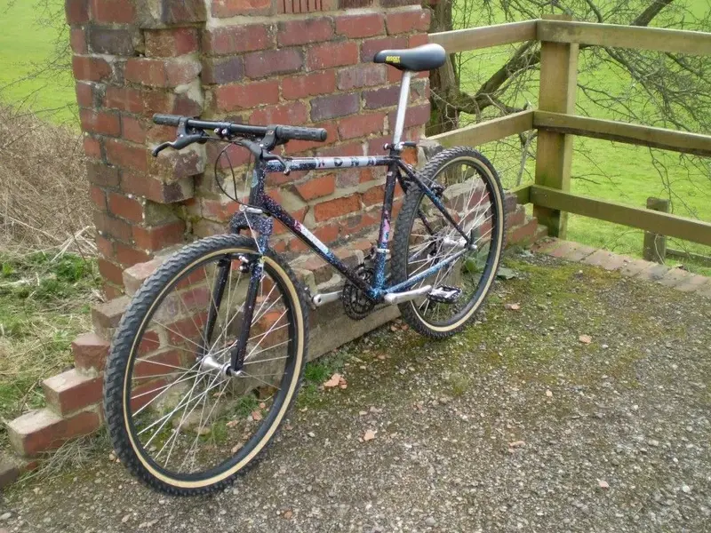

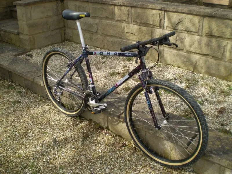

1990 Kona Explosif

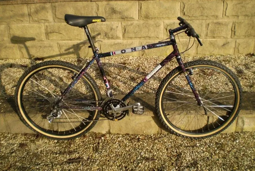

Finished, for now at least :)
Not quite as i originaly wanted but happy enough, and it will get ridden this way, not just stood and dusted now and again :) always room for improvement along the way with a couple more black xt components if and when i find them.
For now a few pics, sorry for the poor camera, am looking at getting/borrowing a better one soon.
Mark
Frame: 1990 Kona Explosif Tange Prestige
Fork: Track Two
Headset: Hatta Swan
Stem: Velocity
Handlebar: Tioga Tange Prestige
Grips: Tioga
Barends: No
Brakes: Shimano XT
Brake Pads: Shimano XT
Brake Cables: Yes
Cantilever cable hangers: Shimano
Brake Levers: Shimano XT
Shifters: Shimano XT
Front Derailleur: Shimano XT
Rear Derailleur: Shimano XT
Derailleur Cables: Yes
Cassette: Shimano
Chain: Shimano
Cranks: Shimano XT
Crank Bolts: Shimano
Chainrings: Shimano
Chainring bolts: Shimano
Bottom Bracket: Shimano XT
Pedals: Shimano XT
Hub Skewers: Shimano XT
Rims: Araya
Hubs: Shimano XT
Nipples: Yes
Spokes: Yes
Tyres: Tioga Farmer Johns
Tubes: Yes
Saddle: Avocet Racing 2
Seatpost: Shimano XT
Seatpost Binder: Shimano XT
Weight: Long P1010691 (Medium) - Copy.webp P1010679 (Medium) - Copy.webp P1010690 (Medium) - Copy.webp
Re: 1990 Kona Explosif - (finished) -
I like that ....A LOT
Gonna have a proper look later on a bigger screen than a poxy iPhone
Can’t go wrong with black XT
Thanks mate. Probably better on the smaller screen, hides my poor photo skills and cheap camera better :lol:

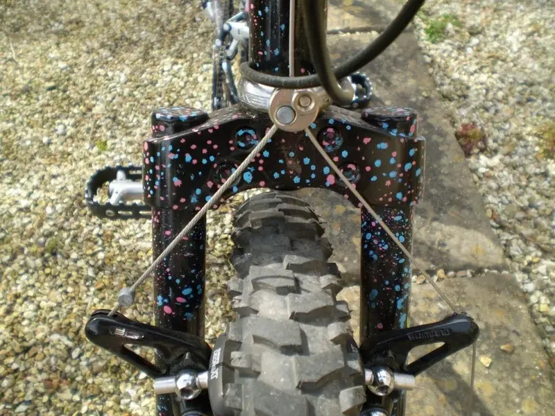

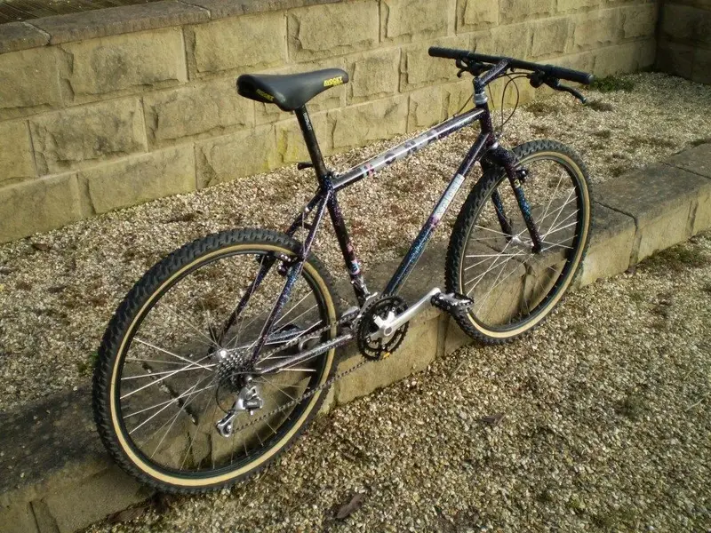

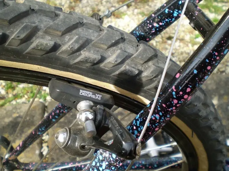

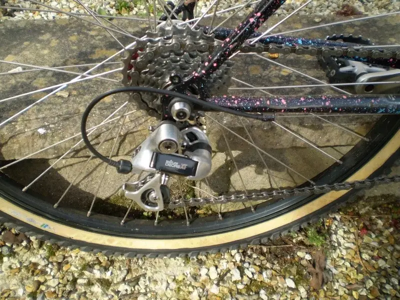

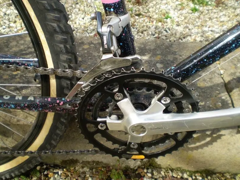

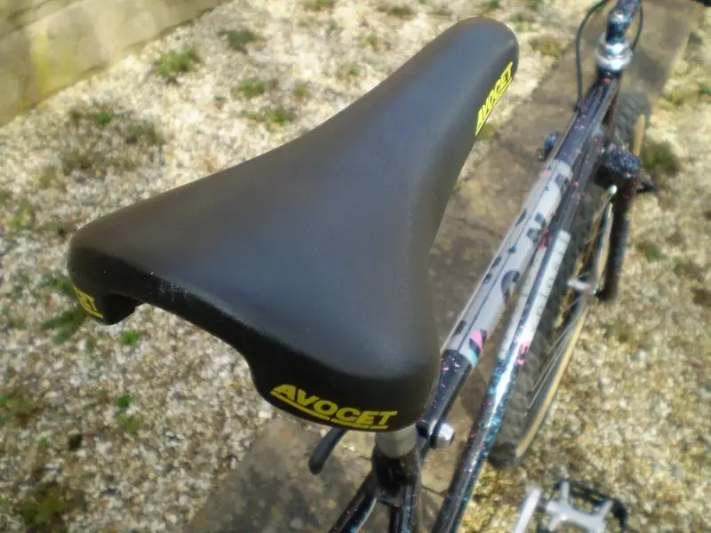

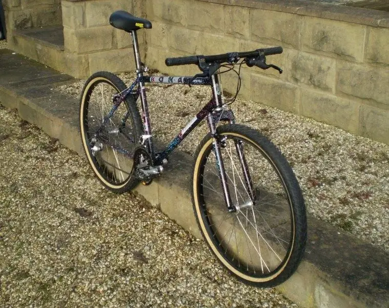

A few more after the sun went in, it didnt stay out long :LOL:
Mark P1010681 (Medium).webp P1010695 (Medium).webp P1010687 (Medium).webp P1010688 (Medium).webp P1010685 (Medium).webp
Finally got out for a ride on it :cool:
After a quick shakedown ride and a few adjustments/tweaks, i took the Explosif for a ride along the railway path. Not technical in the slightest but gave me a feel for the bike, the ride postion and the basic handling characteristics.
I was suprised at how good the new XT pads were, have used other brands for a while and if Shimano ones they are usually worn. These worked very well, which was good as the first thing i ride is a steeeep hill to a sharp chicane at the bottom :shock:
When on the track the first thing i noticed was how direct the power to the wheel is, i am used to a bit of flex, which i dont mind but this was not flexy at all. Which was strange in that the ride was still smooth and not harsh in any way. Would make a good race bike, which is what it was designed for i suppose :LOL: went up a couple of hills too and up out of the saddle it just climbs so well, no flex there either, even stood up and in a stupid wrong gear. Really like the frame, and compared to the more modern Orange Prestige i am riding at the moment, it is just way nicer.
Right, thats the frame out the way, now the fork :shock: well, its certainly rigid :LOL: which makes it direct but, its rigid, which makes it harsh, (did i mention it was rigid?) over everything! this frame i feel would be much more suited to a project two and then for me, it would be hard to fault. Only had the one ride on this but i like it as much as the '93 Kilauea which is praise indeed. Totally different rides but both make me smile and both feel real :cool:
