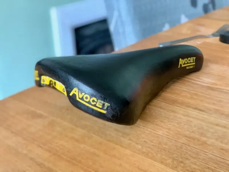

I still need to restore the original Avocet R1 saddle and source some more original tyres. The 'foam' grips are ready to go but are a pain to get on and off, so I've swapped in some modern ones while getting stuff all dialled in.

I've spent a bit of time on the original saddle today.
